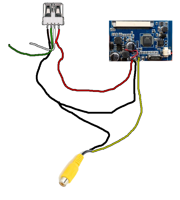

In case it boots, and you still have no screen lit up, please connect a stripped usb cable to the + and - of the screen and connect a RCA source to the screen (for instance a dvd player, or camera or anything that has a yellow tulip output) if the screen lits up after this you can confirm that the screen itself is o.k and that there's a problem between the pi and screen.

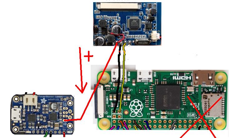

You should just connect the screen to the powerboost, --> http://imgur.com/a/L6rdM ,or another 5v source, NOT soldered onto the PI (only the video wires offcourse :roll: ..)

I did the image you made for me here:
And also the one you described here wiring into the USB and plugged into my phone charger.
None worked :-( I think my screen is toast...
