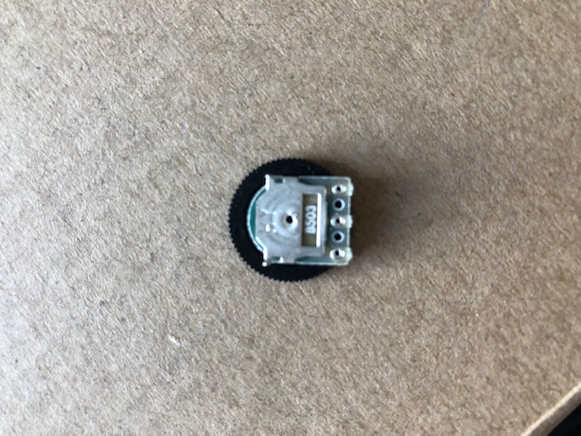

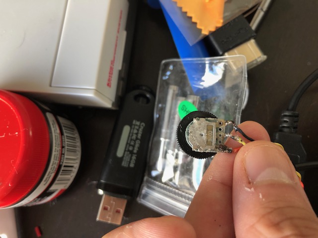

thanks infinitloop for the quick reply, i have not test it like that and i will do that today sounds good. one thing i did notice now that you mentioned it the potentiometer at one point started gettting really hot, to the point that it melted the glue that was holding it in place, and while this was happening at full volume the speaker made noise at top volume but i shut it off scared something was burning.

b103 potentiometer rated for 10k ohm i also have a b503 rated for 50k ohm but have not test it i dont know if the dial matters :(

the pots can get fairly hot without destroying them, i think. they are just resistors, so as long as it's still in one piece, it's probably ok. if you want to keep it in there, use the 103 / 10k one. but, if you want to make sure it's not the issue, just run a wire between the two not-ground audio pads on the board, and that should route the signal straight through to the headphone jack.

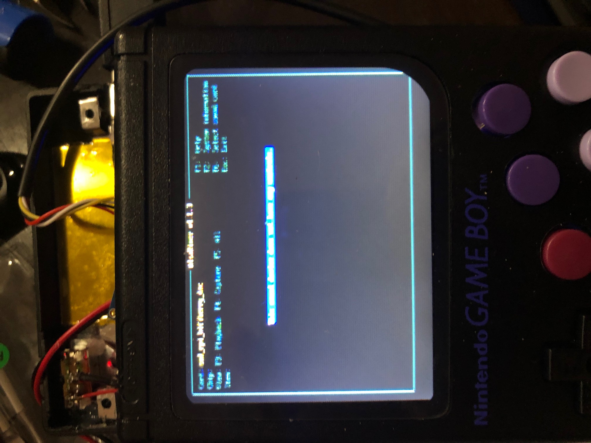

tried it all and nothing works am so demoralised two boards and nothing, i have a third one from glitch gaming i just got havent test it but am sure something is messed up i wanted to give my nephew one for his birthday but couldnt finish it on time here am so mad the pics of what i get on the glitcho board

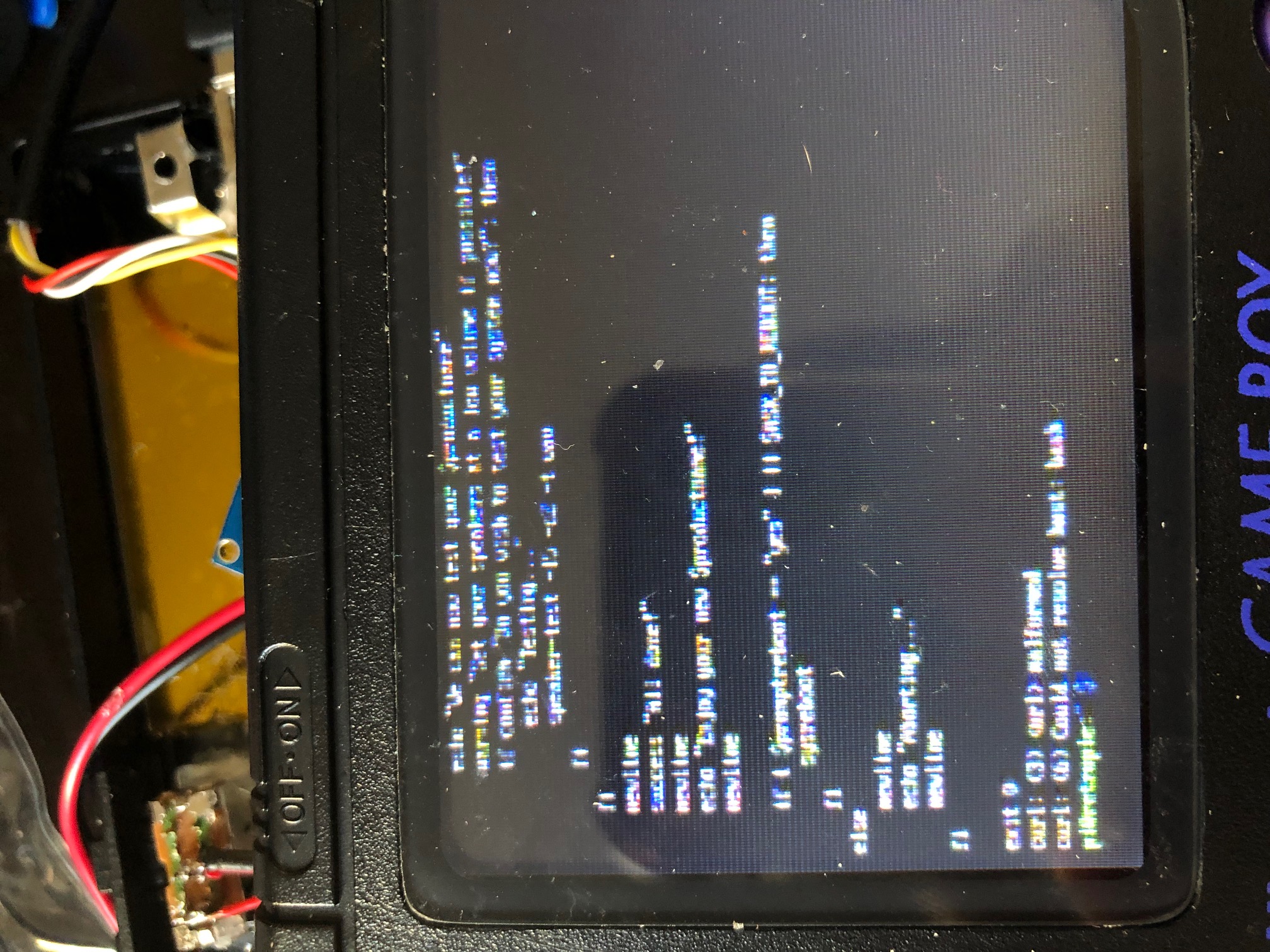

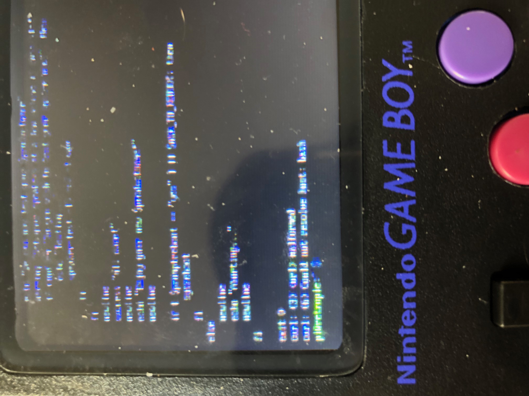

Post by SageALL » Tue Apr 16, 2019 4:03 pm
as you can see when i tun the script it doesn asked me anyhing it just repeats the code on the pi

Post by infinitLoop » Tue Apr 16, 2019 4:44 pm
well, first - the tinkerboy aio board uses usb and the glitch'd uses i2s, so they aren't compatible for the audio setup, if that's what you're trying.
it's hard to make out what's happening in those screenshots, but it kind of looks like there are bad characters or something in the config files. when you make changes to the files, how are you doing that? if you are on windows, using notepad (or, god forbid, wordpad), then you are likely messing up the format. linux uses different character sets for things, so it can confuse it. download something like notepad+ or notepad2 that supports more formats
maybe you need a "sudo" in there before the bash...
curl -sS https://raw.githubusercontent.com/adafruit/Raspberry-Pi-Installer-Scripts/master/i2samp.sh | sudo bash
