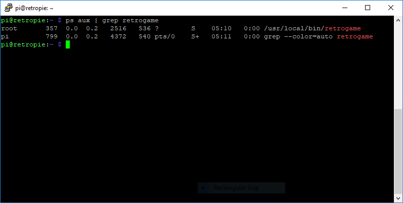

Check if the retrogame program is running by entering:
ps aux | grep retrogame
You should get something like this:

so this it what i have numbers are just different from yours https://photos.app.goo.gl/BfRwCQK9XhPh3ZRy8

ToyRoBoHoBo wrote:
Wed Feb 06, 2019 8:26 pm
That means retrogame is running just fine.
You should be able to configure your button inputs from RetroPie menu. Otherwise, try testing a button manually. Get a wire and touch one end to a GND and the other end to the GPIO5 pin on the Pi. You should get a response when you configure your input from RetroPie.
