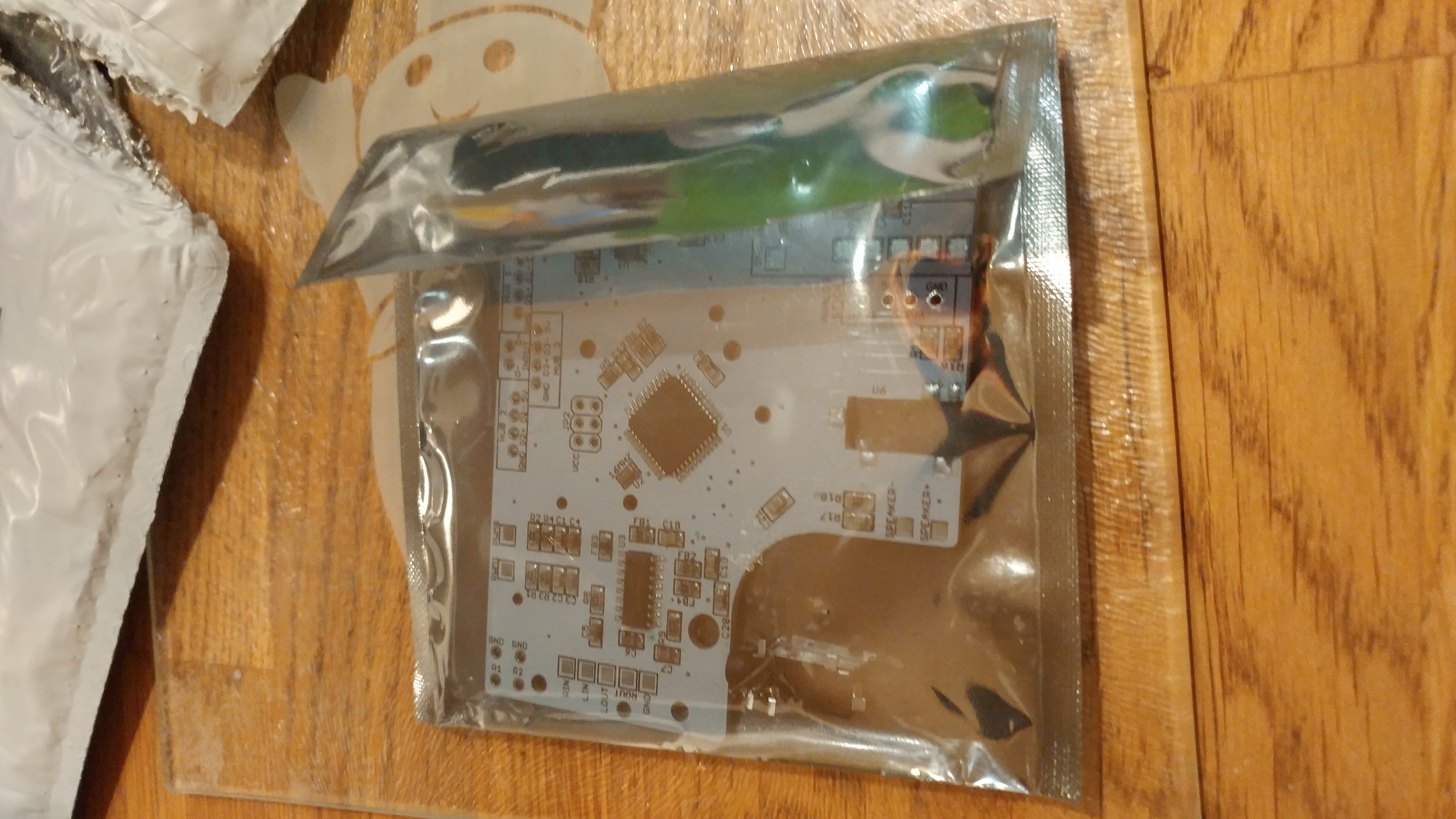

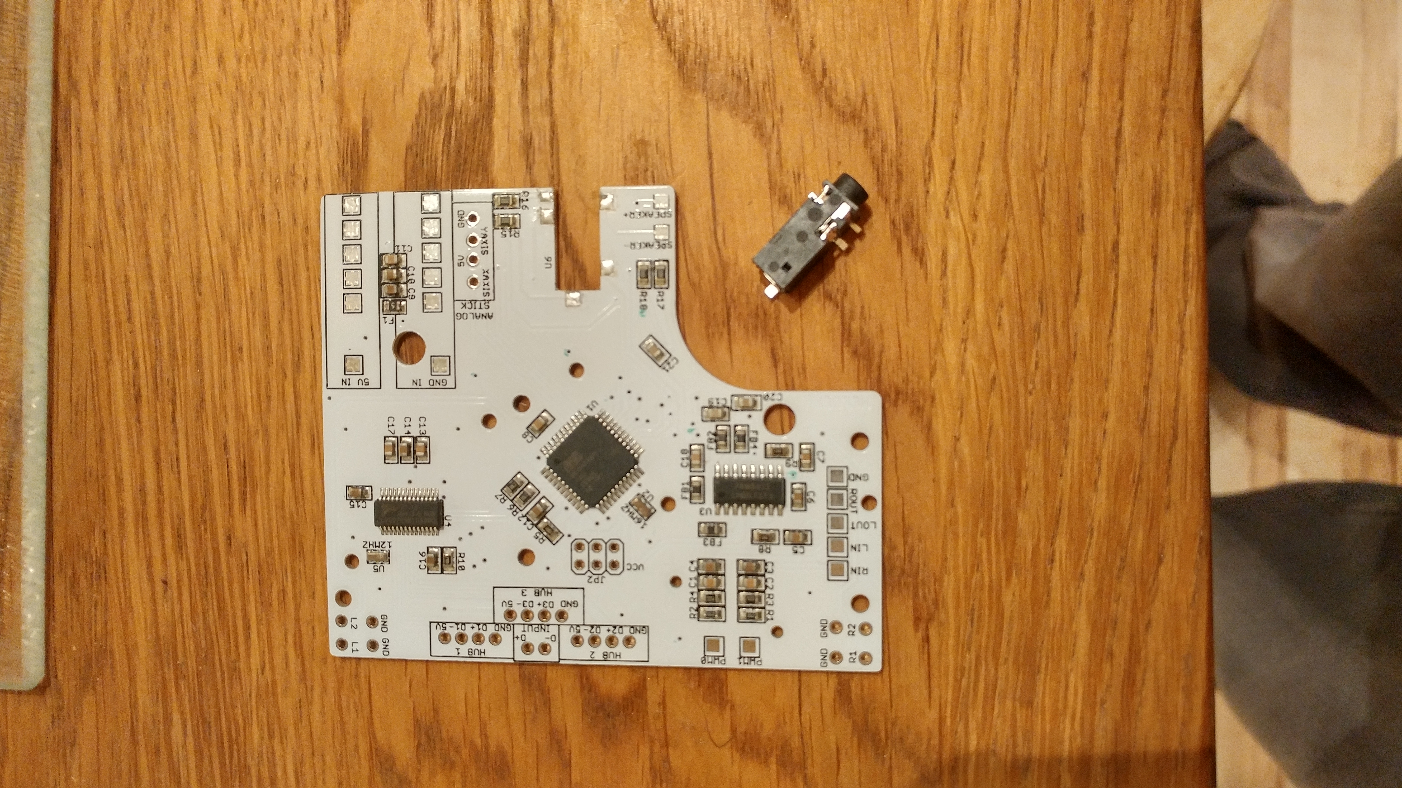

SumCanadianGuy
Posts: 107
Joined: Mon Oct 03, 2016 11:37 am
Has thanked: 51 times
Been thanked: 19 times
Post by SumCanadianGuy » Tue Nov 29, 2016 7:53 am
Just got my board in the mail. Seems to have been handled in typical Postal Service fashion but no pads were lifted so I should be able to just solder it right back on. Excited to get this project going but I am still waiting on my case, screen, volume wheel and buttons.

SumCanadianGuy wrote:Just got my board in the mail. Seems to have been handled in typical Postal Service fashion but no pads were lifted so I should be able to just solder it right back on. Excited to get this project going but I am still waiting on my case, screen, volume wheel and buttons.
The headphone jack is meant to be separate you solder it on yourself
No it's not a few have had broken/lifted pads from the bad handling of the postal service, luckily mine made it all the way to the uk in perfect condition with the headphone socket attached :D
