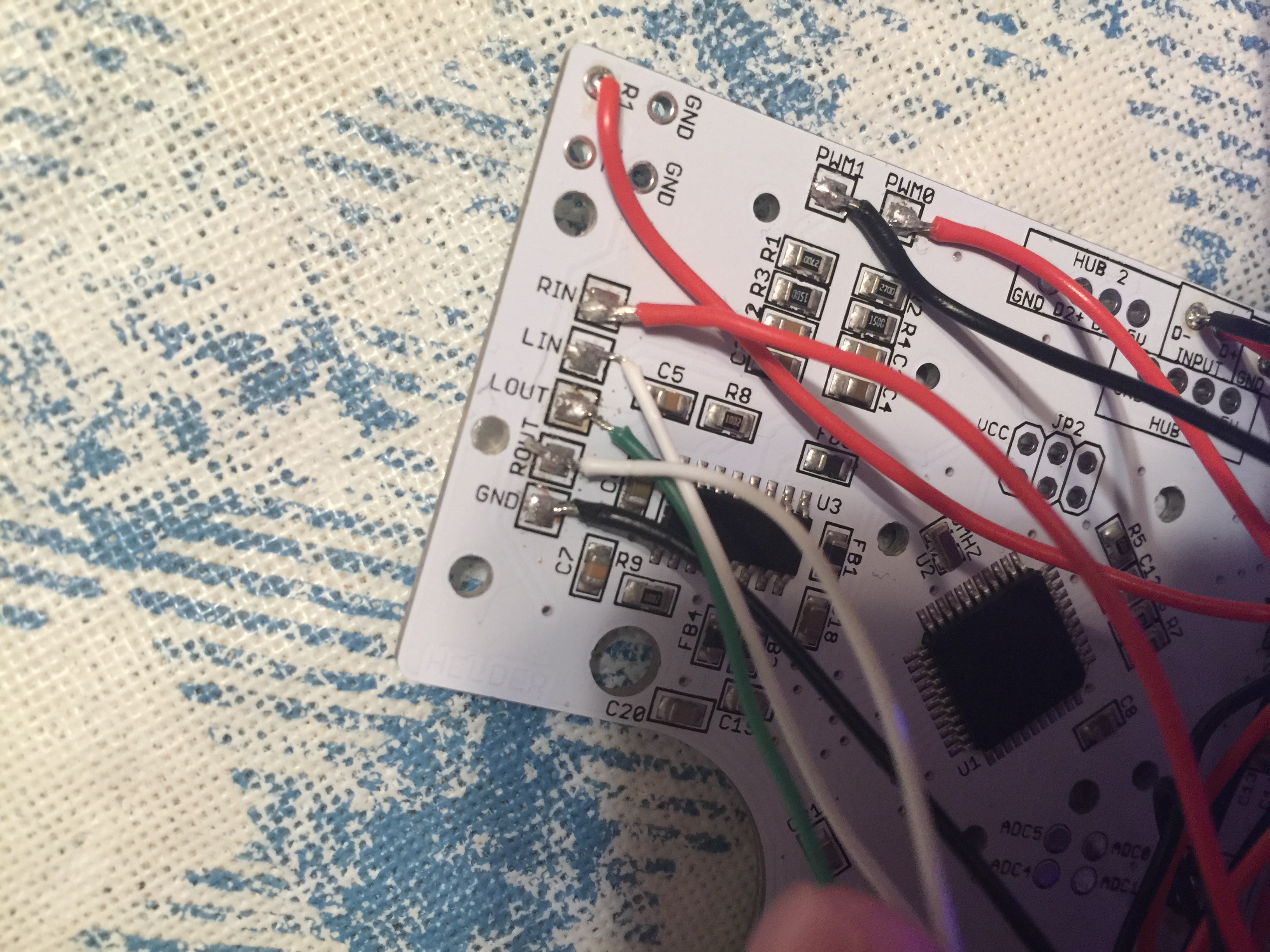

Hey @Helder I'm working on putting my system together, but my speaker just ticks and doesn't play any sound, I saw early someone had a problem with C7 I touched. My finger to it and heard a faint ticking of music, I heated the joints and while the iron was on it it played perfect, I took a wire and jumped it to a ground and the speaker sounded amazing. But when I plugged my headphones in my left earbud was extremely hot and so was the board. Do you have any idea how to fix this? The headphones work either way but without it jumped are distorted. I'm open to anything to fix.
Spoke too soon @helder. Wired the busted pads to the areas you have indicated still no sound. I also edited my boot configuration file too.
Helder wrote:enemone wrote:enemone wrote:@helder I unfortunately stripped 2 pads from the channel inputs on the volume wheel pads on the board, and I also stripped the positive pad for the speaker. Do you know of any way that I can regain sound?
Here you go, all alternate points for the audio circuit.
@helder,
The wiring reroute worked! The problem ended up being a dead speaker. Thanks for your help with the board I damaged! My system is up and running!

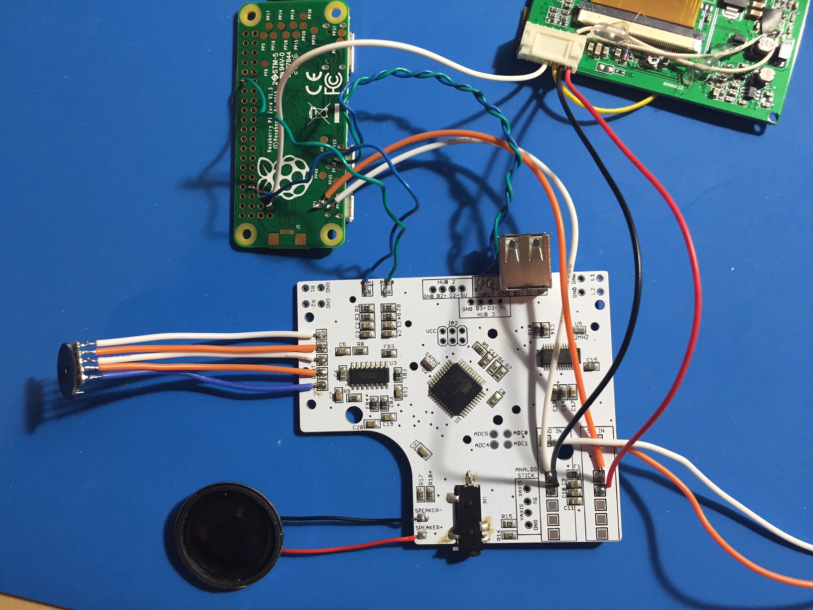

could you show me a few pictures of the wiring and some clear images of the audio amp area where c7 is? I wonder if there is something shorted else where.Xorfora wrote:Hey @Helder I'm working on putting my system together, but my speaker just ticks and doesn't play any sound, I saw early someone had a problem with C7 I touched. My finger to it and heard a faint ticking of music, I heated the joints and while the iron was on it it played perfect, I took a wire and jumped it to a ground and the speaker sounded amazing. But when I plugged my headphones in my left earbud was extremely hot and so was the board. Do you have any idea how to fix this? The headphones work either way but without it jumped are distorted. I'm open to anything to fix.
Helder wrote:could you show me a few pictures of the wiring and some clear images of the audio amp area where c7 is? I wonder if there is something shorted else where.Xorfora wrote:Hey @Helder I'm working on putting my system together, but my speaker just ticks and doesn't play any sound, I saw early someone had a problem with C7 I touched. My finger to it and heard a faint ticking of music, I heated the joints and while the iron was on it it played perfect, I took a wire and jumped it to a ground and the speaker sounded amazing. But when I plugged my headphones in my left earbud was extremely hot and so was the board. Do you have any idea how to fix this? The headphones work either way but without it jumped are distorted. I'm open to anything to fix.
I'm uploading this from my phone hope this comes through well. I feel like it's a grounding issue I've took a wire and jumped the various points of the alternate audio joints and nothing helps. I've even tried a different speaker.

Now my sound out of my main speaker is acceptable in volume and in quality. However I still want to figure out why my main speaker does not work in stereo mode. Does anyone have any ideas? Here is a picture of my wiring.
The last post only helped the choppy sounds actually include some music but still extremely choppy again when I press on c7 it starts playing again but this time I had it playing very well then it got really choppy again.. is there somewhere I can jump c7 to, to test or bridge the circuit in case it's broken or something? I believe this would fix the issue I'm having.
