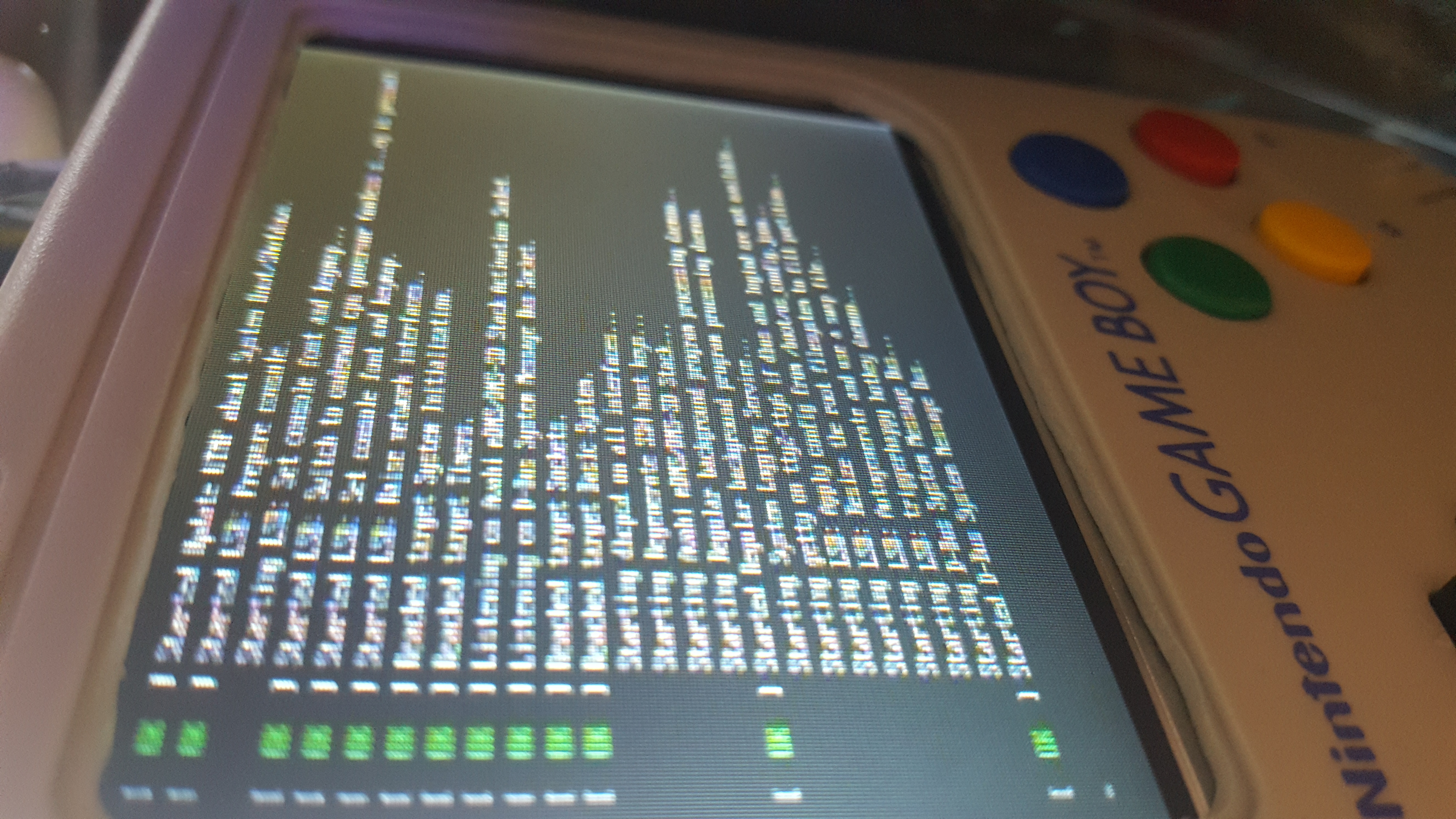

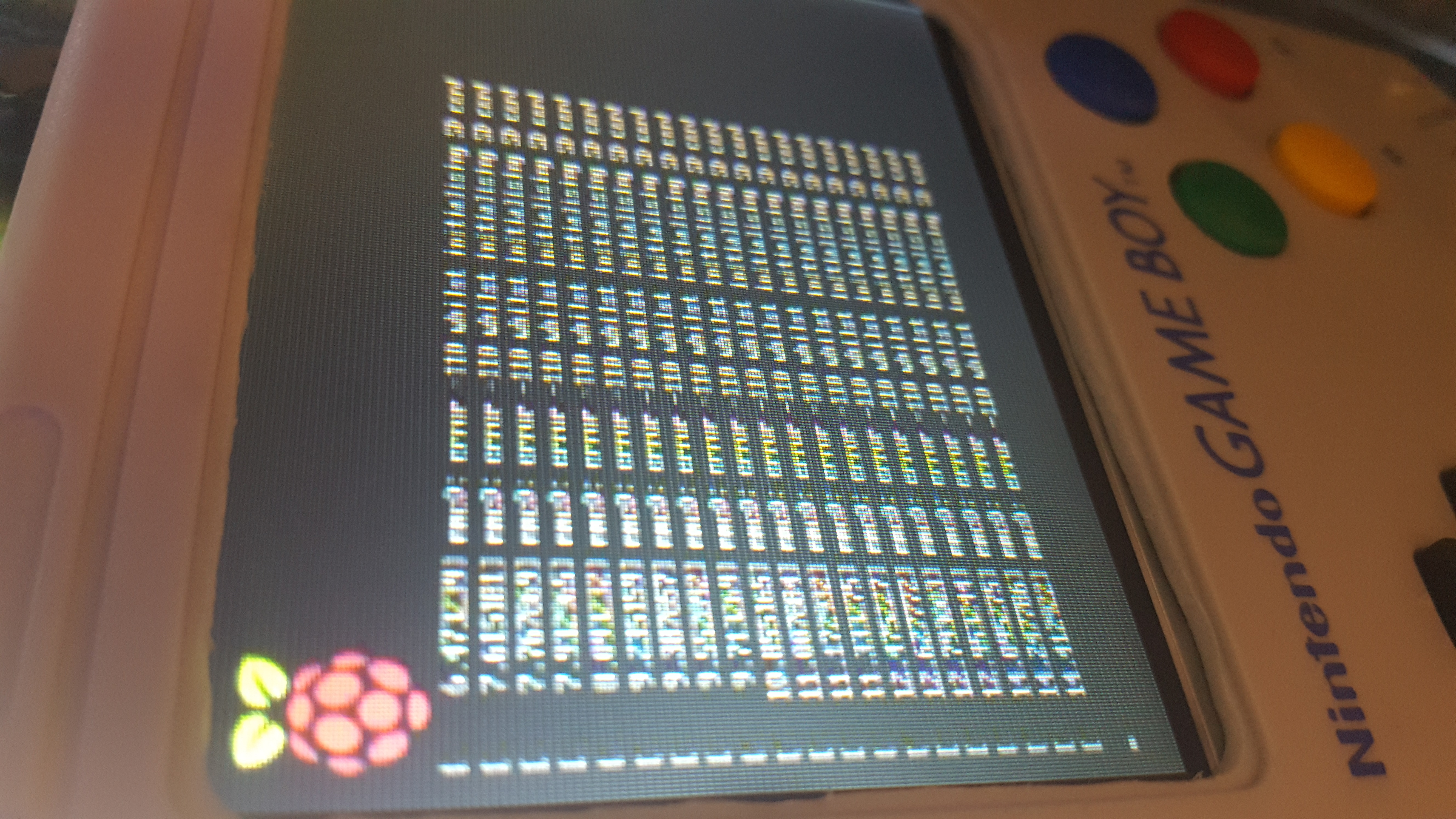

Hi guys, first I apologize my translated english!
I got my All in One Board from Helder on Tuesday, everything wired and I am now 2 days on the error search. I almost despair.
I have 3 SanDisk Ultra Class 10 MicroSD cards with 32GB to Test with The Raspberry Pi Zero 1.3. At 2 I get the error as seen in the picture and with the other the Pi boots to a certain point and then breaks off, as it issues error messages.
I hope someone can tell me what the whole thing can be related.
I have all testpads connected to the Nintendo DS Lite Reader and have the Prerunners Card. (I have soldered all test pads and the connection to the card Reader two Times - WITHOUT Measuring with a Multimeter)
However, the pi can not start over the normal Micro SD card slot. I have to resolder the test pads to test the Pi with the normal Micro SD Card Slot?
Best regards
Marcus
Best regards
Marcus
