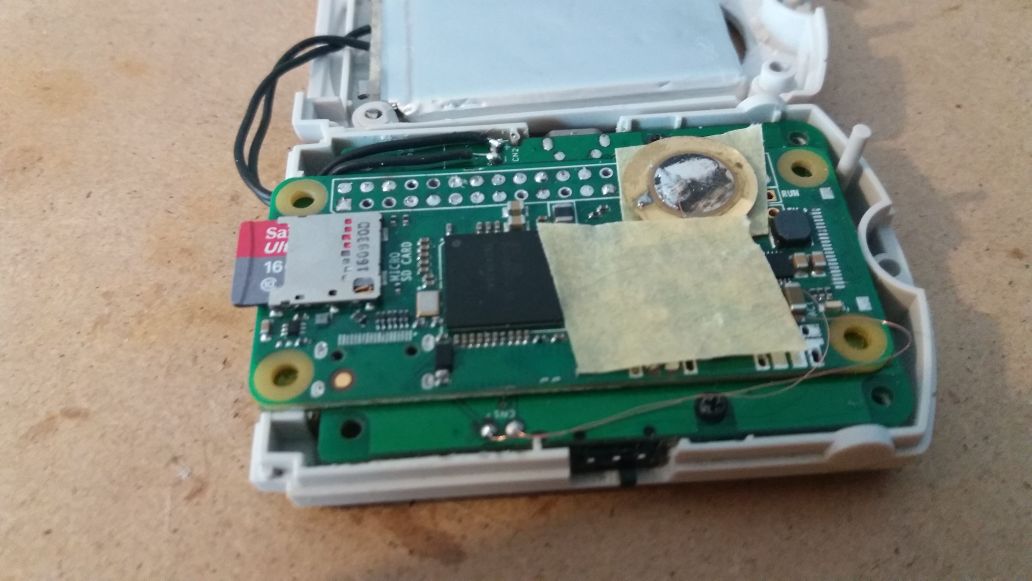

Managed to get the speaker back in!
Its still loud enough even. Took me 30minutes to solder those stupid 0.1mm magnet wires :)
EDIT:
Found the battery monitor guide by Robbi_Blechdose and ordered a few Attiny85's and a programmer, should easily fit in the empty space at the bottom :)

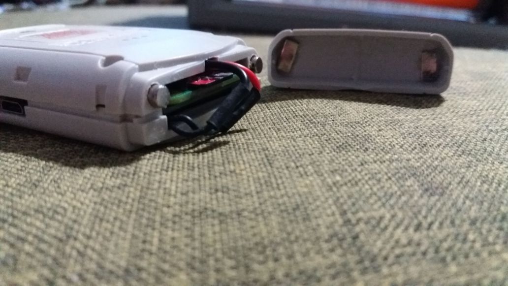

And a little bit more:
I added 2 magnets so that the lid stays closed as well as a connector on the outside to charge the battery.
I have issues charging through the board, it has to stay on to charge and even after leaving it on for the night the 400mah gave me just 20 minutes and the 800mah 15 minutes. So now I can charge it while it is off using a powerboost.
