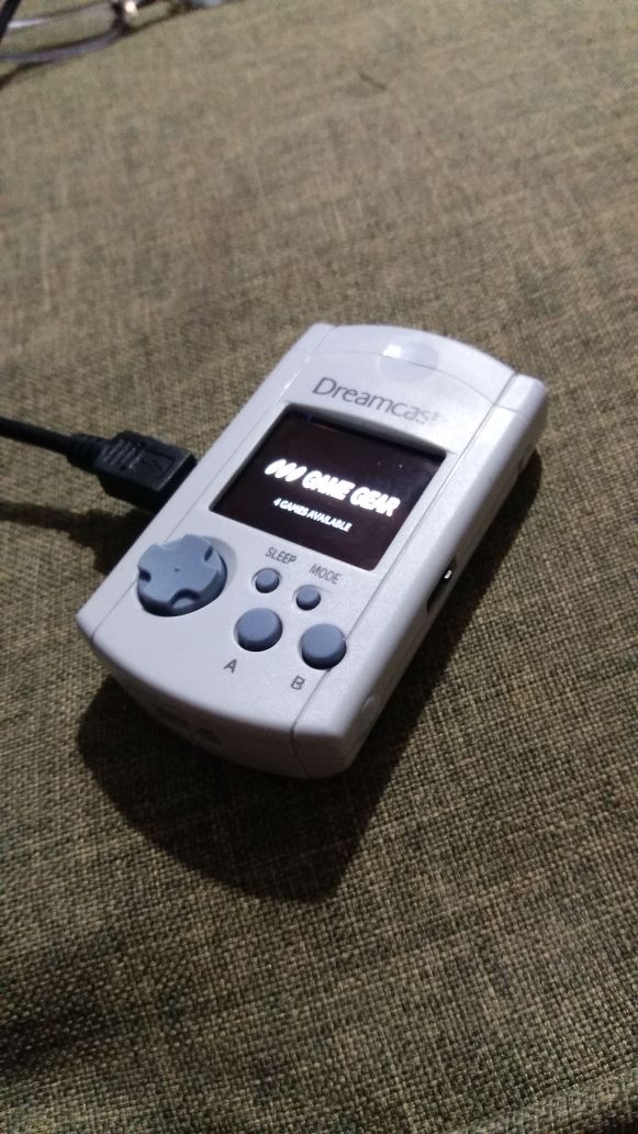

Re: Dreamcast VMU Zero All-in-one
Got mine working finally (thx satri who pretty much did 95% of the work for me!).
Gameboy, NES, Pico8 and GameGear are perfectly playable. Gameboy is the best because of rather large font sizes in games.
It uses the artbook-micro theme which works perfectly well.
Screws on top and for battery are cut and glued in place. The Sound is actually perfectly OK and loud enough using the stock speaker!
I currently have a 400mah battery in there but enough room for a 800mah. I still have a few vmu's left, so I will wait for satri's v2 and kite's as well, I just love the look/form factor of the vmu!
PicturesShow

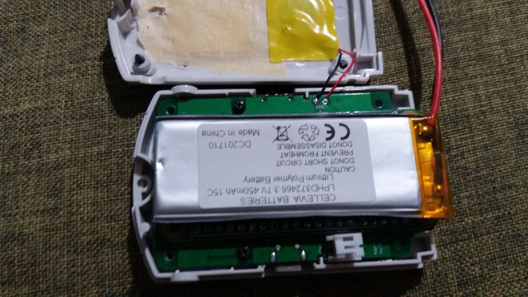

400mAh: Cellevia Batteries LP403035
450mAh: Cellevia Batteries LPHD372466
800mAh: Cellecia Batteries LP453350
The 400mAh fits easily, I just shortened the cable a bit, I even had to add some padding so that the Battery flap thing stays in place.
The 450mAh (the long one) would fit with a simple additional case modification at the top to sandwitch it in.
The 800mAh needs to be stripped of the tape around the board and you will have to cut a bit of the material left and right so it fits between the screw things. Its a tight fit but it does close. But some additional modifications are needed for the cable, they need to be replaced with thinner ones and routed out and back in again to fit.
PicturesShow
I fitted the 800mAh today.
Works just fine and it is a perfect fit...so perfect that there is absolutely no room for anything else.
Meaning, I lost the speaker :/ I have about 7x9x6mm to fit one at the bottom, maybe from a phone?
I had to do a few small case modifications to route the cables (original ones were too thick and were replaced)
The cable needs to go outside the case because even the cable adds way too much for it to close, but it hides nicely in the lid.
