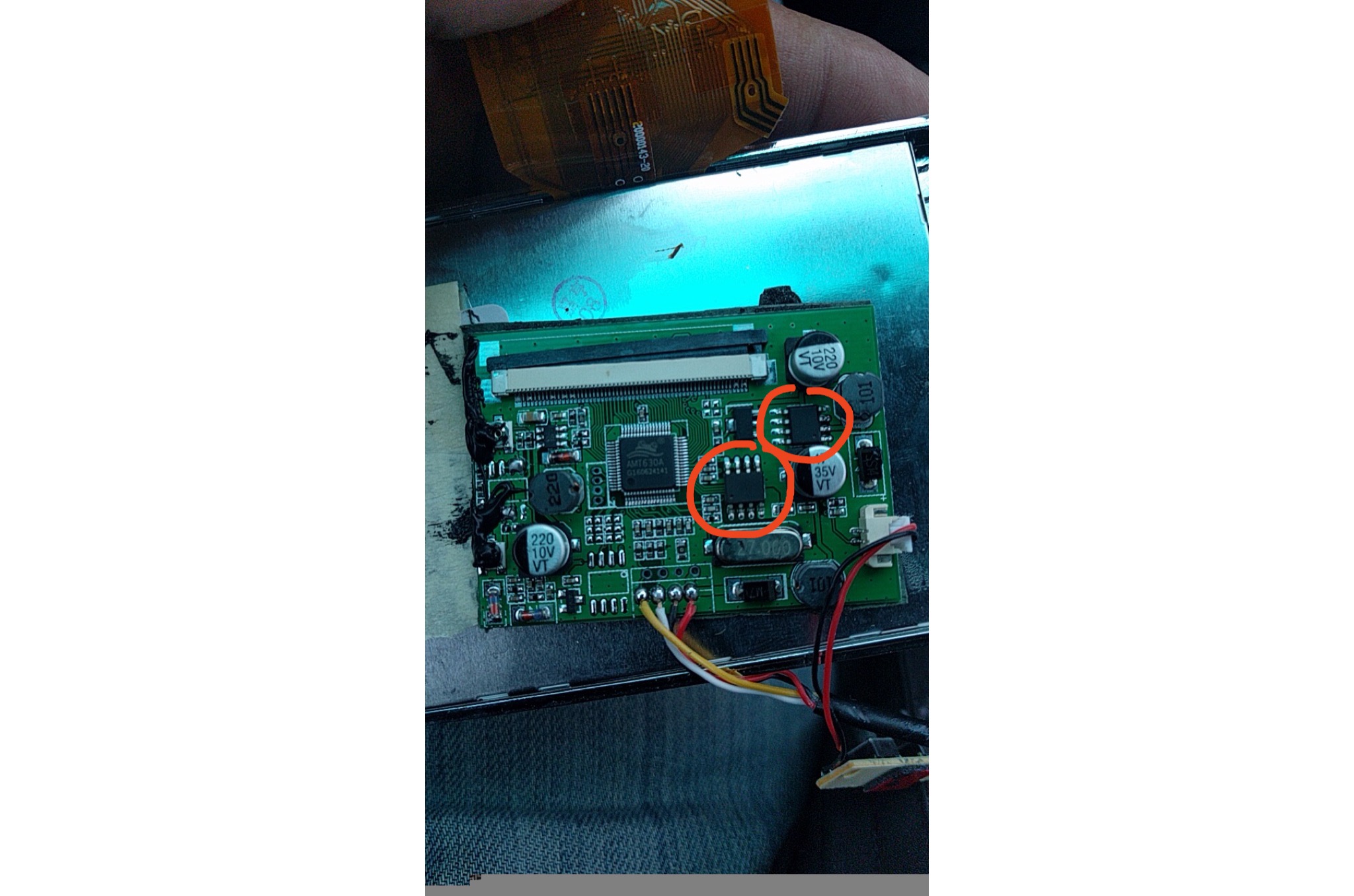

:?: I got this screen from Epathdeals /epath china from amazon. Please help me figure 5v mod on this one. It doesn't match any configuration on wiki. Thank you

Does any of these say 1509?
If it does, same thing applies as from the other guides.

Yes right side one says xl1509. Should i desolder it?

You can, or I think you can even leave it there, as long as you connect the 5V to it correctly.
http://sudomod.com/wiki/index.php?title ... oard_2.jpg
edit: 5V to Pin2... GND might not be needed, but if that doesn't work, do GND as well.

Does dot on chip means pin 1 start. if thats correct then by mistake i put wire on # 3 pin . screen works now but video is little choppy.
should i move it to pin 2.
