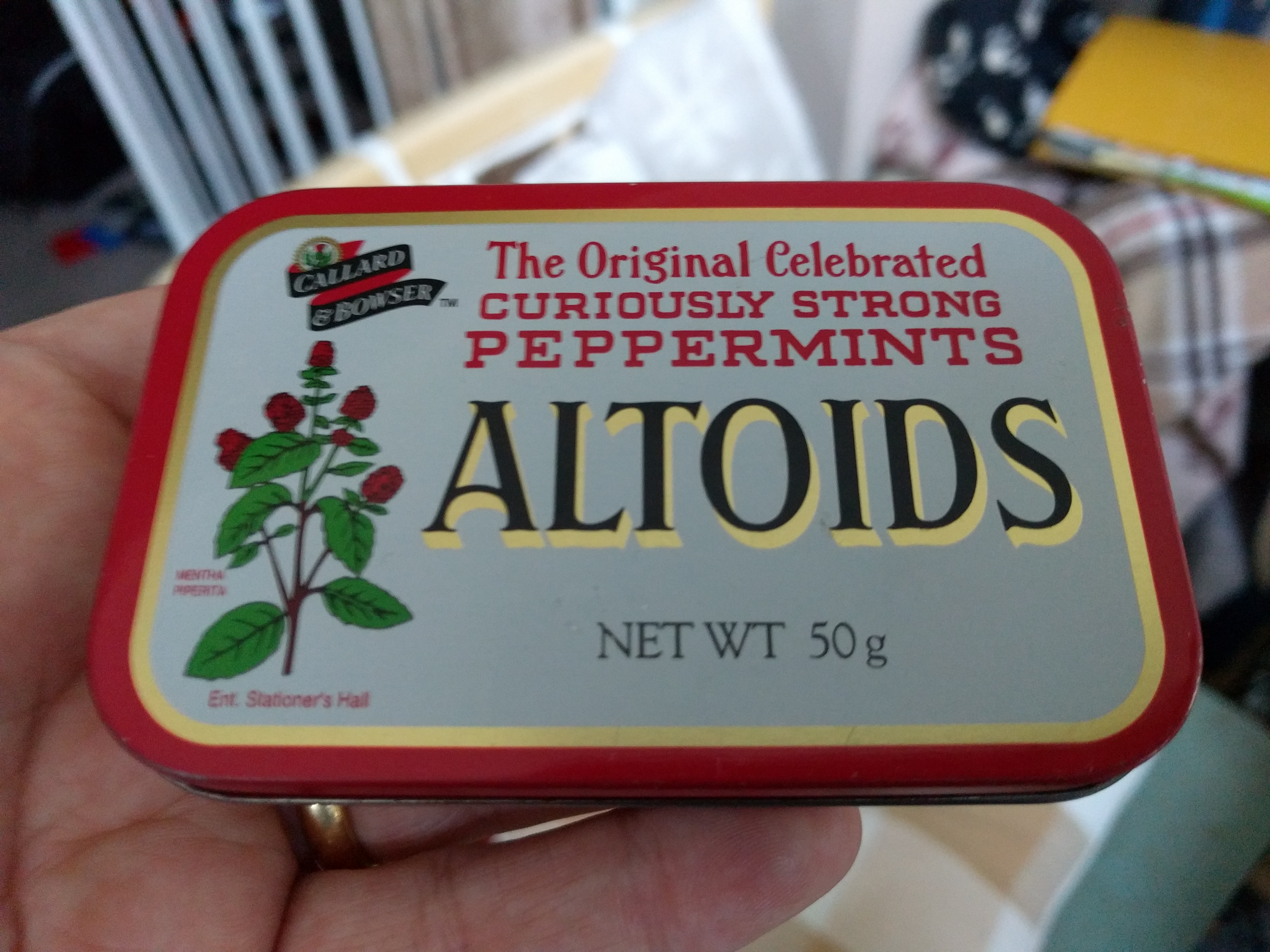

obsidianspider wrote:
Tue Apr 11, 2017 9:10 am
I'm really curious to see how the L and R buttons are being held in place. Maybe some more 3D printing under things on the bottom?
Yep, there is a plate that goes in the bottom to hold things like the power supply, battery and L/R buttons in place.

This is sweet! Could we get a picture of the insides? I'm wondering how difficult it would be to add a couple of circle pads...

I was going to build a GBZ as my second build (I recently put a Pi Zero into an SNES controller which was a really fun build) but I think I will do this one instead. My only questions are: What screen was used? and did you fit a teensy in there for mapping the buttons or did you do that some other way? I'm not sure all of us need a step by step (although honestly I'm probably one of the ones who do) but a parts breakdown would be HUGE so I could order them before the build video comes out.

Sirlias wrote:
Wed Apr 12, 2017 9:38 am
Thanks.
looking back through twitter, the screen is an ili9341 as in the guide in my signature.
https://twitter.com/sudomod_wermy/statu ... 2871549953
and to save space, i would assume gpio is used for the buttons

moosepr wrote:
Wed Apr 12, 2017 10:31 am
Thank you. That is very helpful. I do remember Wermy saying on the original GBZ build that wiring to the GPIO directly made getting sound very difficult. I'm very curious how he was able to do both in that case.
Thanks for the info. The original screen was 2.2", in the video he said the new version's screen is bigger.
