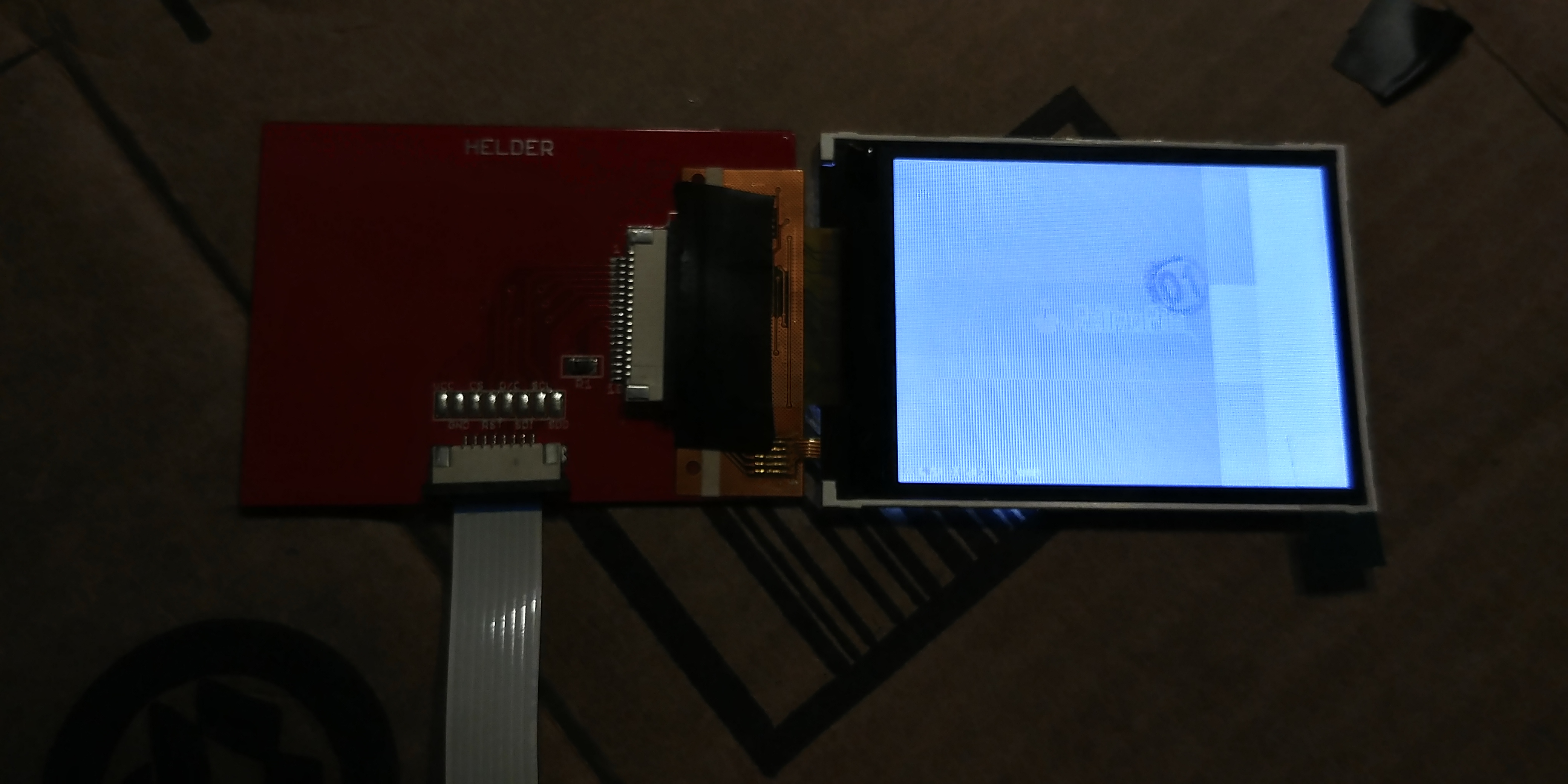

So I'm getting partial white screen?
I can see retropie in the background but the screen is still mostly white
- 15007749420791322052252.jpg (1.53 MiB) Viewed 8573 times

First time I have seen that, be sure the screen is lined up properly with the socket pins. Try moving the screen ribbon a bit and see if it works on a reboot.

Re: White screen
I've spent a good 2 hours aligning the ribbon cable, adding more tape, less tape, this is the closest that I get to it working.its either all white, half white or not on at all. I'll try again more tomorrow
