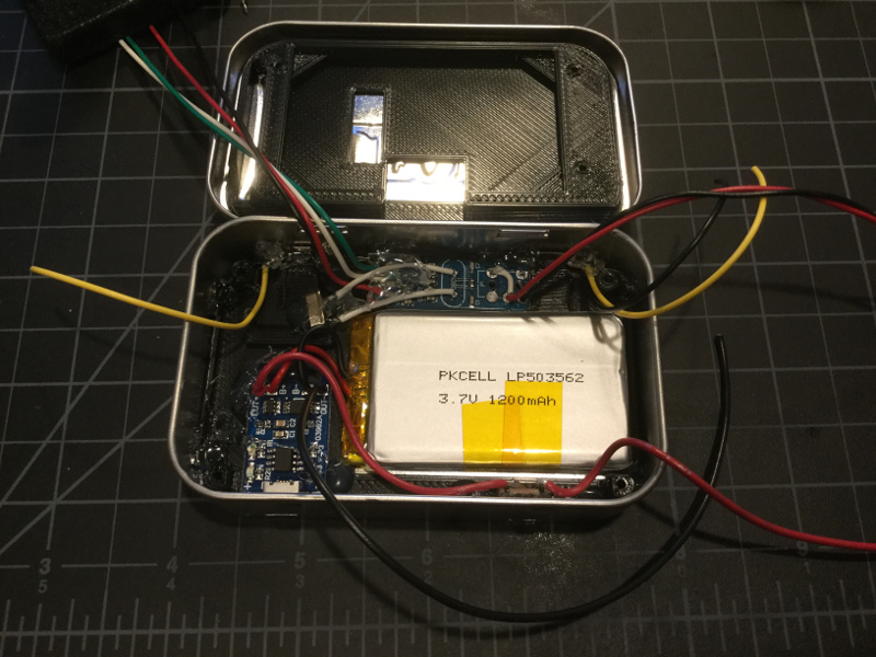

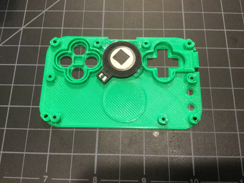

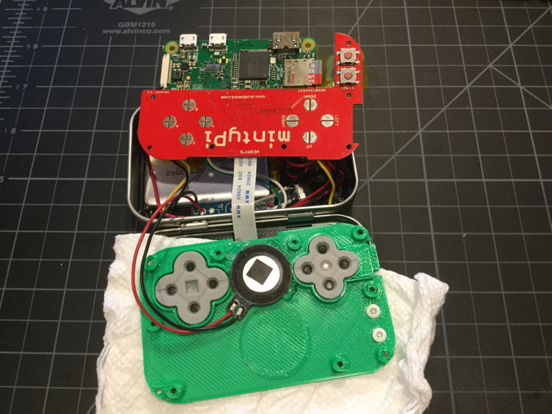

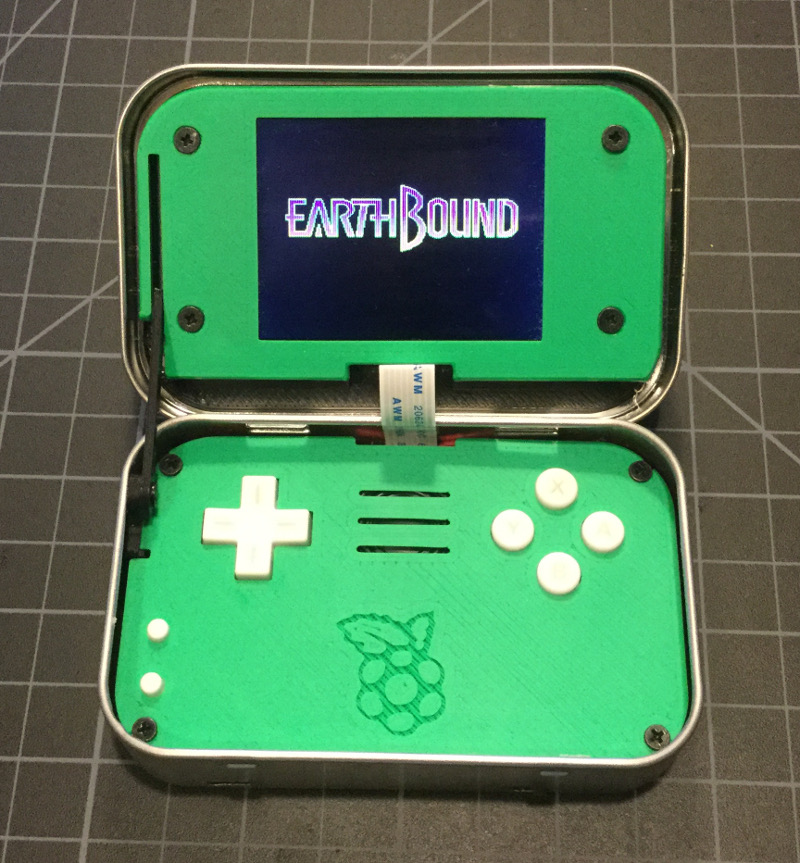

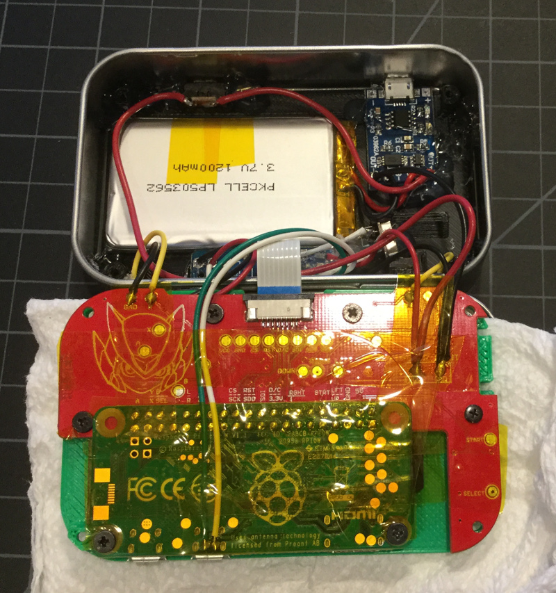

My build was prety much according to the guide, except I used a cheap charge/protect board from eBay instead of the microLipo and I also "convinced" the 3D printed part that holds the speaker with a file so I could use a DS Lite speaker. Thanks to Helder and wermy for the excellent parts and guide.
My build wasn't the cleanest, but I'm pretty happy with how it turned out.
Here's a short video of my first test game after the build was "done"

looking good!!! :)

obsidianspider wrote:
Sun Jul 23, 2017 9:29 pm
ooh it fits after all! I can go back to my plan to do that since I haven't ordered a 20mm speaker yet.
nice!

abrugsch wrote:
Mon Jul 24, 2017 2:48 am
nice!
I totally removed the speaker rib and then took a little bit out of the button surround on each side and it seemed to fit pretty well. Eyeballing it has the DS Lite speaker about the same thickness as the plastic that keeps the buttons in place. That said, I learned with this build that fractions of a millimeter can make a big difference.
Mon Jul 24, 2017 5:26 am
I might just remove it from the STL and reprint ;) maybe in a different colour
quite! so far I have issues with the start/select buttons being pressed if that side is screwed too tight. I may have to file some material off the buttons or the switch tops...

abrugsch wrote:
Mon Jul 24, 2017 6:18 am
Mine is definitely squashed in there. I tried to be careful with cable management, but even still, it is really cramped. I noticed that the "top" to the "bottom" isn't totally flat when I screw it down, but it's not awful. For now I'm going to leave it.
