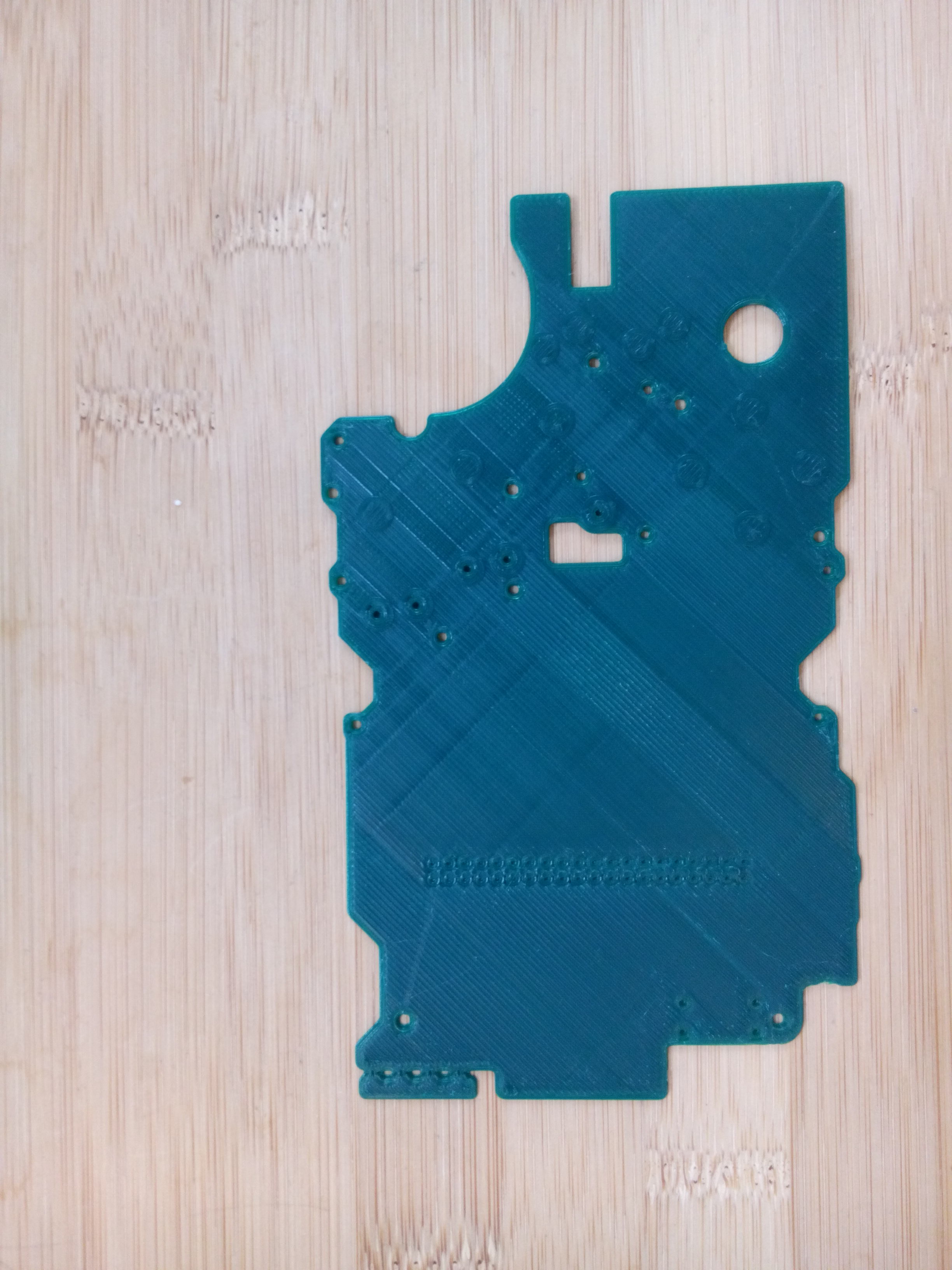

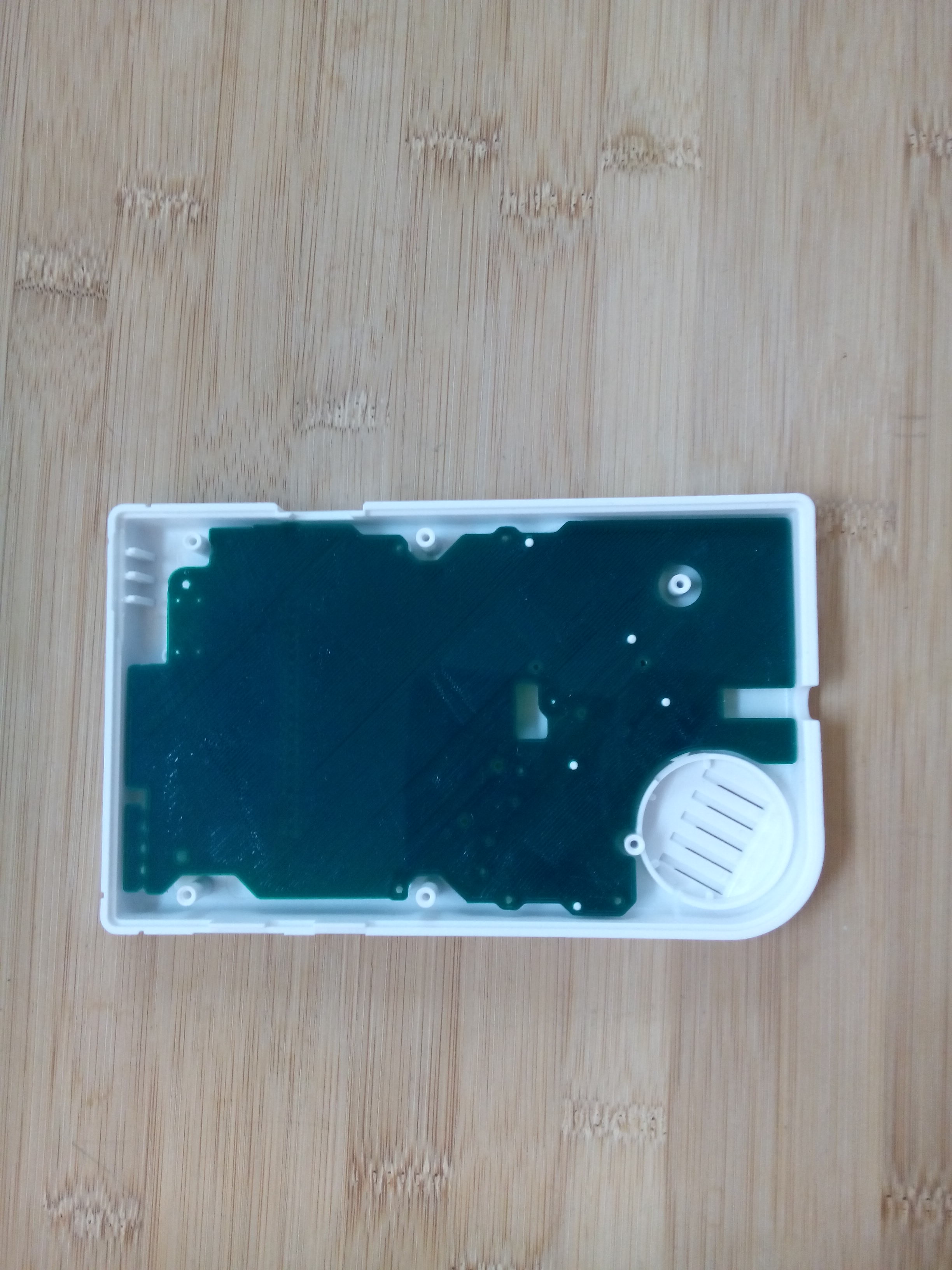

moooarcuuuus wrote:
Wed Aug 16, 2017 11:27 pm
Kite uploaded a dxf with the outlines from his board. You should use it to desgin your case.
http://www.sudomod.com/forum/viewtopic. ... 314#p38391
There are small tricky things, not really bad, but unexpected. The AB-YX square is no square, it is a parallelogramm.
Oh, that's interesting! Thanks for pointing this out!
Since I haven't received my SAIO yet, I had to guess about the buttons and always assumed a perfect square.
Judging from your screenshots I'd say the offset is minimal. Since the contacts on the SAIO seem to be quite large, would you say that this could create technical problems or would it be more of an aesthetical choice? I don't have any experience in this. :?
What bugs me more is that I seem to have misplaced some of the pins on the inside by up to 2mm. Also the pins for the new button wells must be removed, I didn't take into account that the SAIO doesn't have holes for them. I'll download the .DXF for the PCB and fix these tings ASAP.
moooarcuuuus

I dont think there will be contact problems, the drift on XY is ca 0,65mm. But it is not god for a new case. In the construction business is a golden rule: never use the tolerances of the production already in the construction.

I've updated the first post with new downloads and pictures.
I moved a lot of the things on the inside of the front shell slightly around so that it should fit the SAIO way better now.
Also the download now includes models for the x-pad, the AB-buttons, the on/off switch and the plug for the EXT.CONNECTOR slot. Just in case anyone ever wants to print those as well. The additional models are located at the origin, so you might want to re-position or delete them for printing. The .STLs have them all as separate files.
