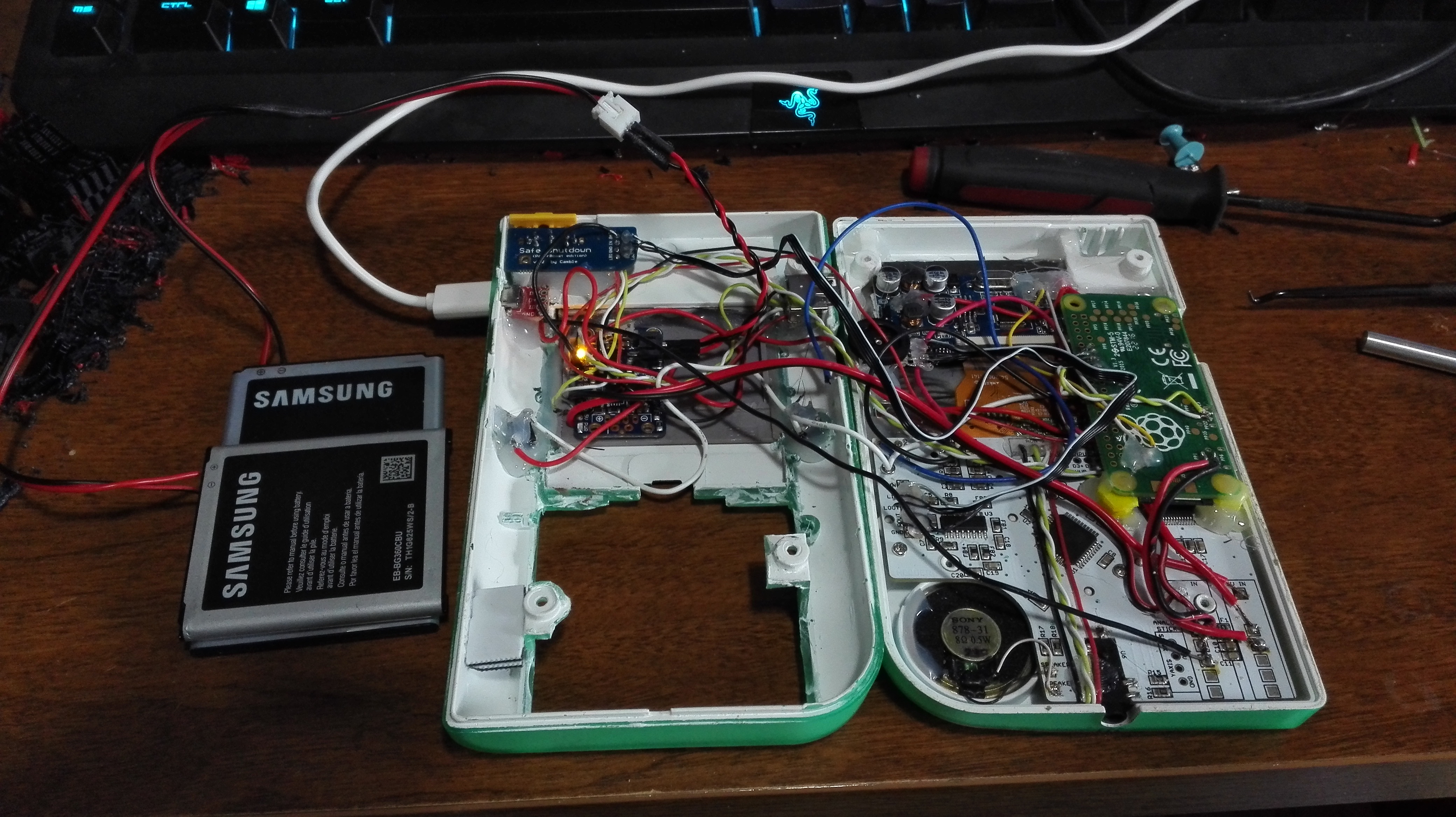

Re: I Like Big Batteries! (and i cannot lie)
I have 2 Samsung phone batteries wired together in mine. One is 3100 and one is 2000 so I effectively have a very slim 5100mAh in my unit. I literally just wired it up and am currently charging it so I am not sure how long it will run for yet.
EDIT: Such beautiful. Much cable managed. So Samsung. Wow.

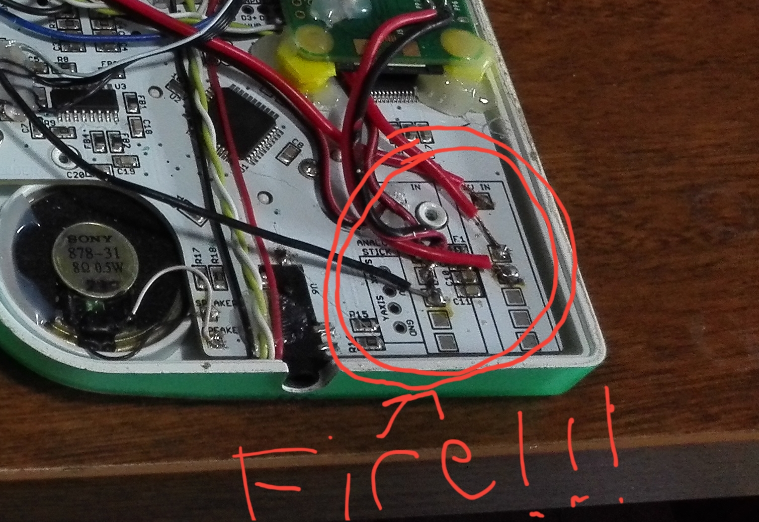

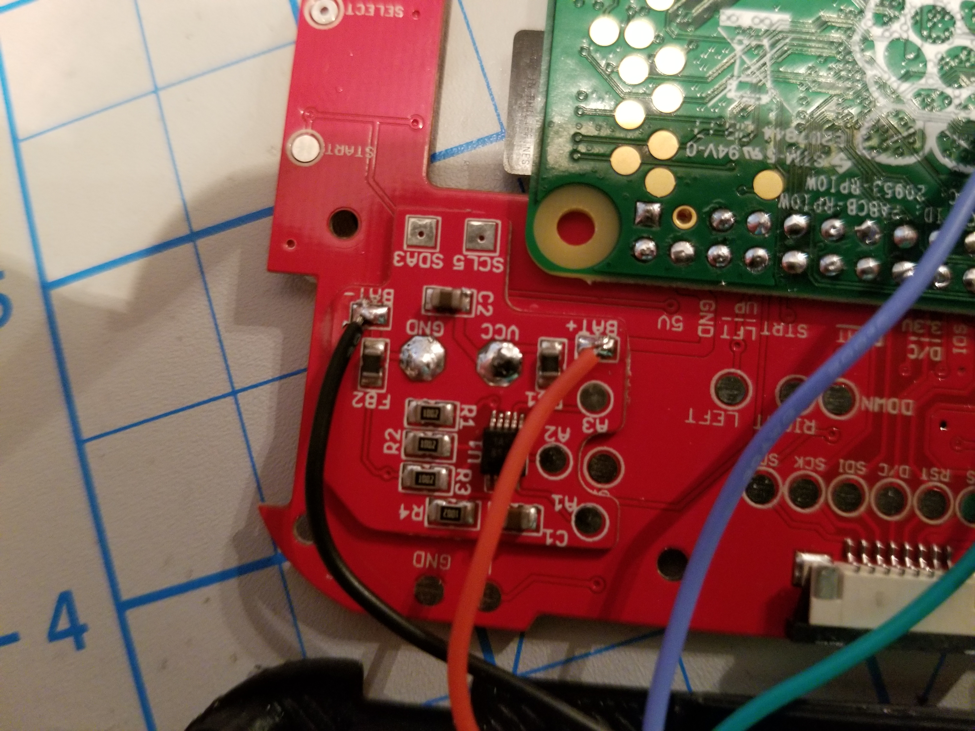

Dude, you have a fire waiting to happen. Shorten up the exposed wire on your 5v and GND. You're begging for a short.SumCanadianGuy wrote: ↑Fri Sep 01, 2017 4:09 pmI have 2 Samsung phone batteries wired together in mine. One is 3100 and one is 2000 so I effectively have a very slim 5100mAh in my unit. I literally just wired it up and am currently charging it so I am not sure how long it will run for yet.
You should have a minimum amount of exposed wire left over.
Here's an example on what I'm talking about:
They don't move around in there but I suppose I could shorten them. I have had it like that for nearly a year with no issues. Thanks though.
all it takes is one time and I know closing GBZs are a pain. Just trying to help you be safe.
