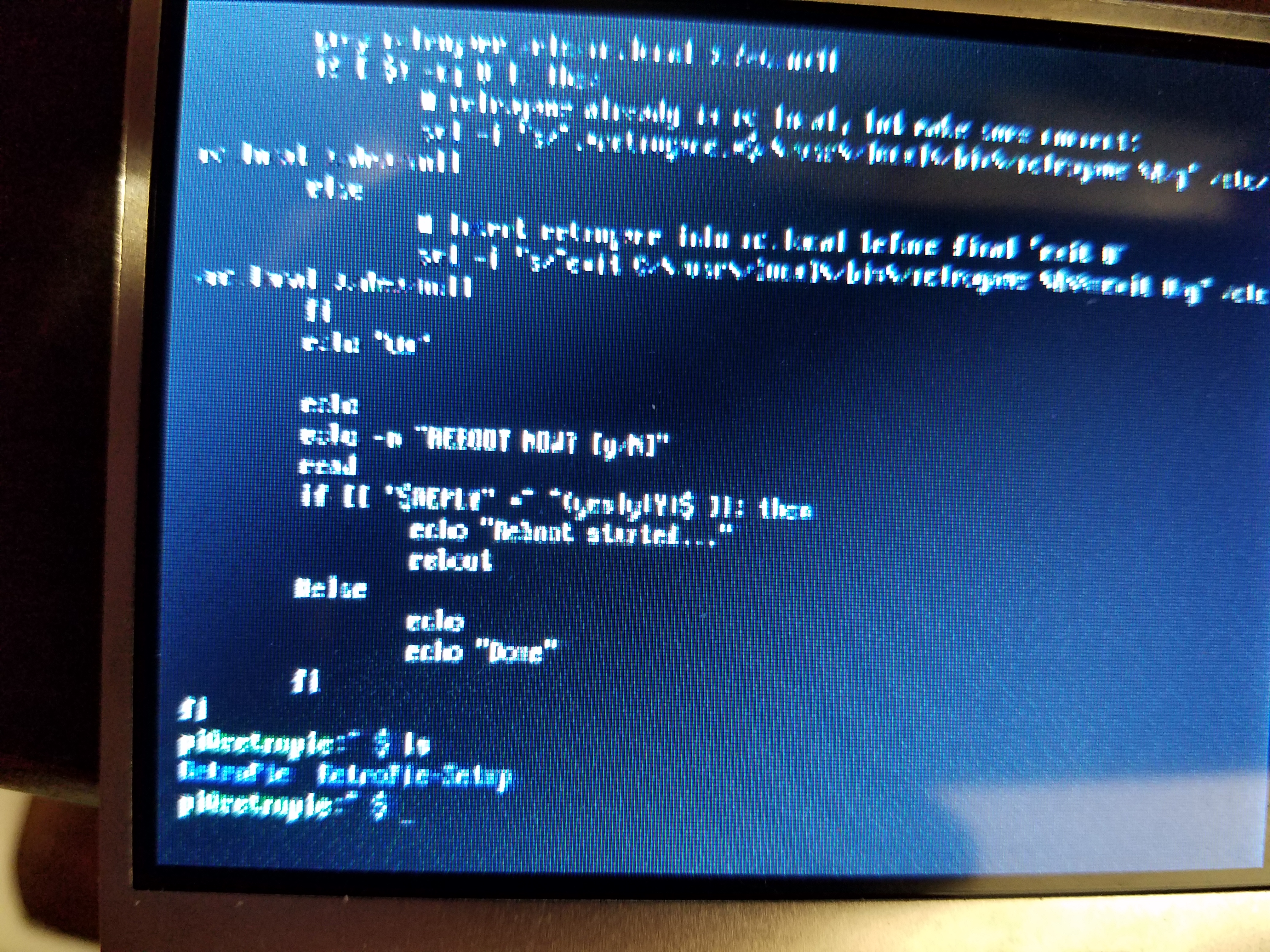

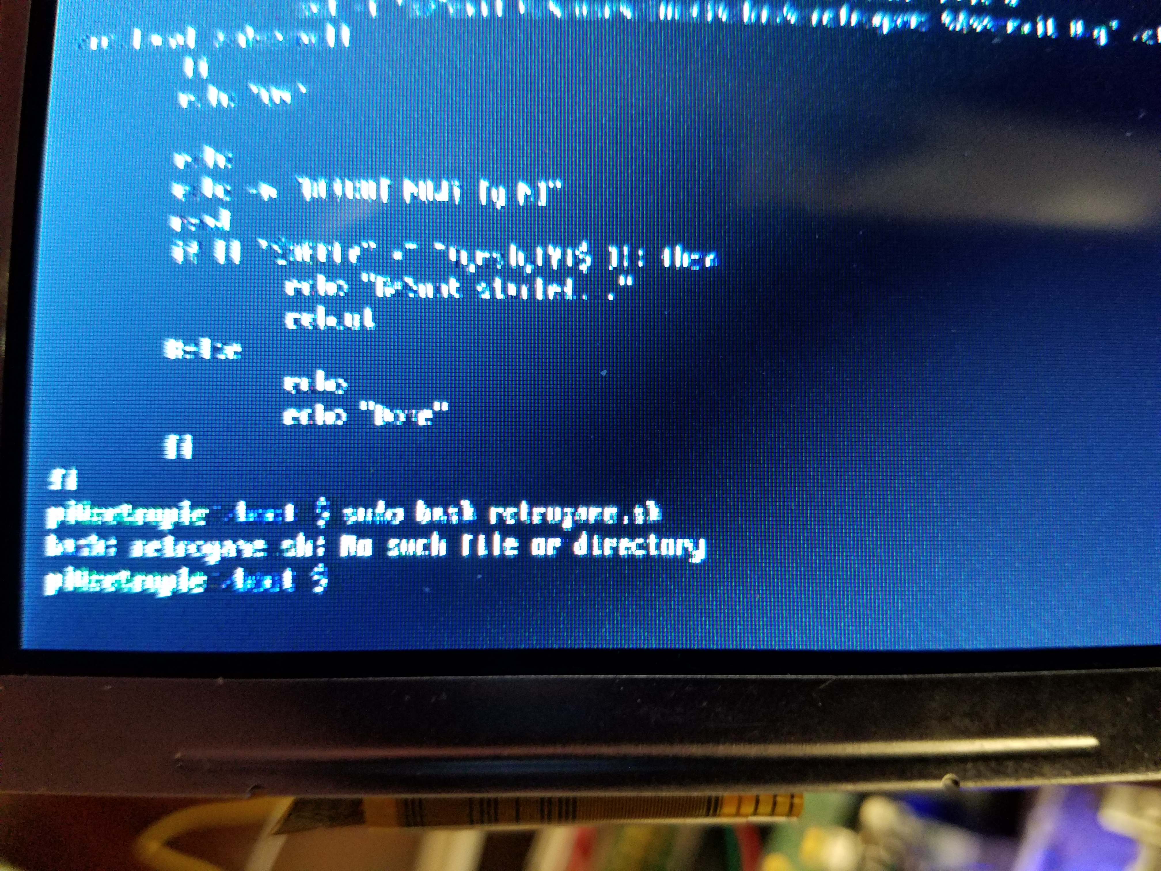

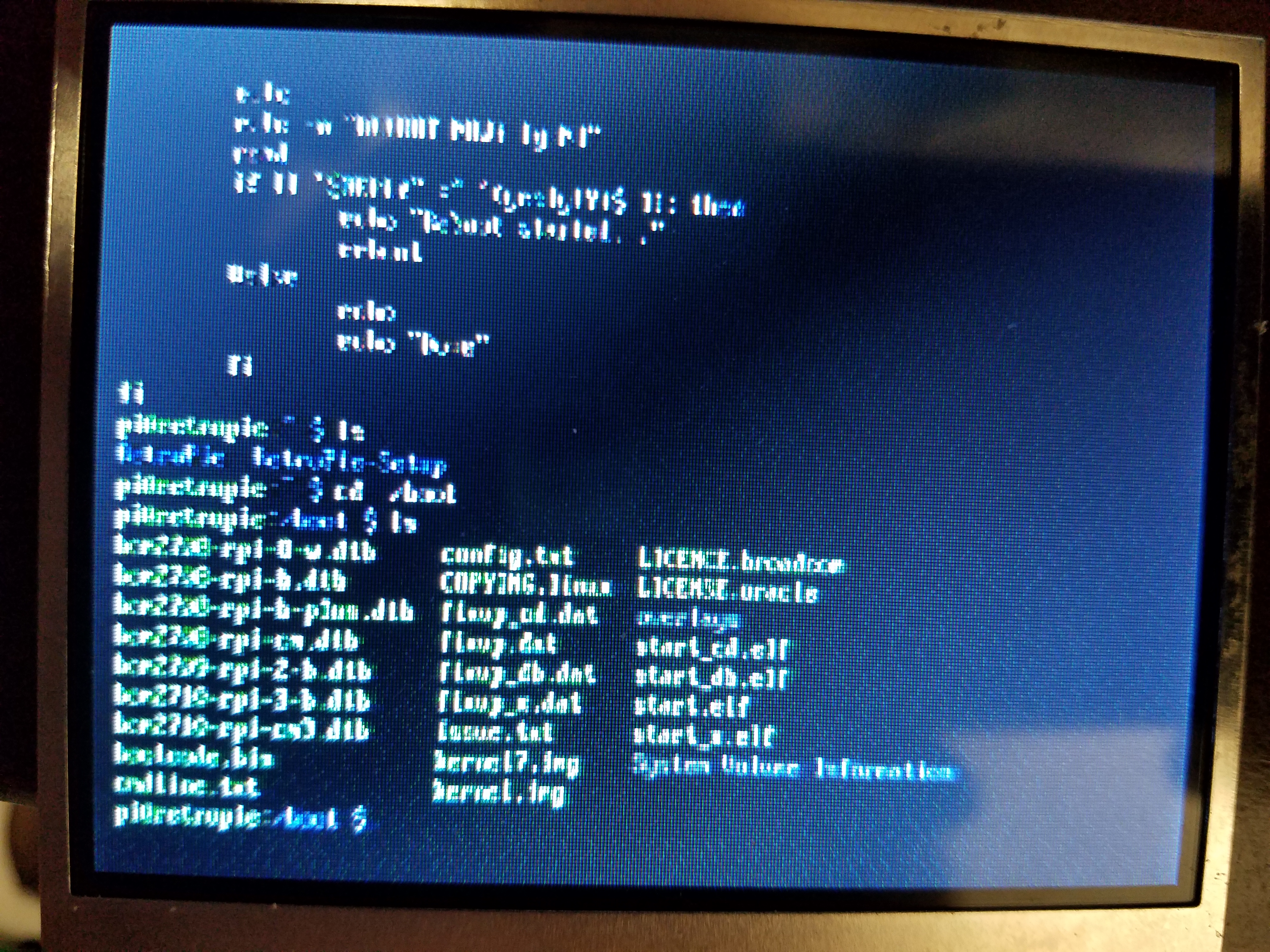

Working on another gameboy zero with the BW screen. trying to install the GPIO option. Followed the How to guide and since i am using retropie 4.3 it doesn't have Adafruit-Retrogame on it and when i try to use the curl command to get it, the file displays the code but doesn't actually download the program or make the directory. I have not been able to have it let me make the file itself with a make command. I do have Wifi and internet, the Adafruit test command resulted in a confirmation. It just doesn't seem to want to download but show what "https://raw.githubusercontent.com/adafr ... trogame.sh" display if you go to it in a browser.

Did you make it executable ?
Sudo +X your_file
And then launch it via sudo ./your_file
Sudo +X your_file

i normally install it manually.
then you need to create a file to make retrogame in the actual games
then inside nano you need to paste
press ctrl + o to save, then ctrl + x to close
you will then need to make it run at startup, so add it into /etc/rc.local
git clone https://github.com/adafruit/Adafruit-Retrogame
cd Adafruit-Retrogame
make
sudo make install
sudo nano /etc/udev/rules.d/10-retrogame.rules
SUBSYSTEM=="input", ATTRS{name}=="retrogame", ENV{ID_INPUT_KEYBOARD}="1"

do i create the file under retrogame, /boot, or home/Pi?

Re: Retrogame will not install
I normally do it in the home directory. I can't remember if make install works.
I did miss the step about copying one of the config files into /boot as that's where it looks for the pin mapping
