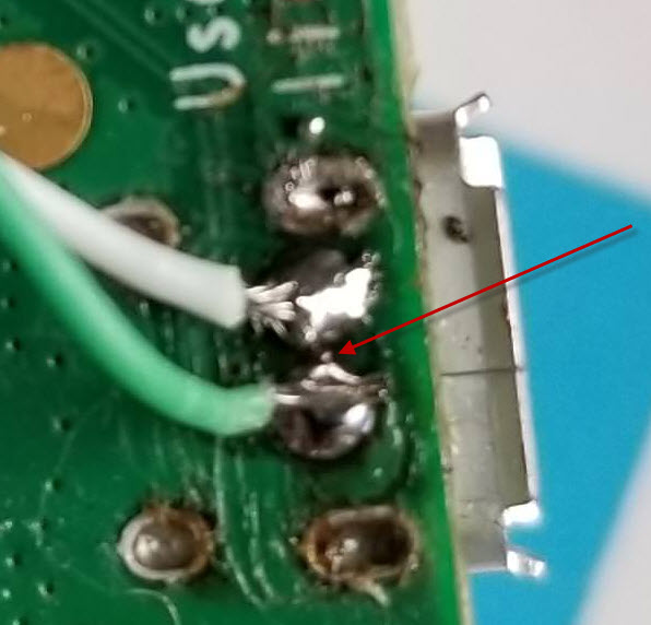

I redid the solder on the connection points and it's still not working. I cleaned the points on the Pi as much as I could prior, but maybe I'm still missing something. Here's some close ups of the connections:
Image/
Re: No Gamepad Detected (Helder AIO)
Post by rodocop » Fri Jul 06, 2018 2:44 pm
these look like they might be touching (red arrow). If they are, it will not work. Also, to confirm, you have the board powered by 5V. I don't see in the pictures where the powerboost is, but I assume you have 5V going to the AIO.
7-6-2018 2-43-01 PM.jpg (46.39 KiB) Viewed 7256 times

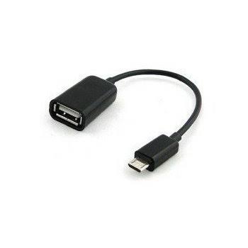

Although I have never experienced a Pi zero with defective microusb port it's always a good idea to test it before wiring any board. Was it working before? What you can do is test it by plugging a USB keyboard but you need a microusb to normal female USB port like this:
Before doing that make sure you desolder the wires on the D+(green wire) and D-(white wire)pads on the Pi Zero.

I was able to get a USB SNES controller to work through the micro USB port, but those pads still aren't a go. This pi has been through a few trials so it's more than possible I've ruined part of it.
