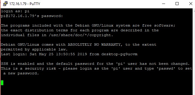

Now that I look further, still no glow on the screen, but putty is strange. I can log in via winscp and transfer files over. But when I try to log in via putty it doesn't get past here.
Never seen that happen, even when I try to run comands via the terminal in winscp it gives me errors too, for example, I cannot run sudo nano /etc/rc.local or sudo nano /boot/config.txt both common commands that have worked on every other pi i've ever worked with.
I'll re flash the image I think.
It's really looks weird. Reflash the SDcard pls.

Post by rodocop » Sat May 25, 2019 8:26 am
I did reflash and it fixed the putty issues. I will check all those points you have show and report back later today.
