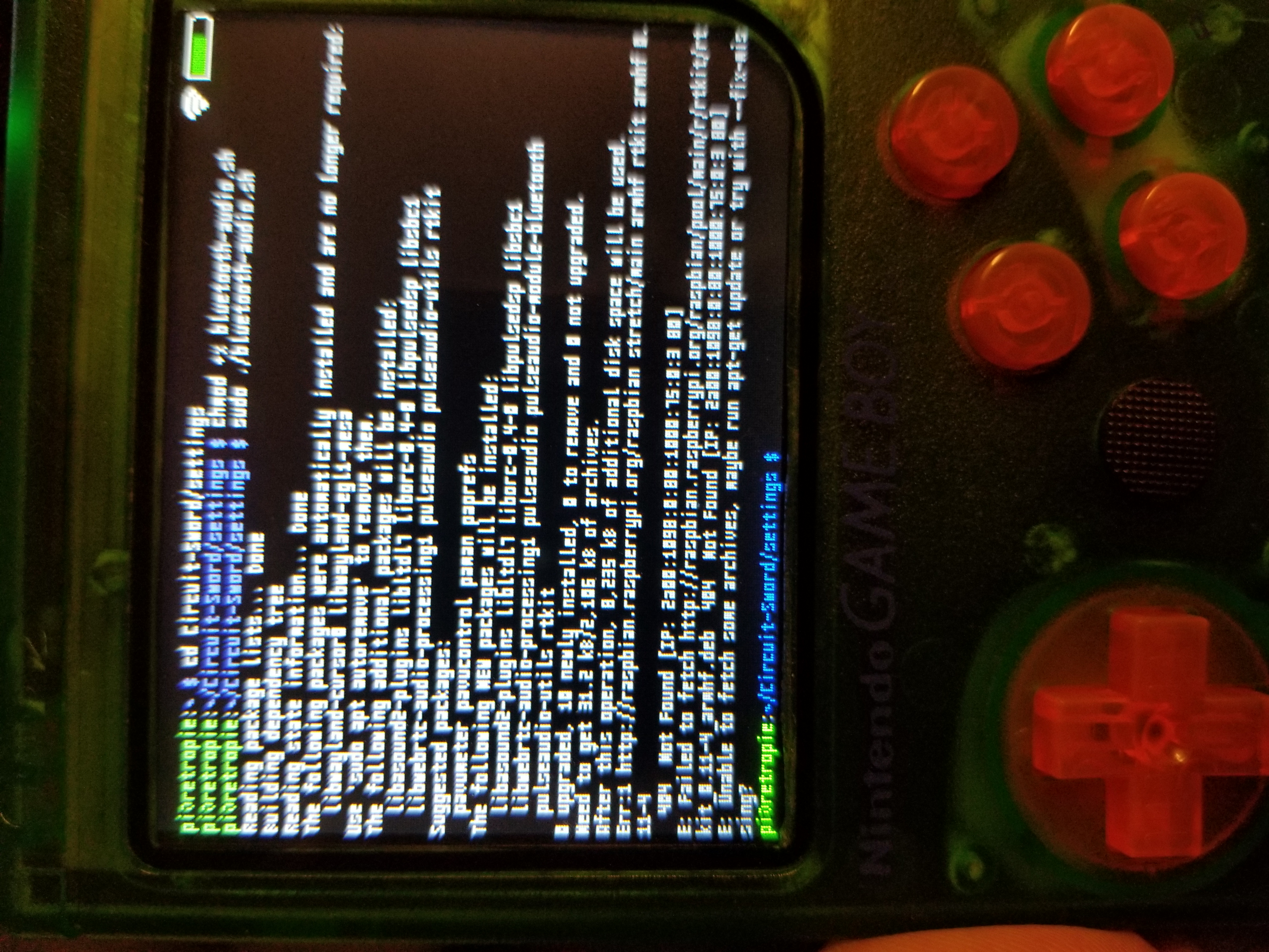

So if I am going to try this route I press F4 and then enter: sudo nano /Circuit-Sword/settings/bluetooth-audio.sh
Is that correct and once it takes me there I input all that in per the lines?
One problem I'm having and I'm sure it's me and for another topic but I still have no audio for my video splash screens as well, audio works fine in the ES and in game play. But when searching for the omxplayer to change "both" to "alsa" using the sudo nano and so far all the different ways I've seen, I can never find any text when using sudo nano just a blank screen with of course the options at the bottom for like exit, write, jump to line and so on but no code.
You probably need to do the following:
cd Circuit-Sword/settings
chmod +x bluetooth-audio.sh
sudo ./bluetooth-audio.sh

This is what I get and still no connection... Hmm...? :D

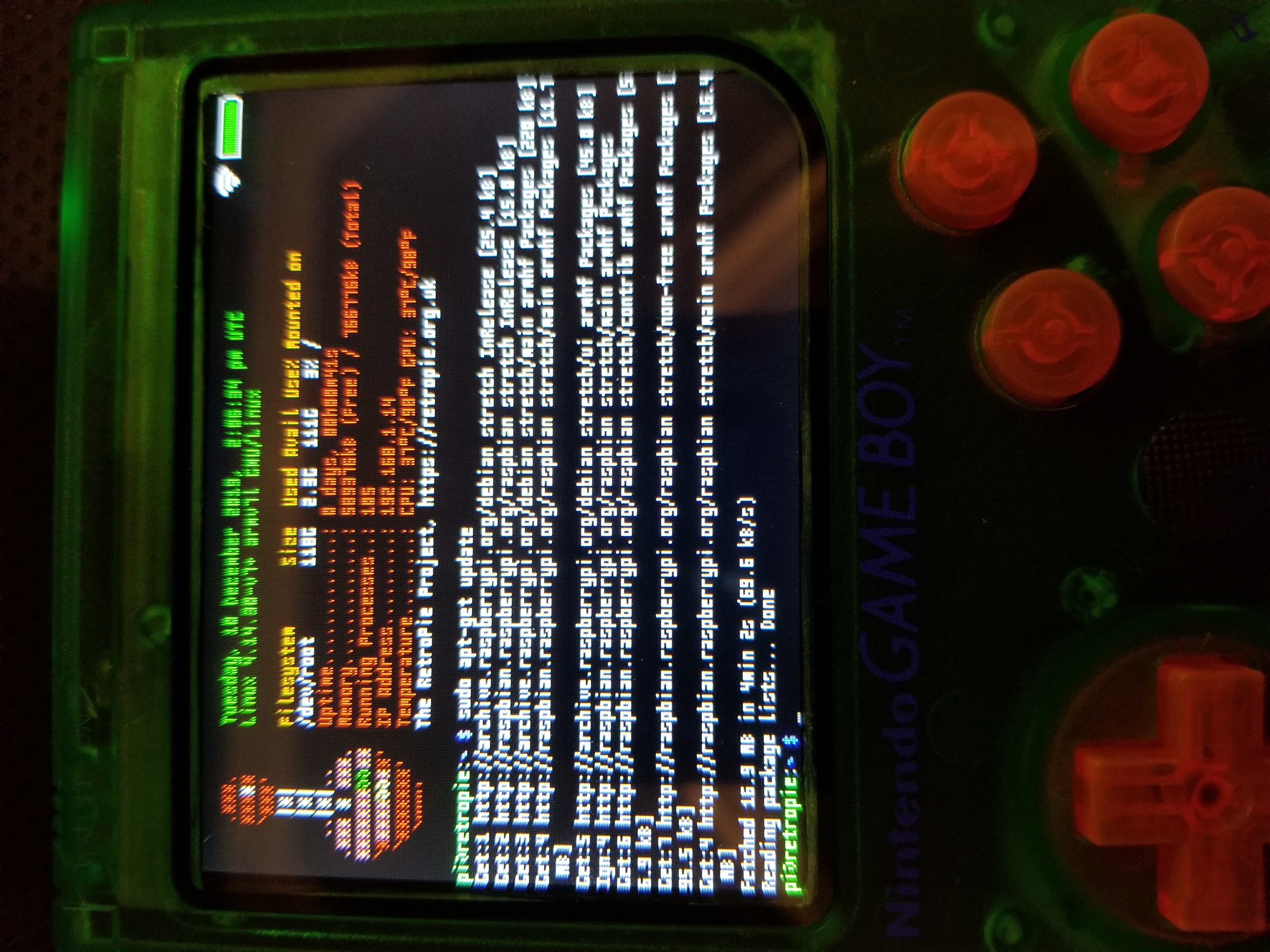

Read the message, does 'sudo apt-get update' work? It is spitting out an IPv6 IP as part of the error, do you have the ability to disable IPv6 on your router? Otherwise I'll need to find out how to do it on the image..

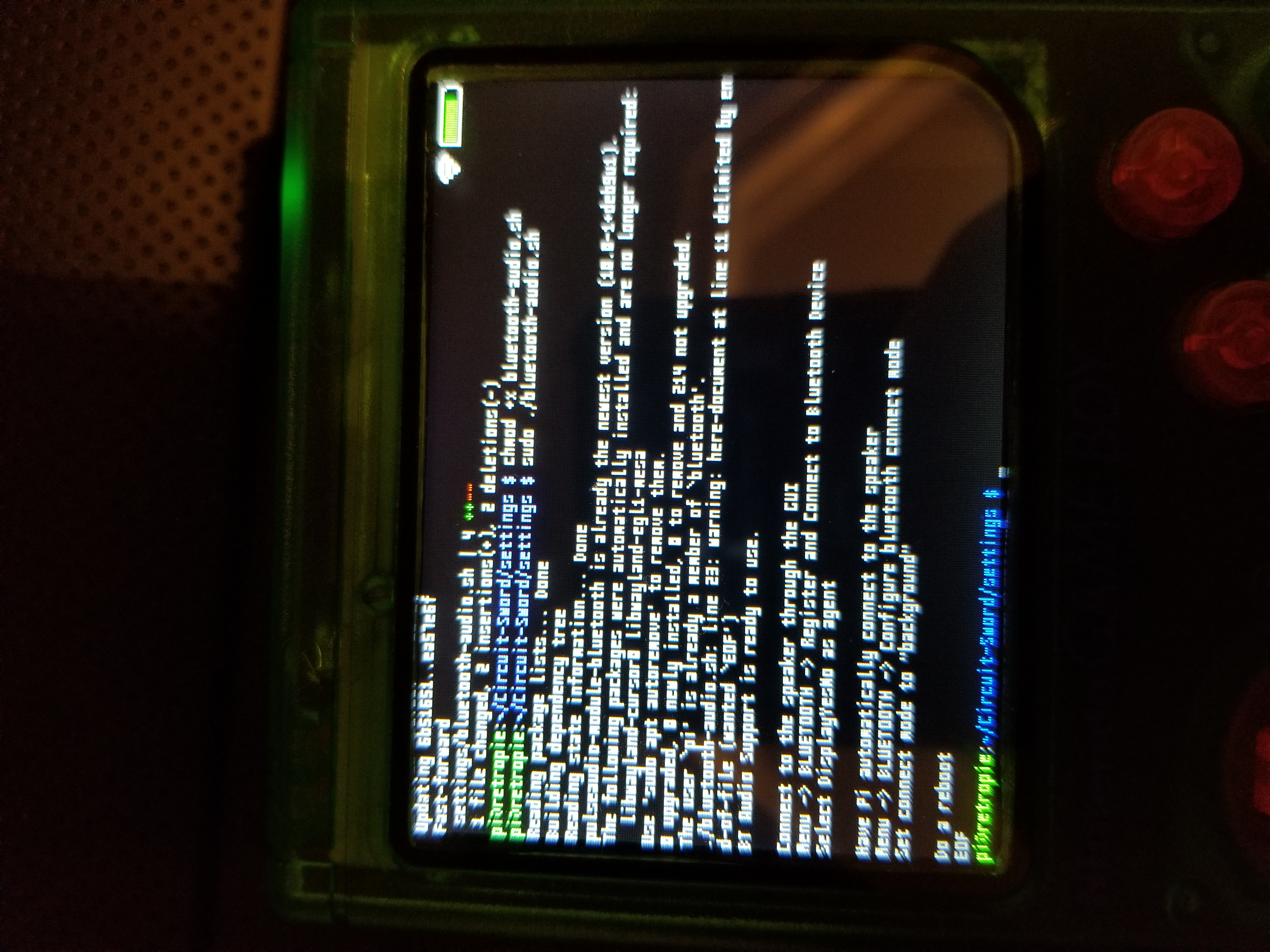

Okay so I did the apt-get update after some time I got this:
Then ran this : cd Circuit-Sword/settings

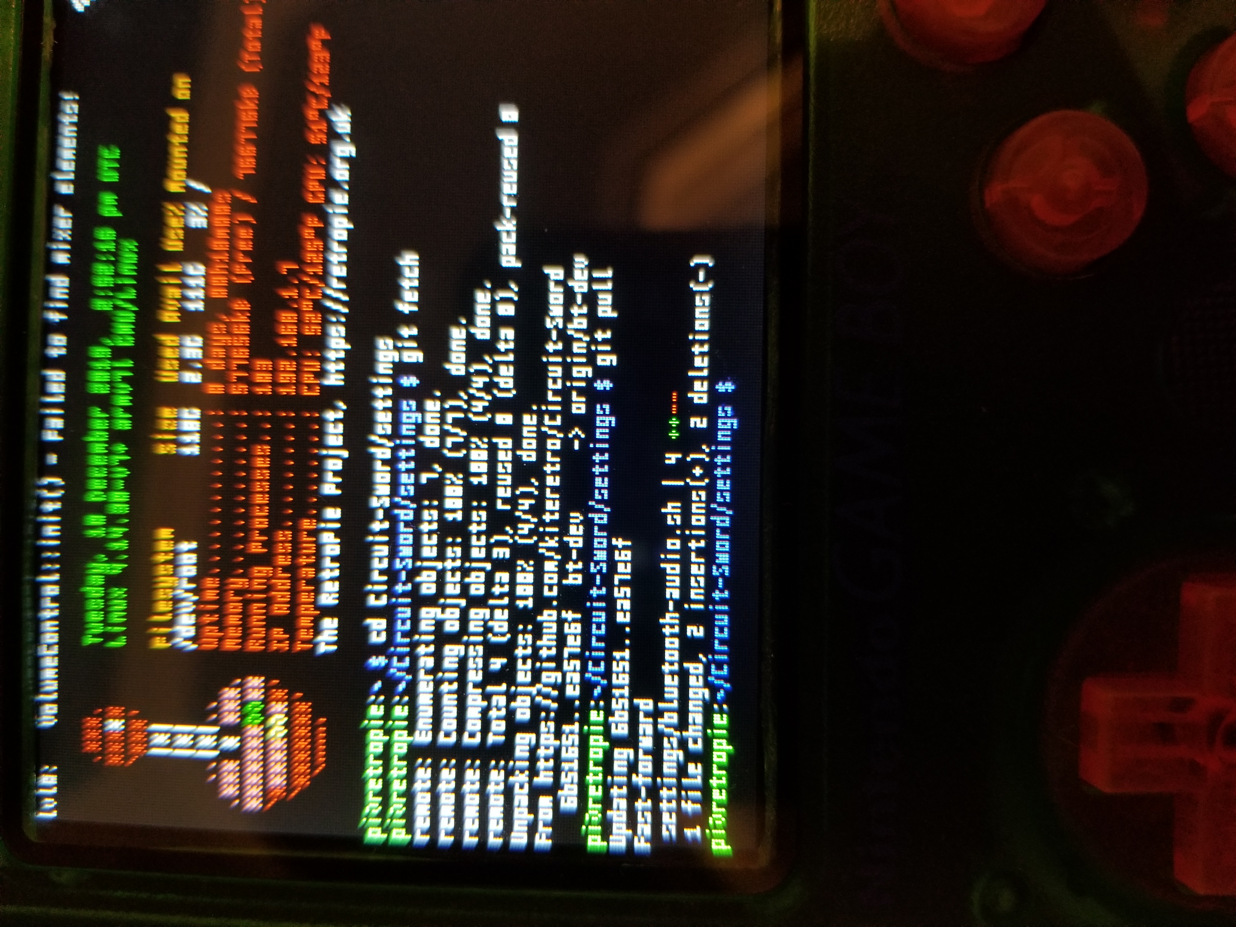

And got so far until another error:

Ok typo in the script, if you make sure that you're in the CS directory, (cd Circuit-Sword) you should be able to do git fetch and then git pull
Otherwise, edit the file with the change that i added here: https://github.com/kiteretro/Circuit-Sw ... 1454b865df (it's only the addition of the "; then" bit)

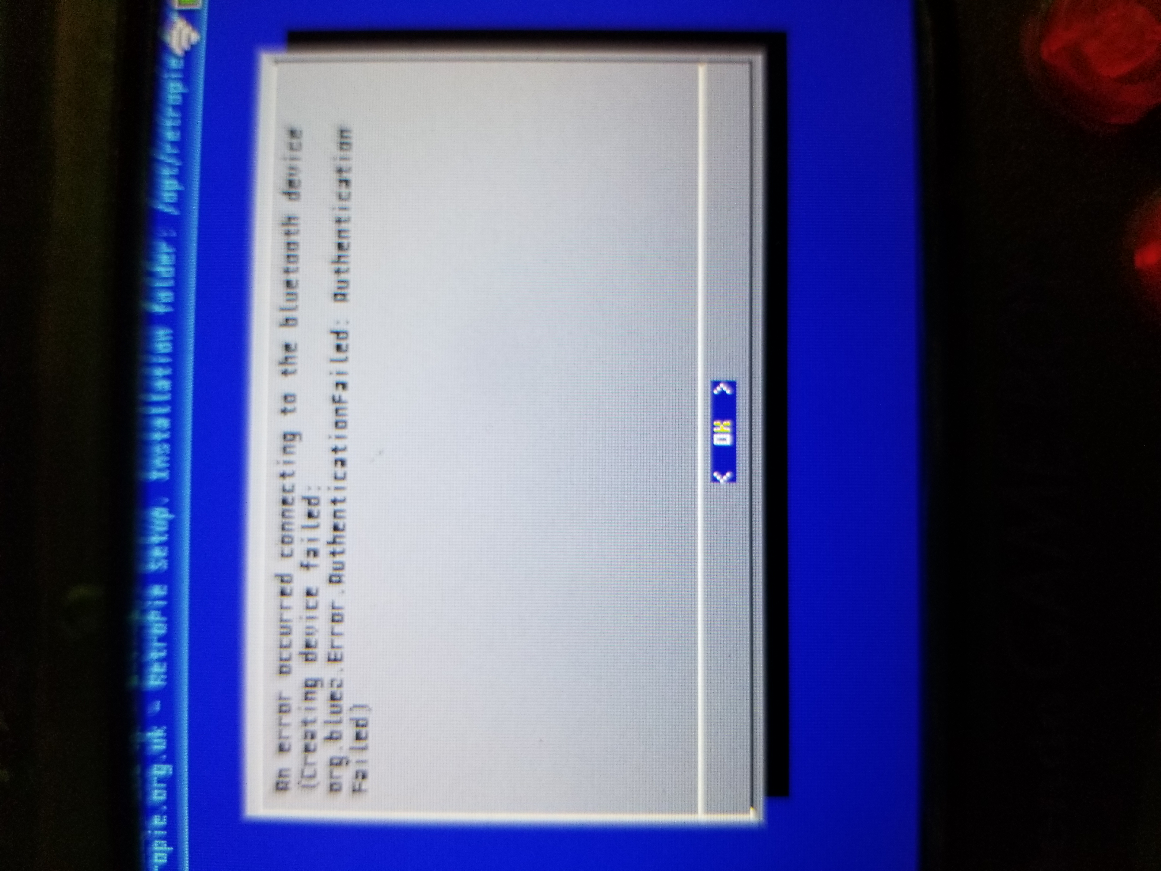

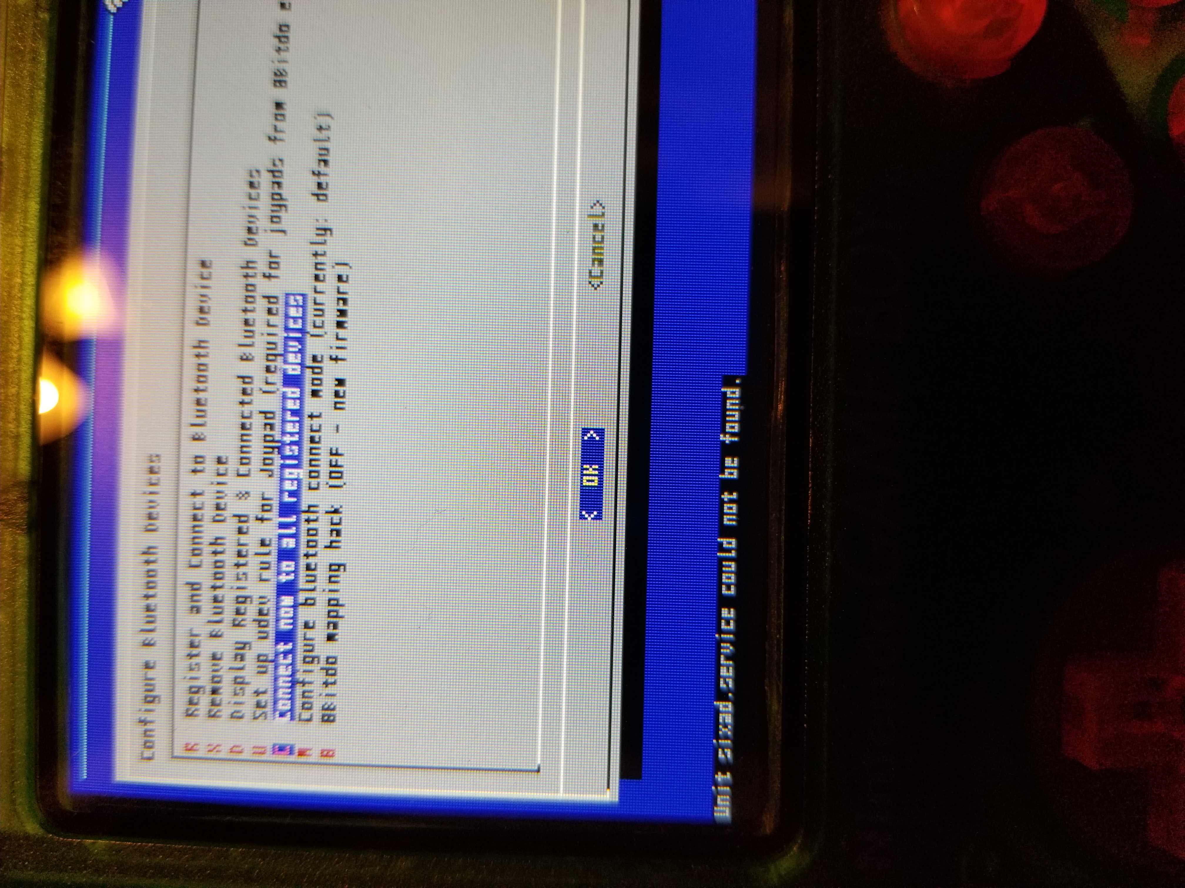

Okay all that went smooth and looked good now when I got to connect I either get the unit sixad. Service not found
Or it takes so long to connect it times out...

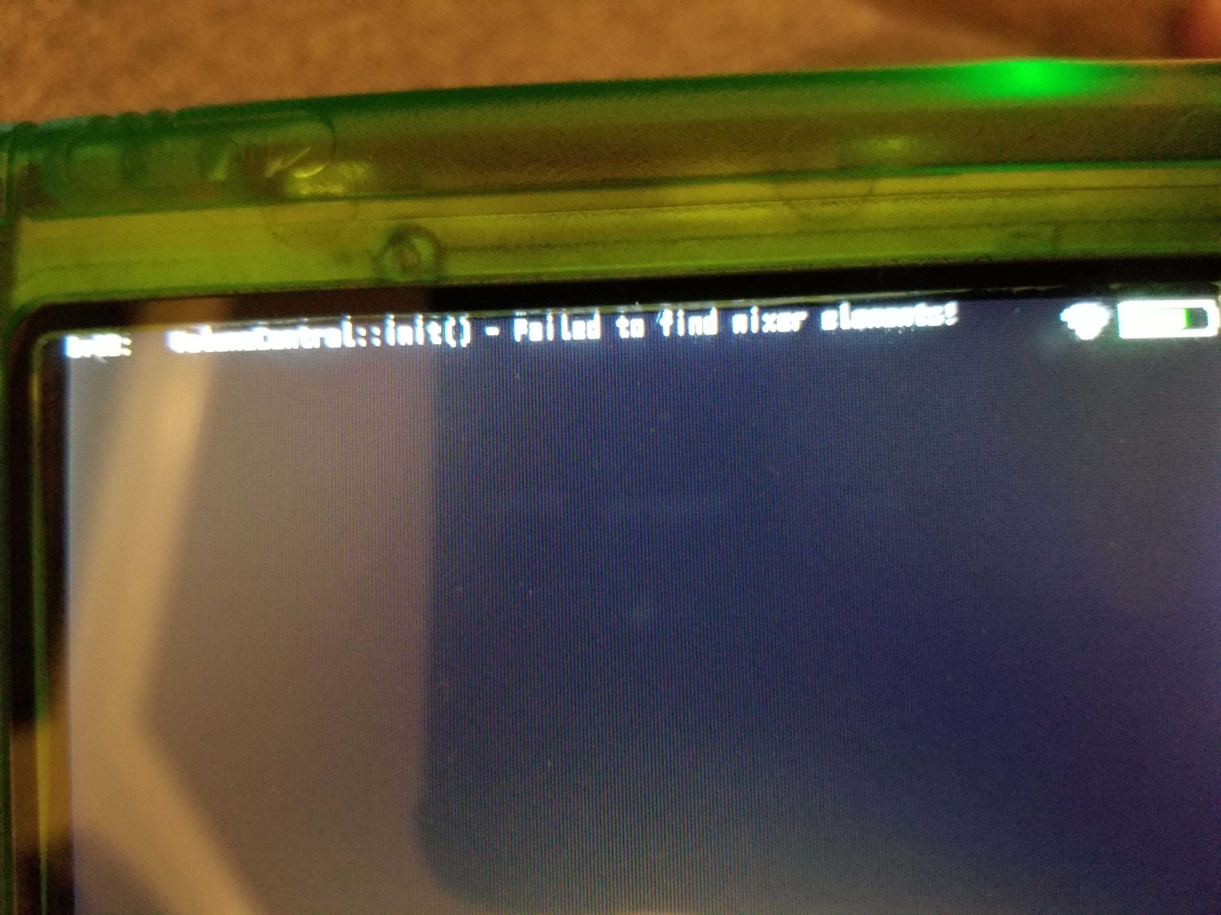

Post by Crainium17 » Tue Dec 10, 2019 8:35 am
Great! Now what ever I did I have no sound in games anymore! Haha this stuff can be tiring!
