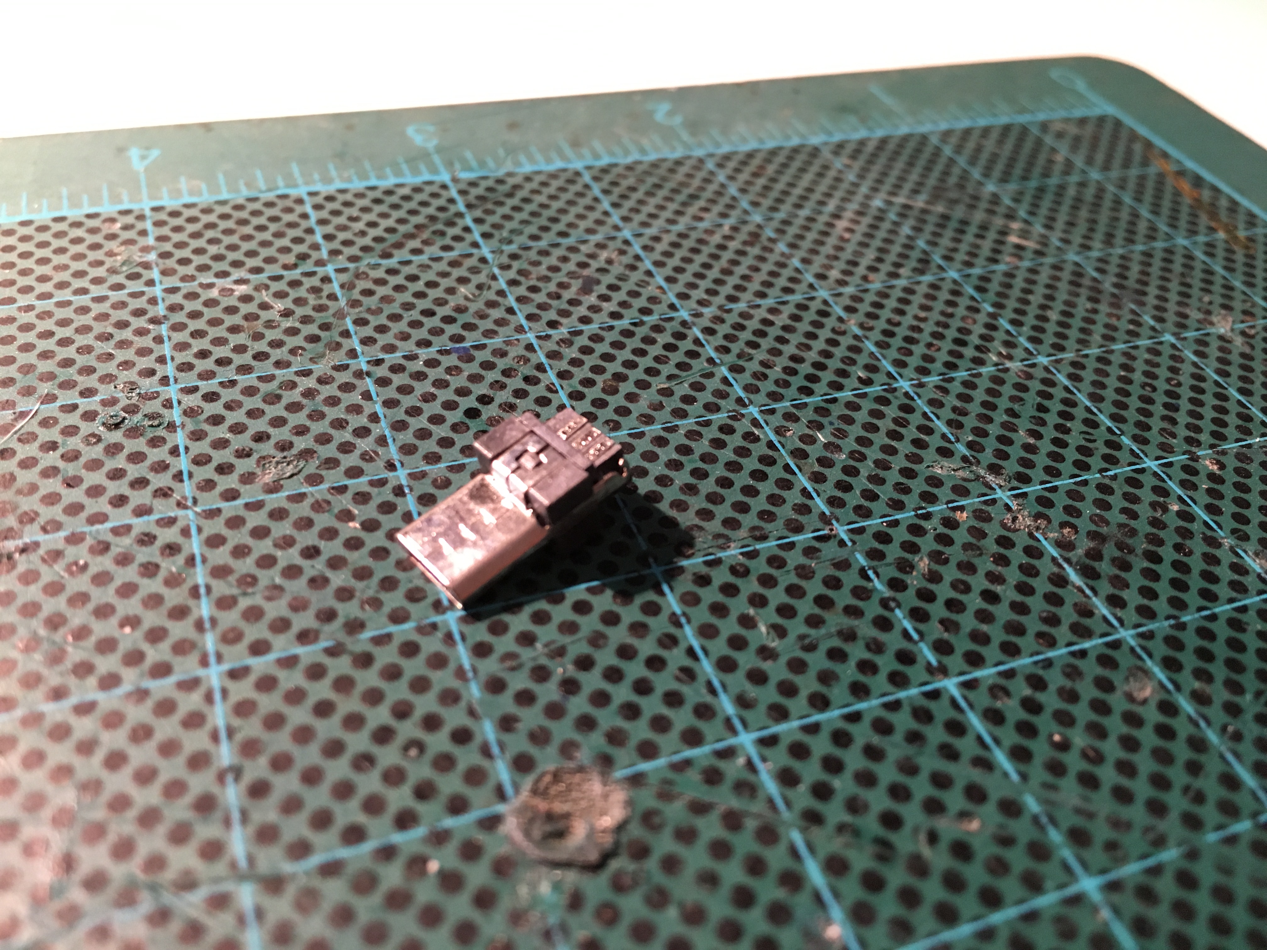

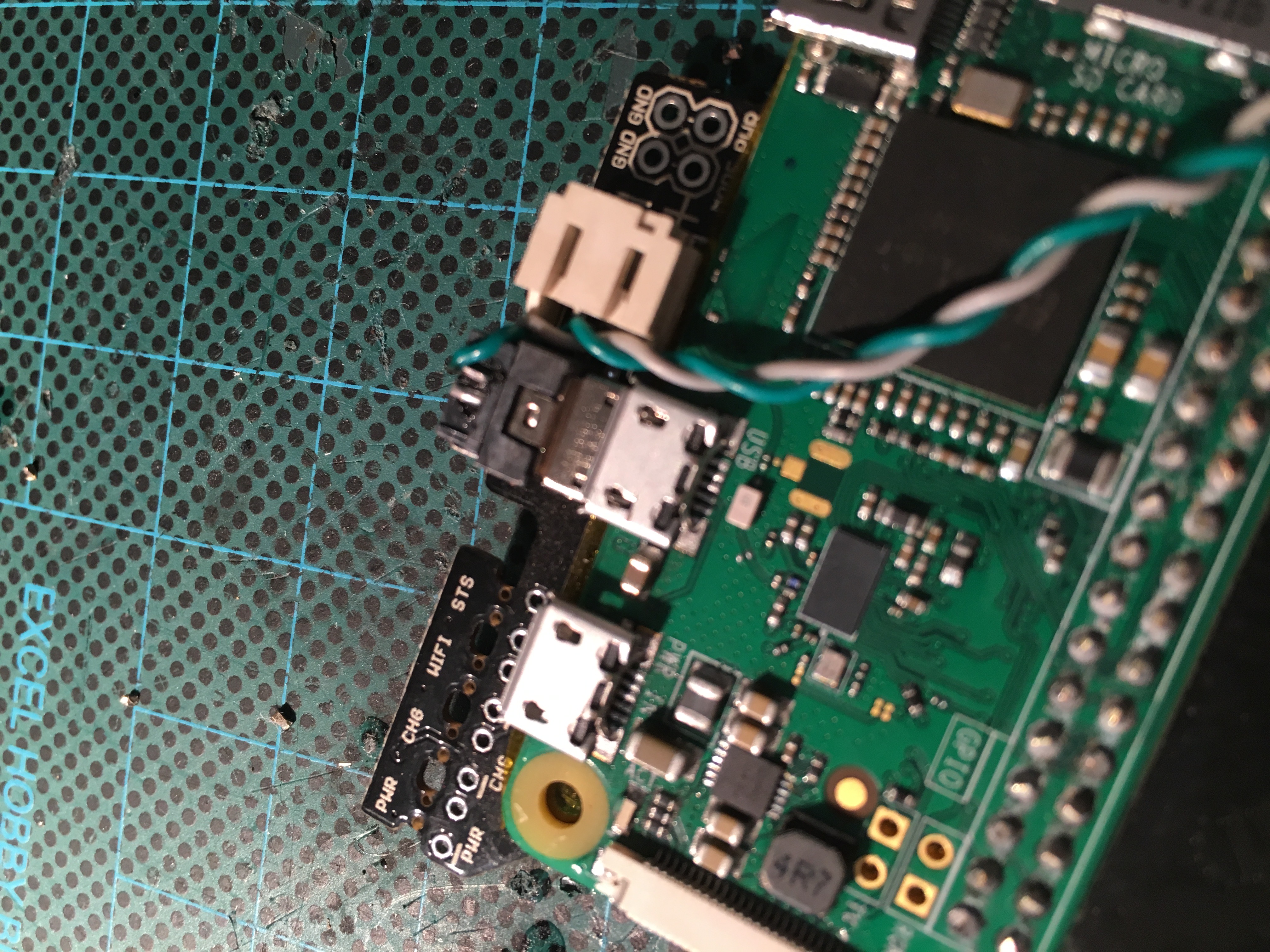

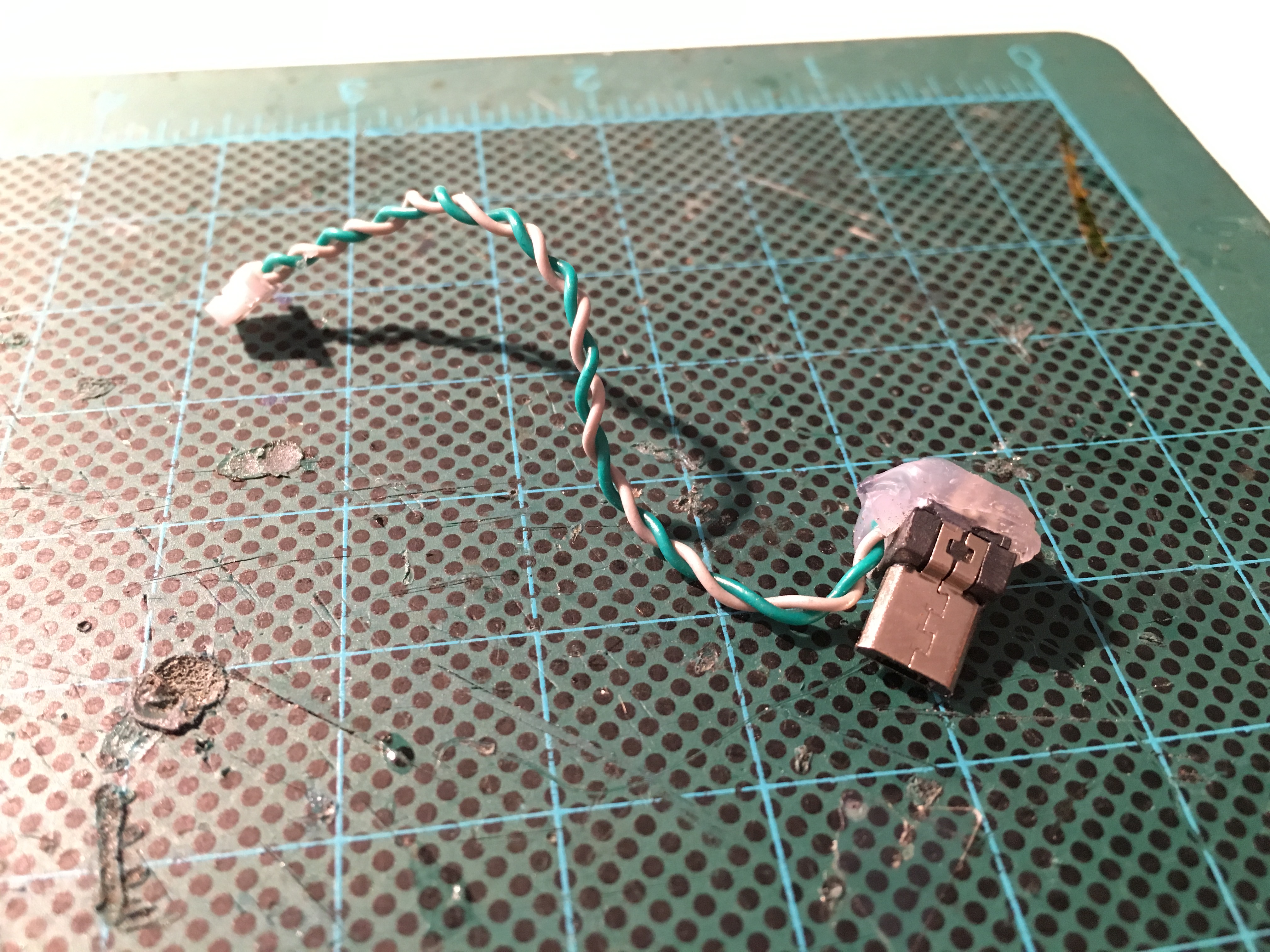

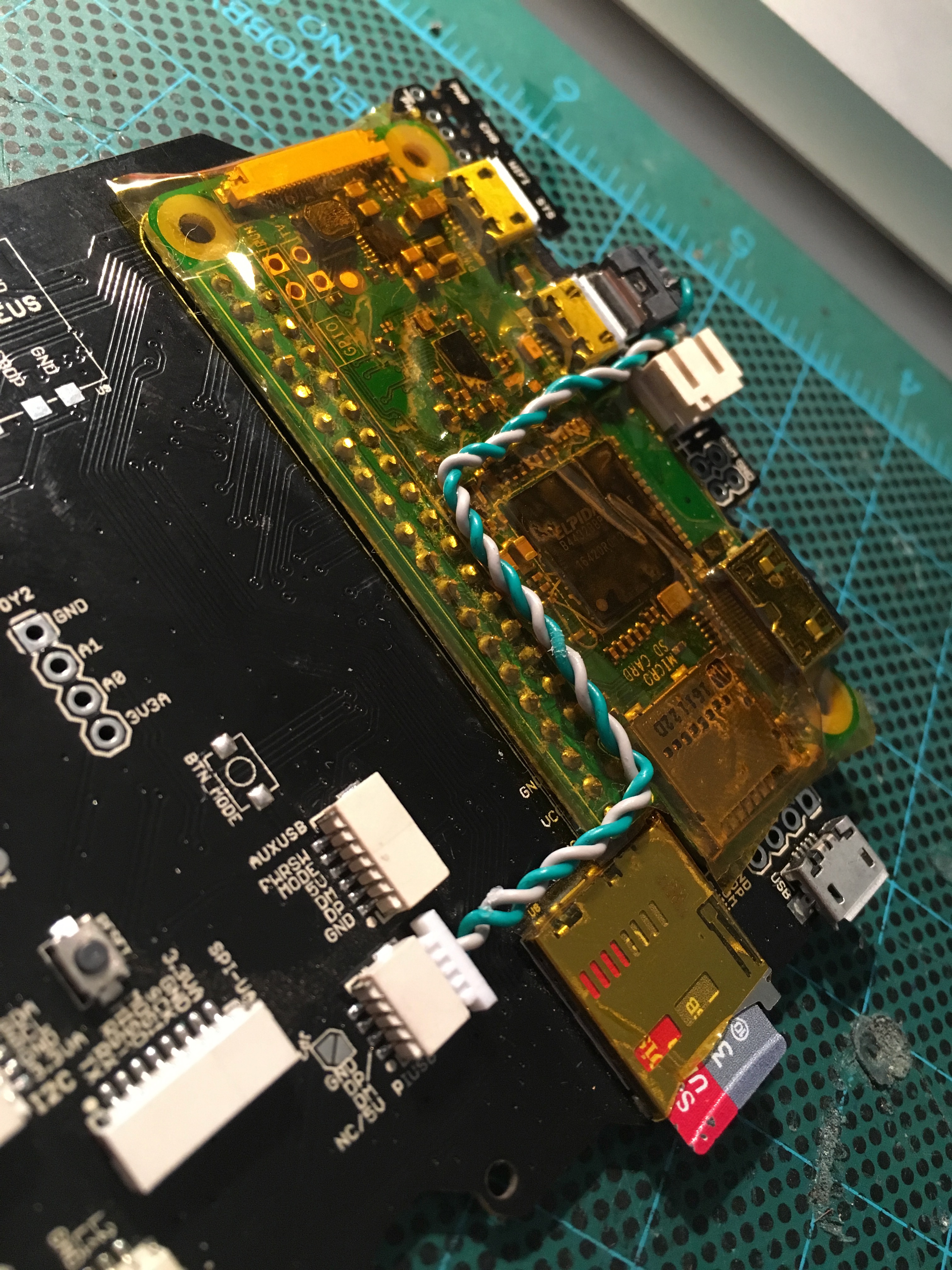

So the good news... ...if you have really F'd up, you will NEVER be able to remove your Pi 0 (unless you have a hot air rework station), and thus i present you my solution. For existing boards, and those not yet built
1. Get yourself some Micro USB DIY kits (they look like this), and you can read all about the pinouts here
2. You ONLY need to connect two wires to the Micro USB (D+ and D-), YES, really
3. Use the USB cable (4 wire JST SH) that comes with @Kite's kit and solder D+ and D-
4. Now connect, the USB micro to the Pi and the other end to the SAIO
5. Clean it up 6. Success Feel free to PM me if you have any questions

So with this method, i don’t need to solder the USB pads from Pi to SAIO ?
Re: Potential fix for USB pad problems
Correct
That this method does is connect the Micro USB dongle to the SAIO board via the 4 pin USB Hub connector provided in the kit
