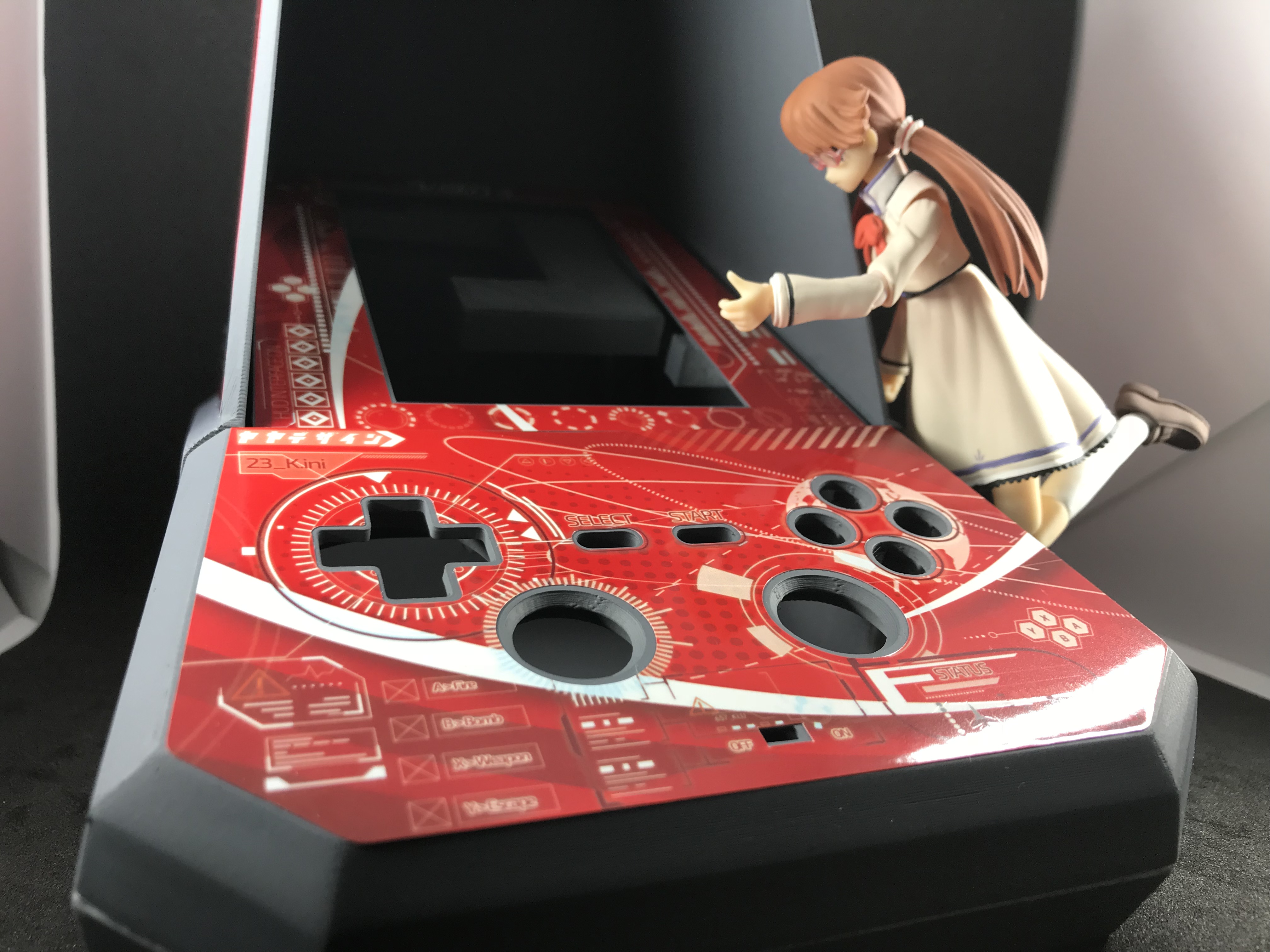

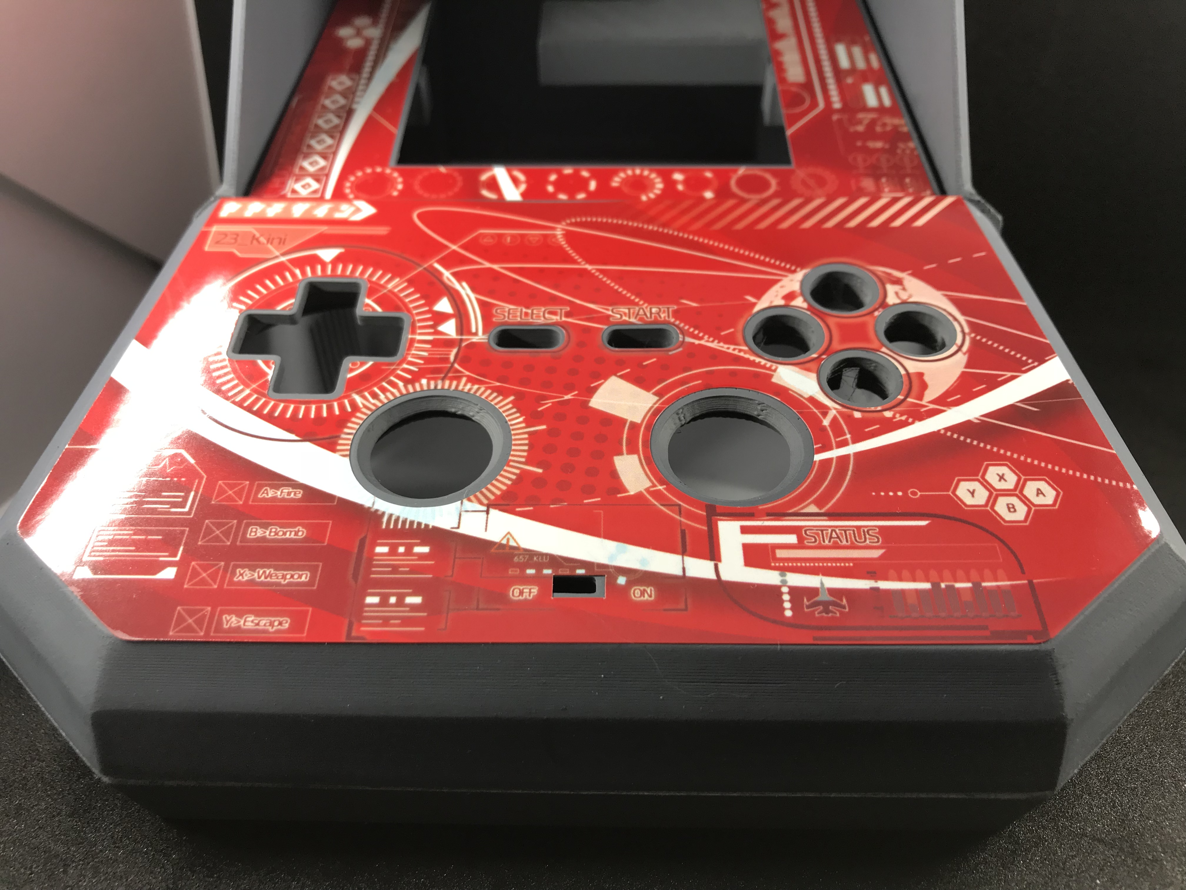

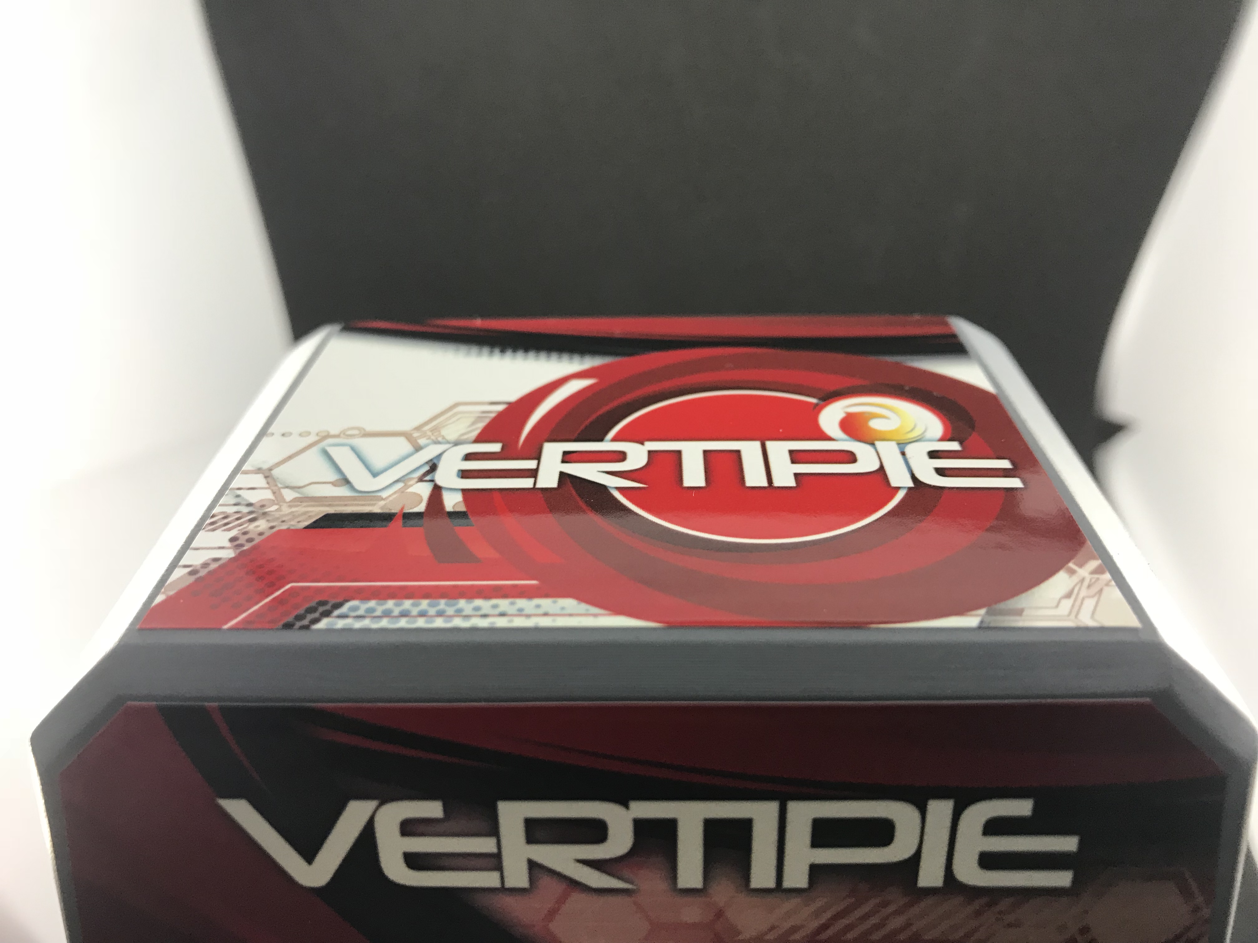

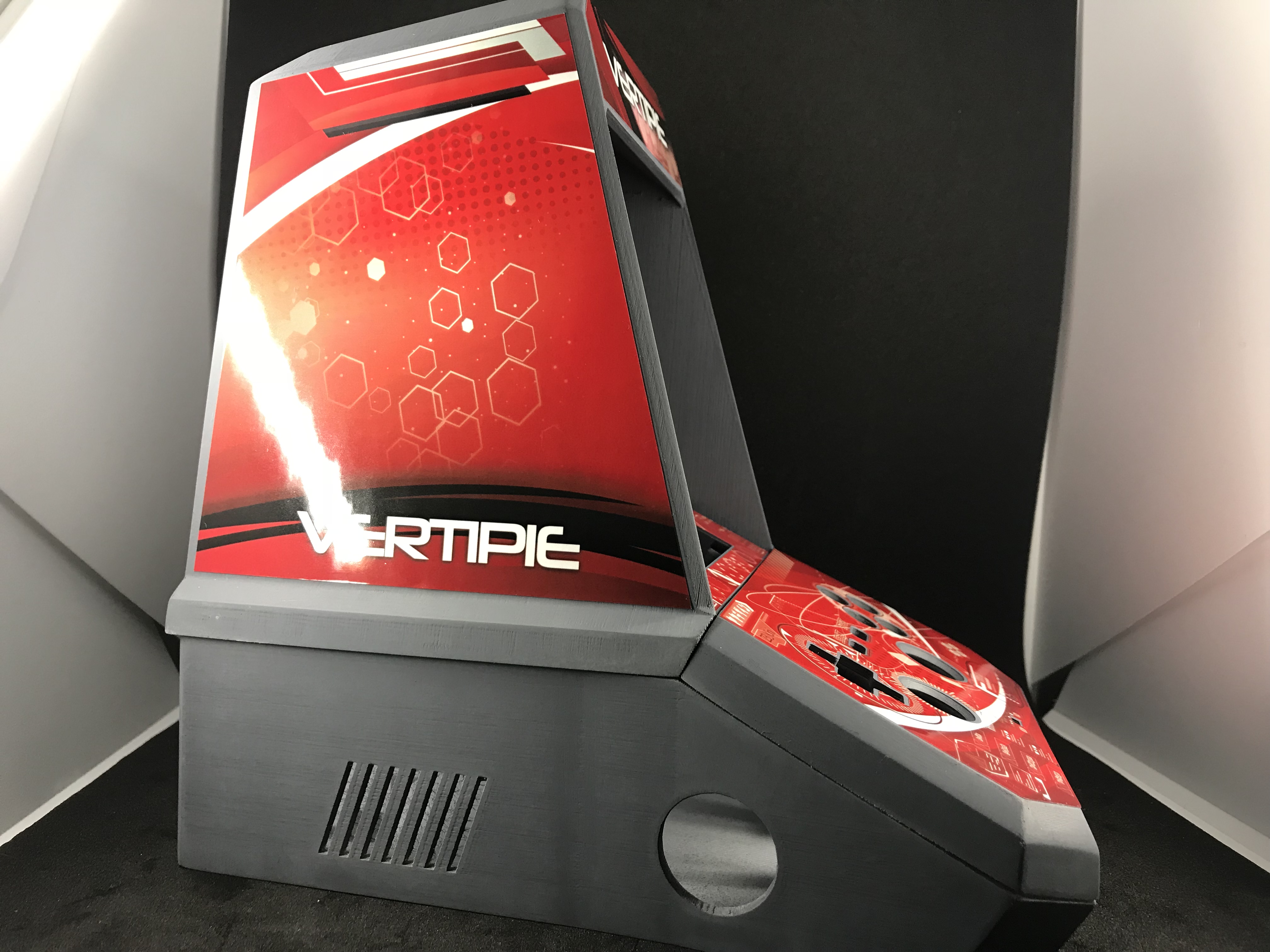

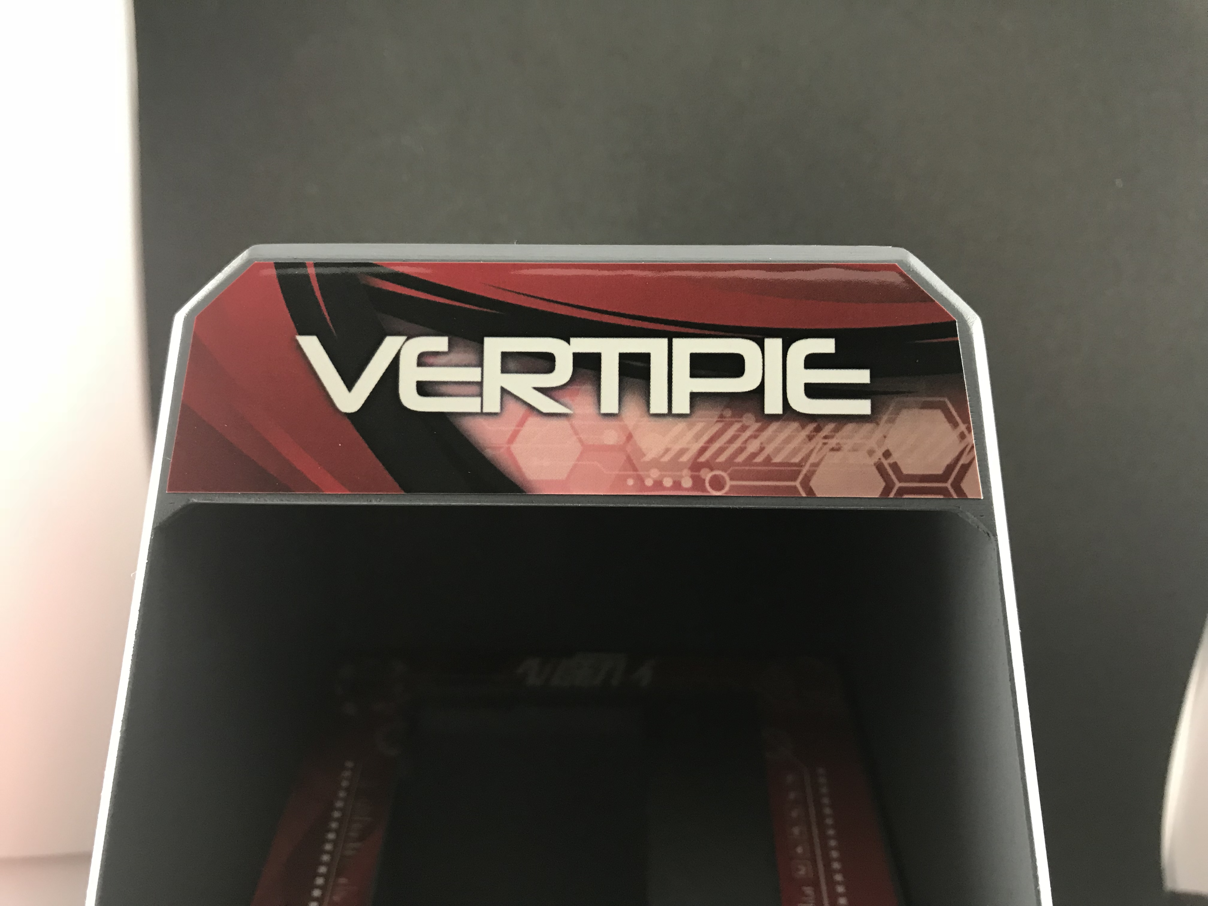

I’ve ordered some decals and the result is perfect.
You can now buy them from my shop.

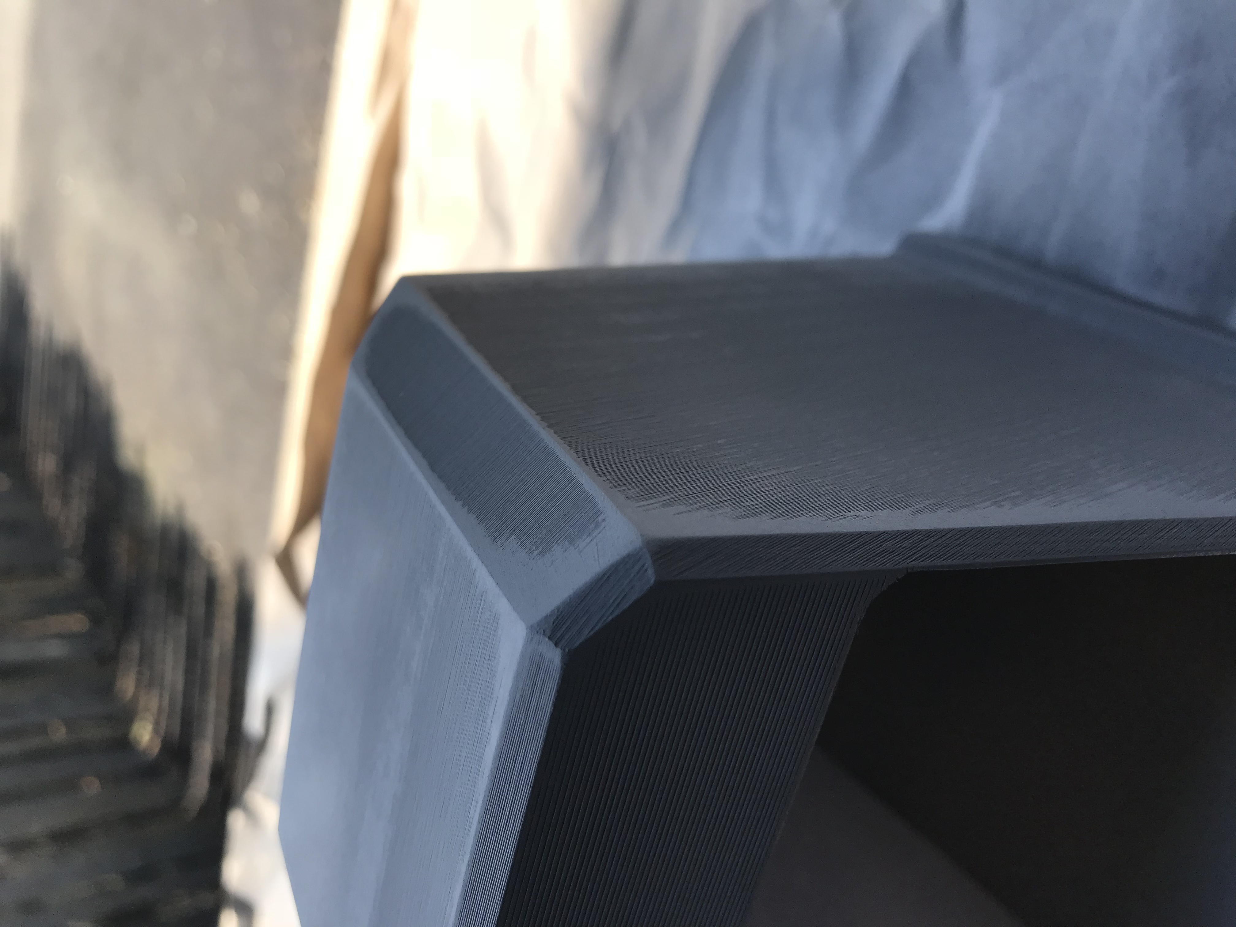

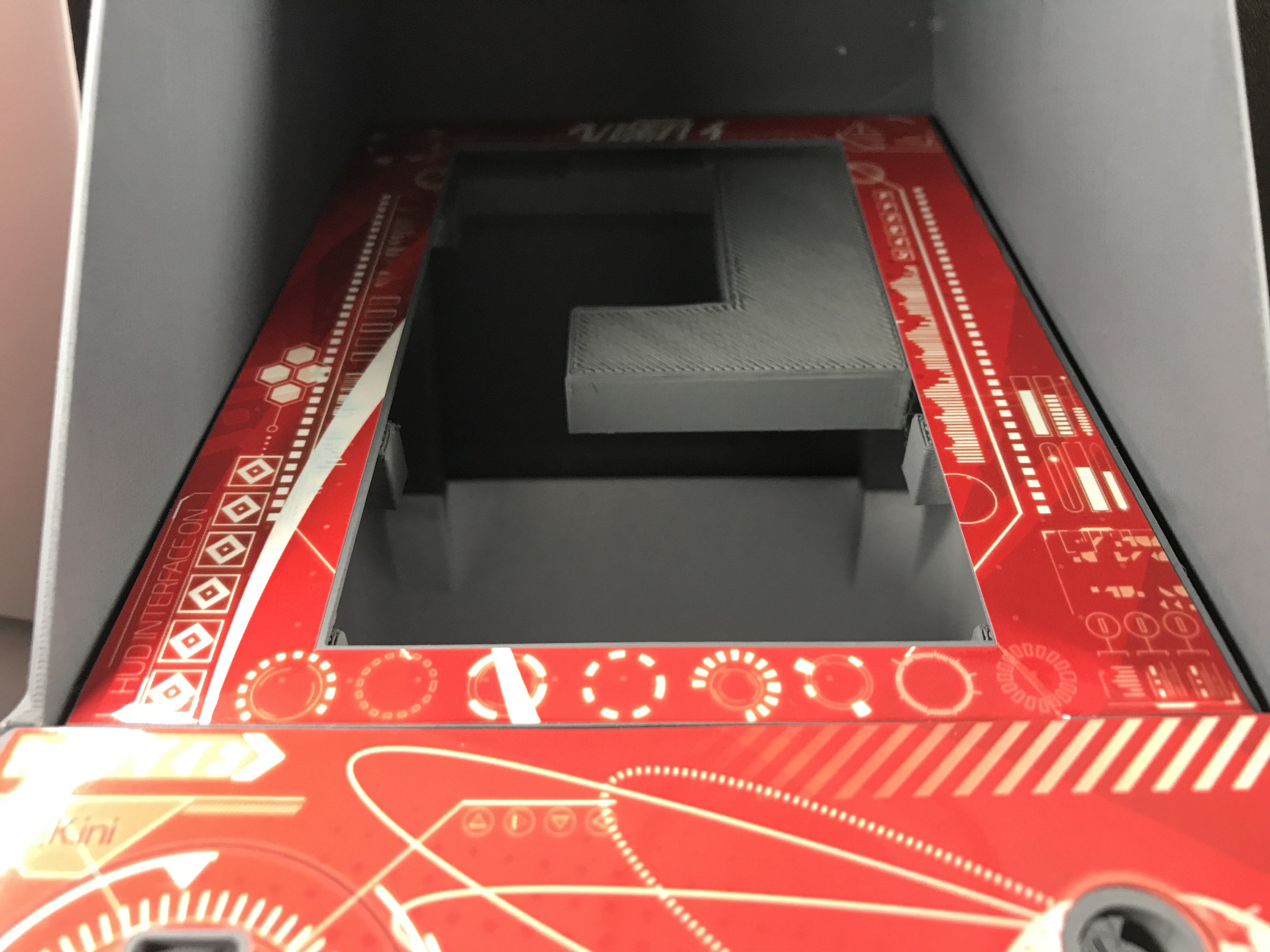

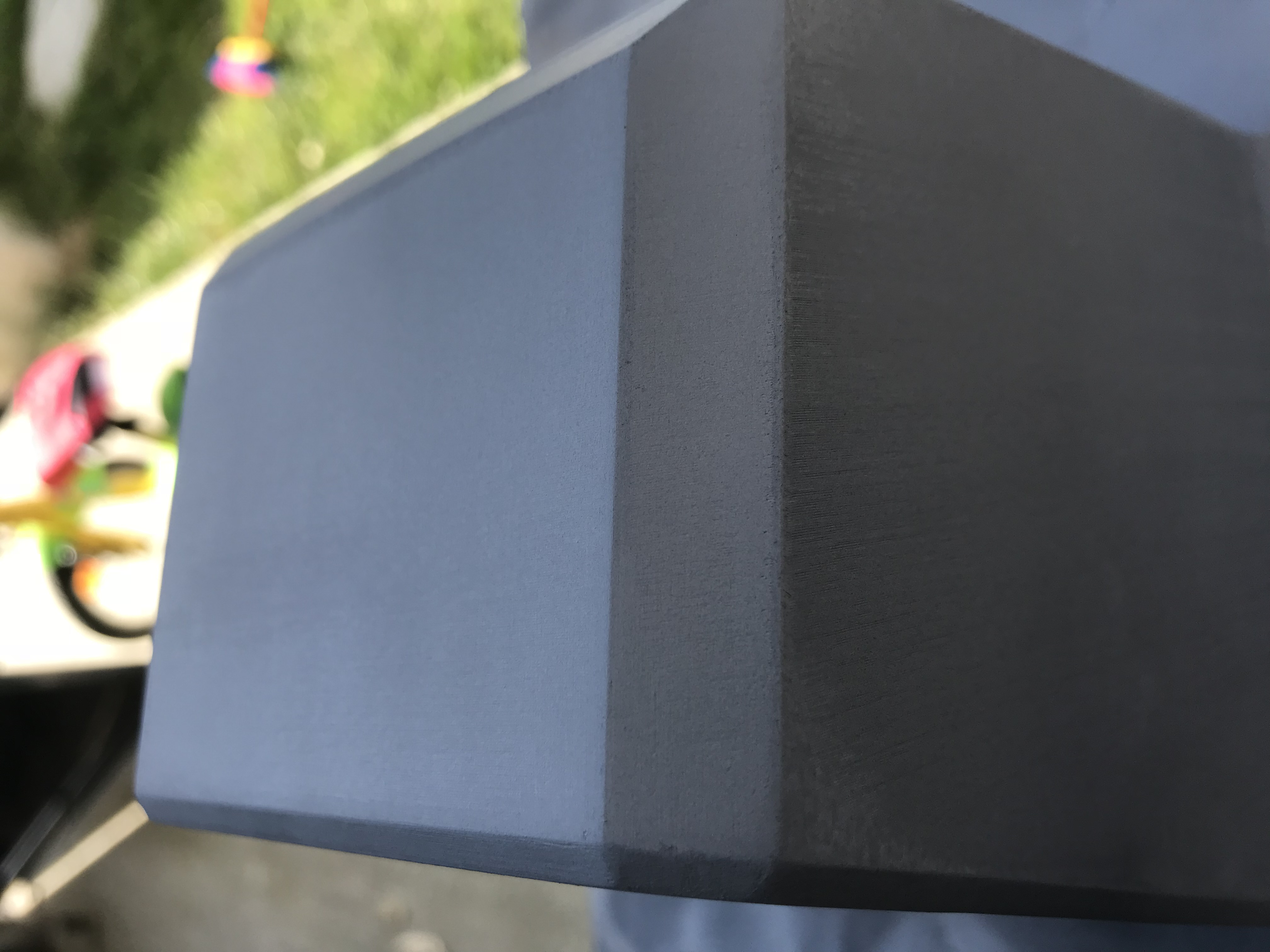

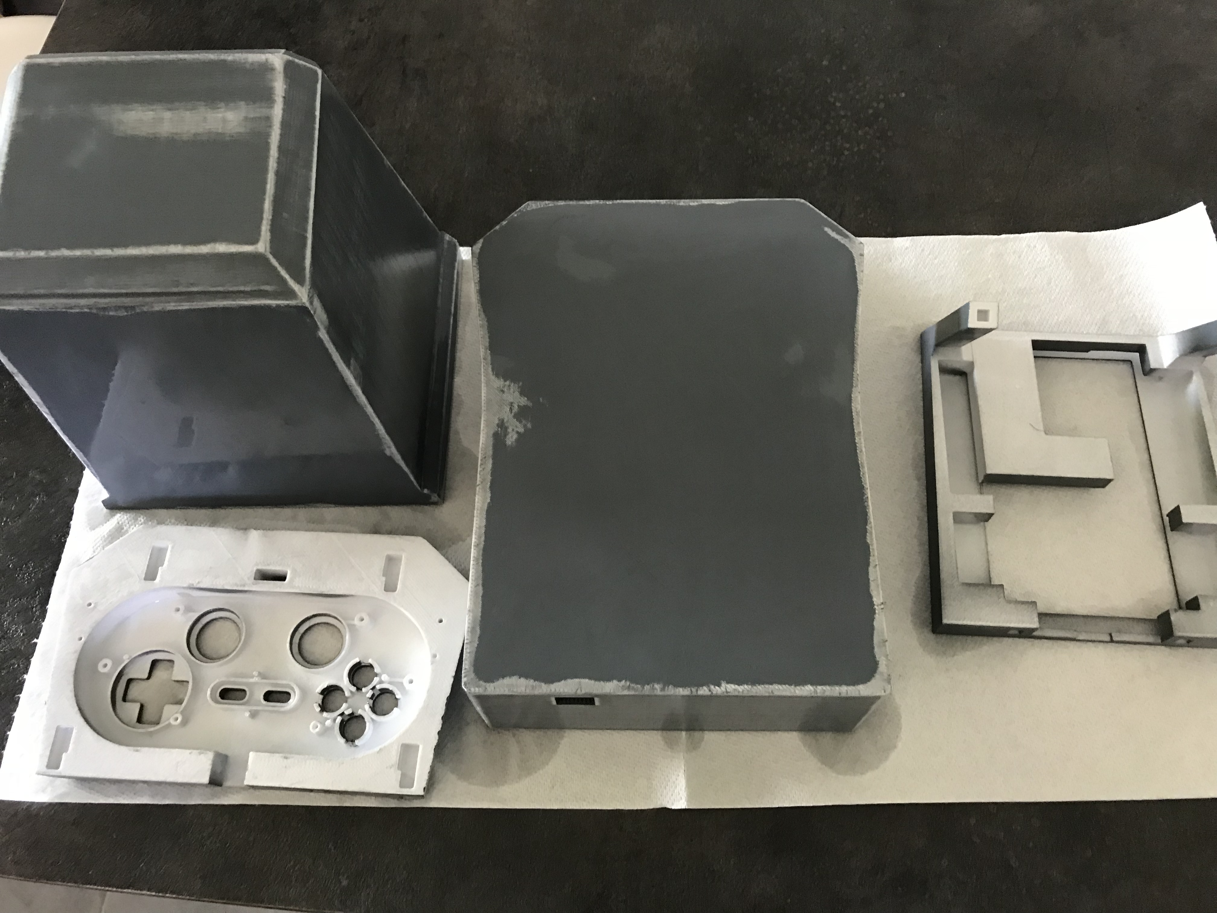

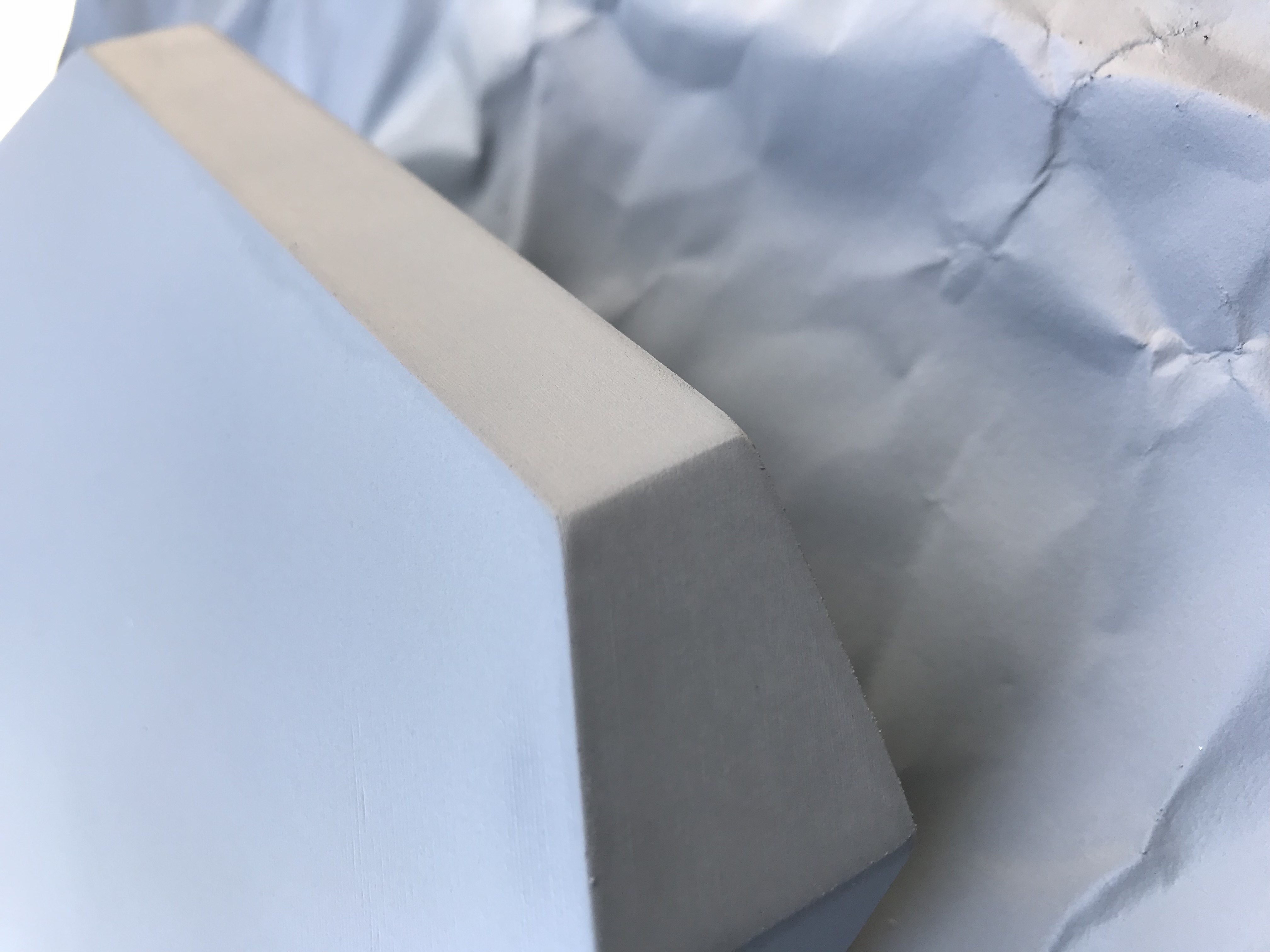

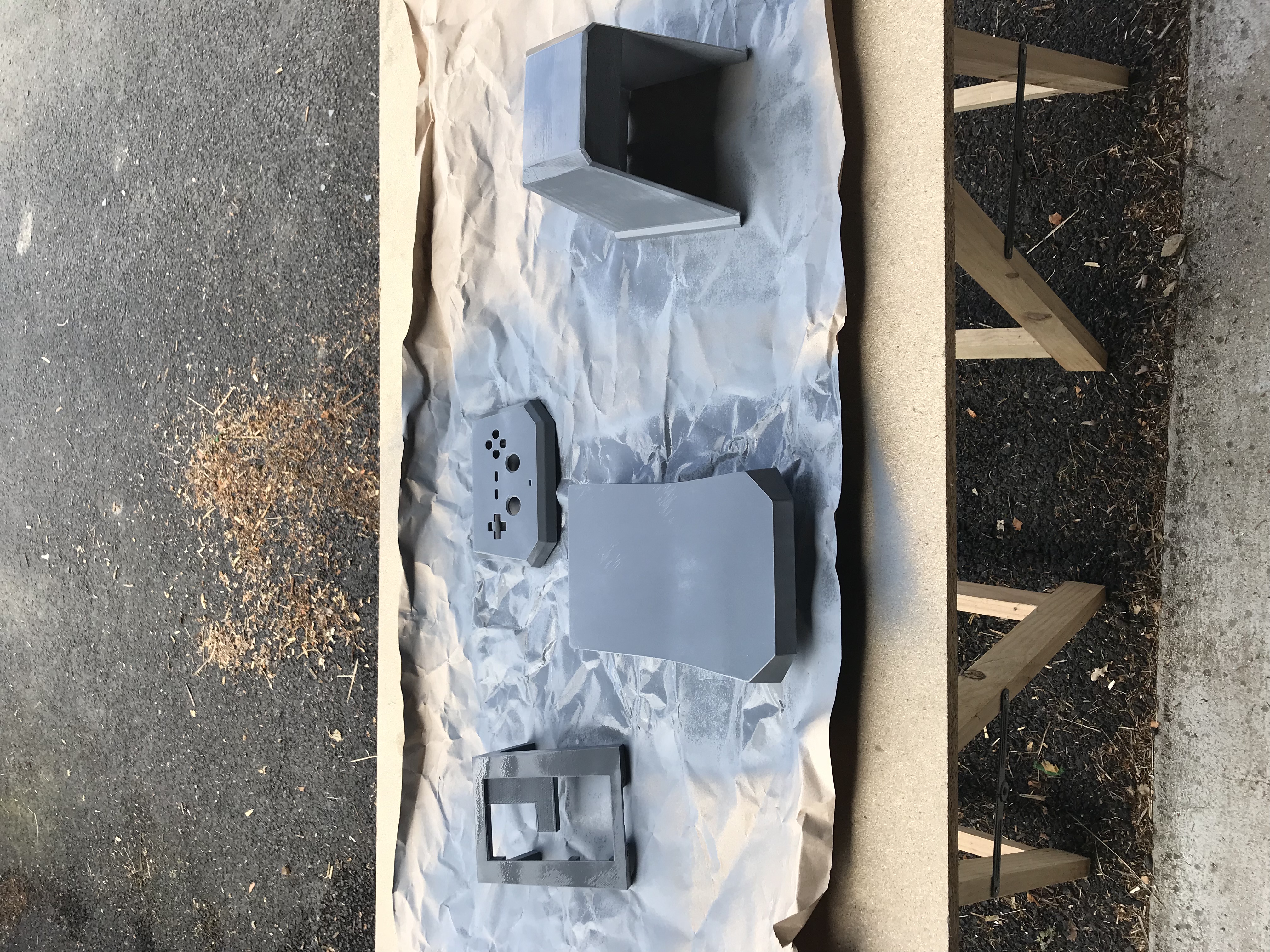

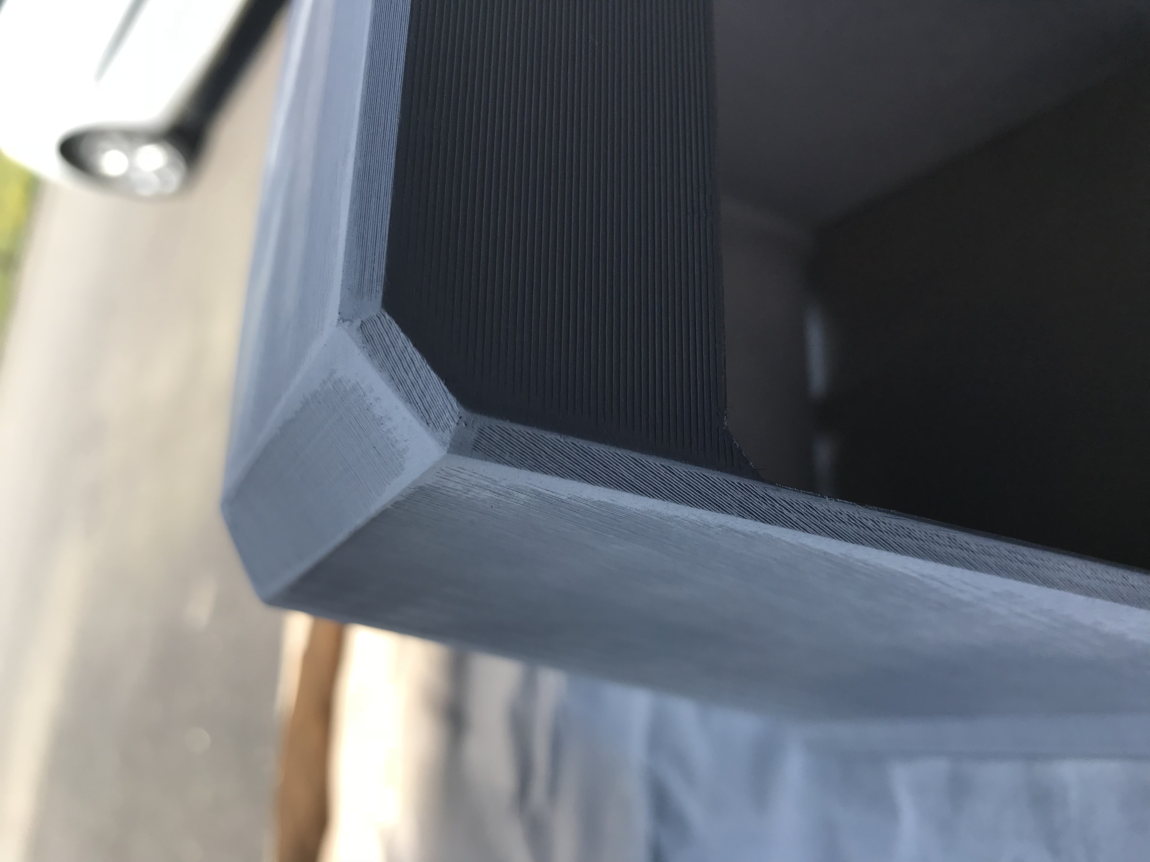

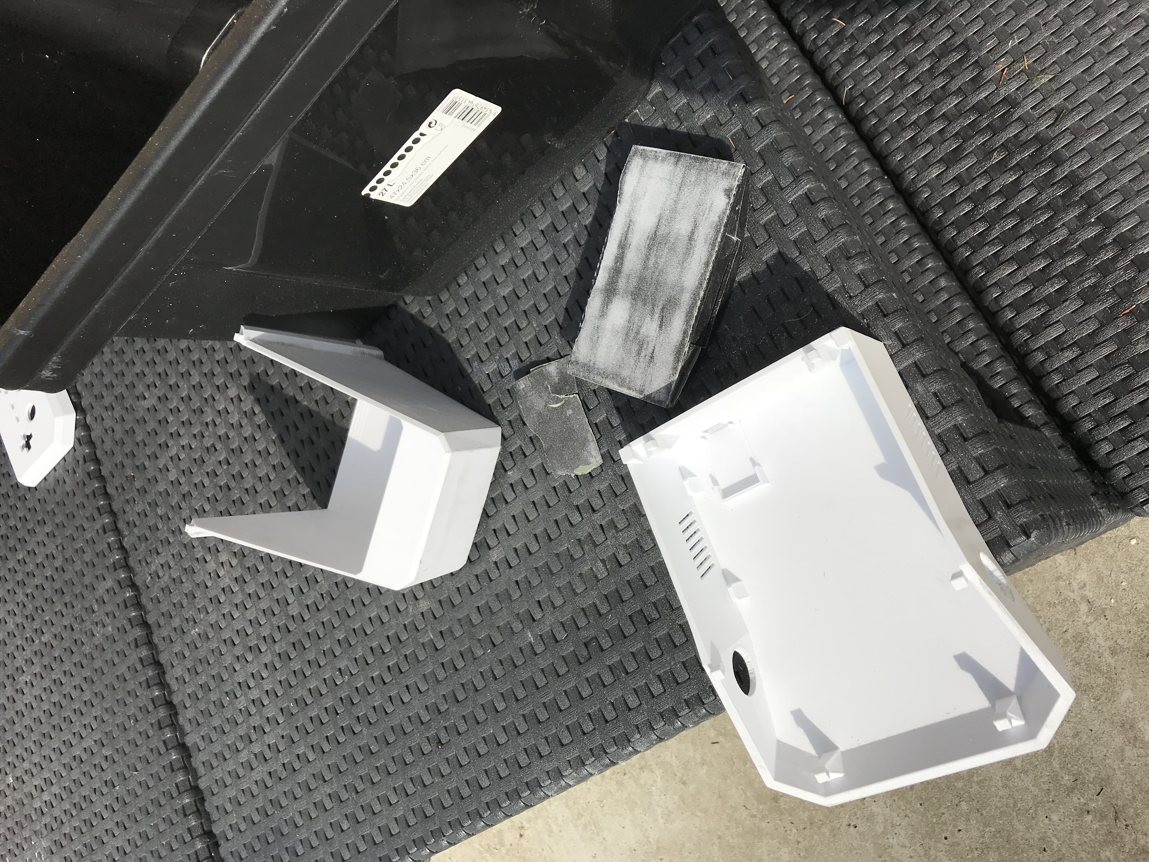

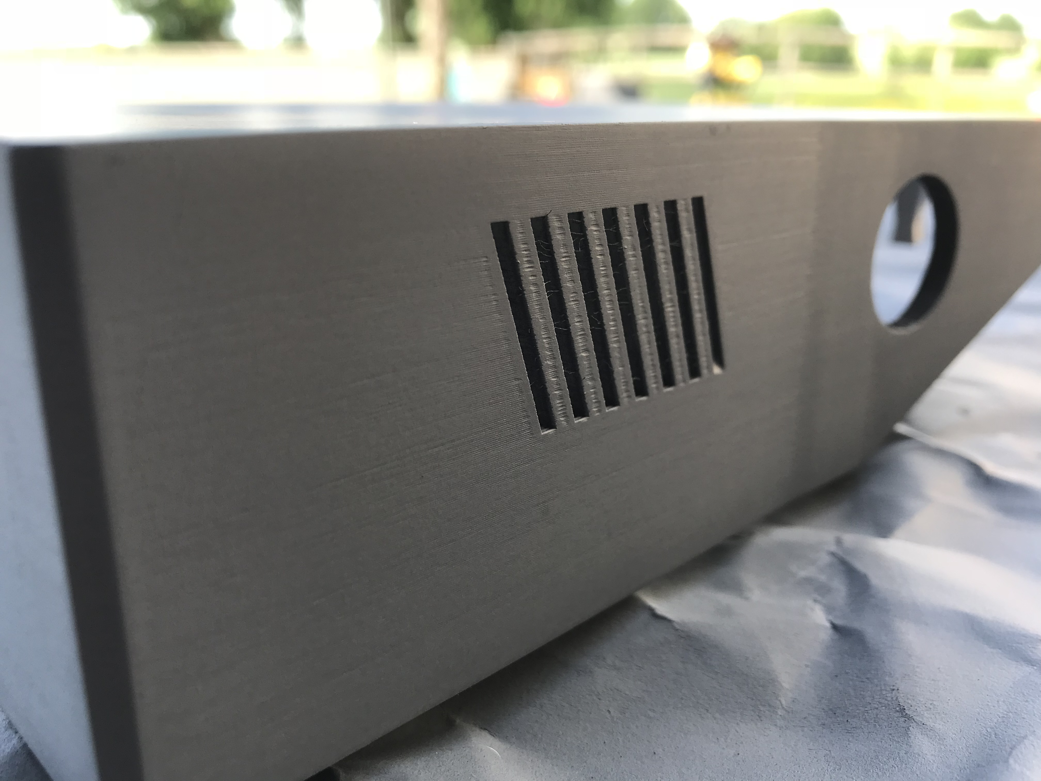

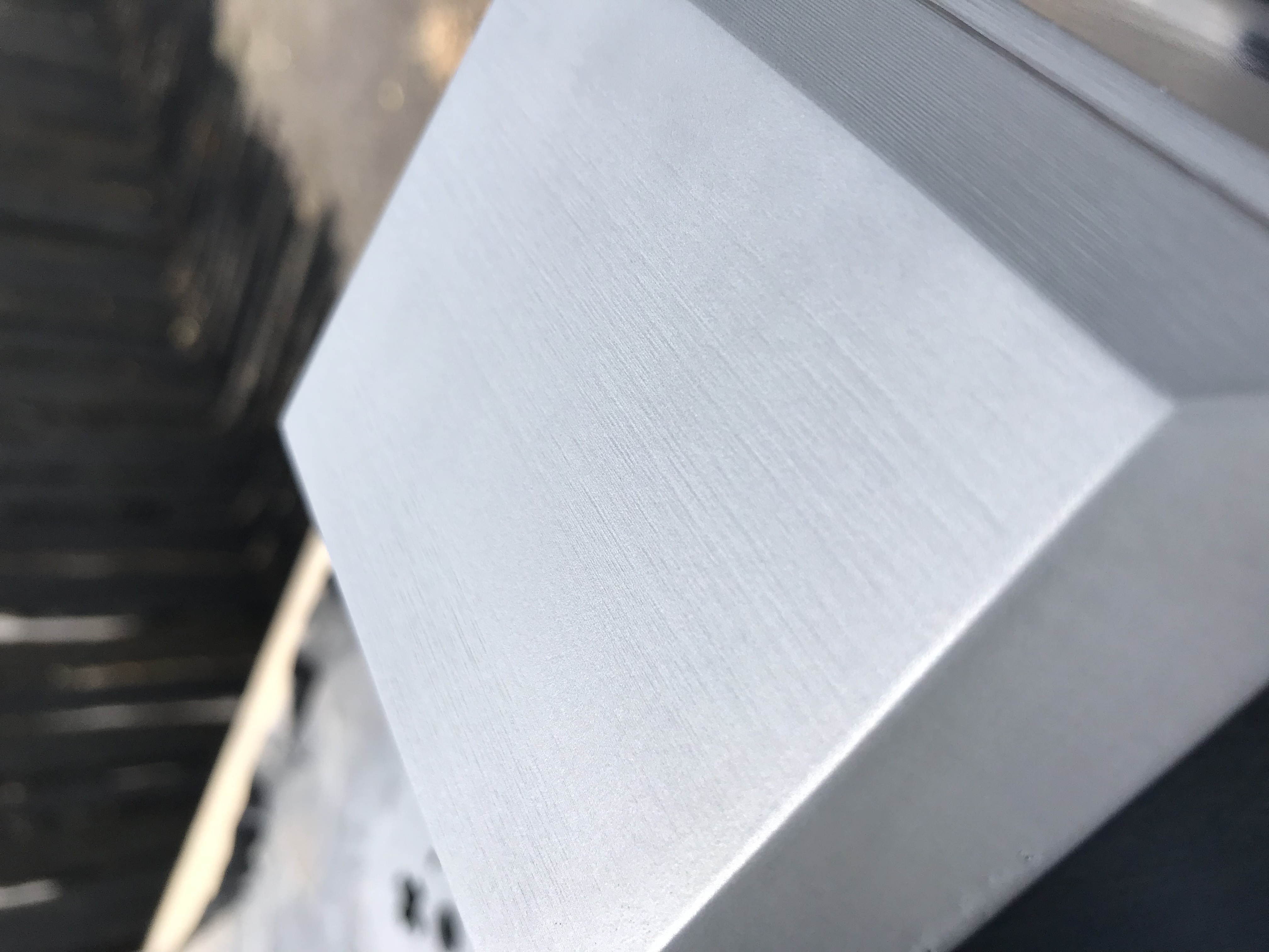

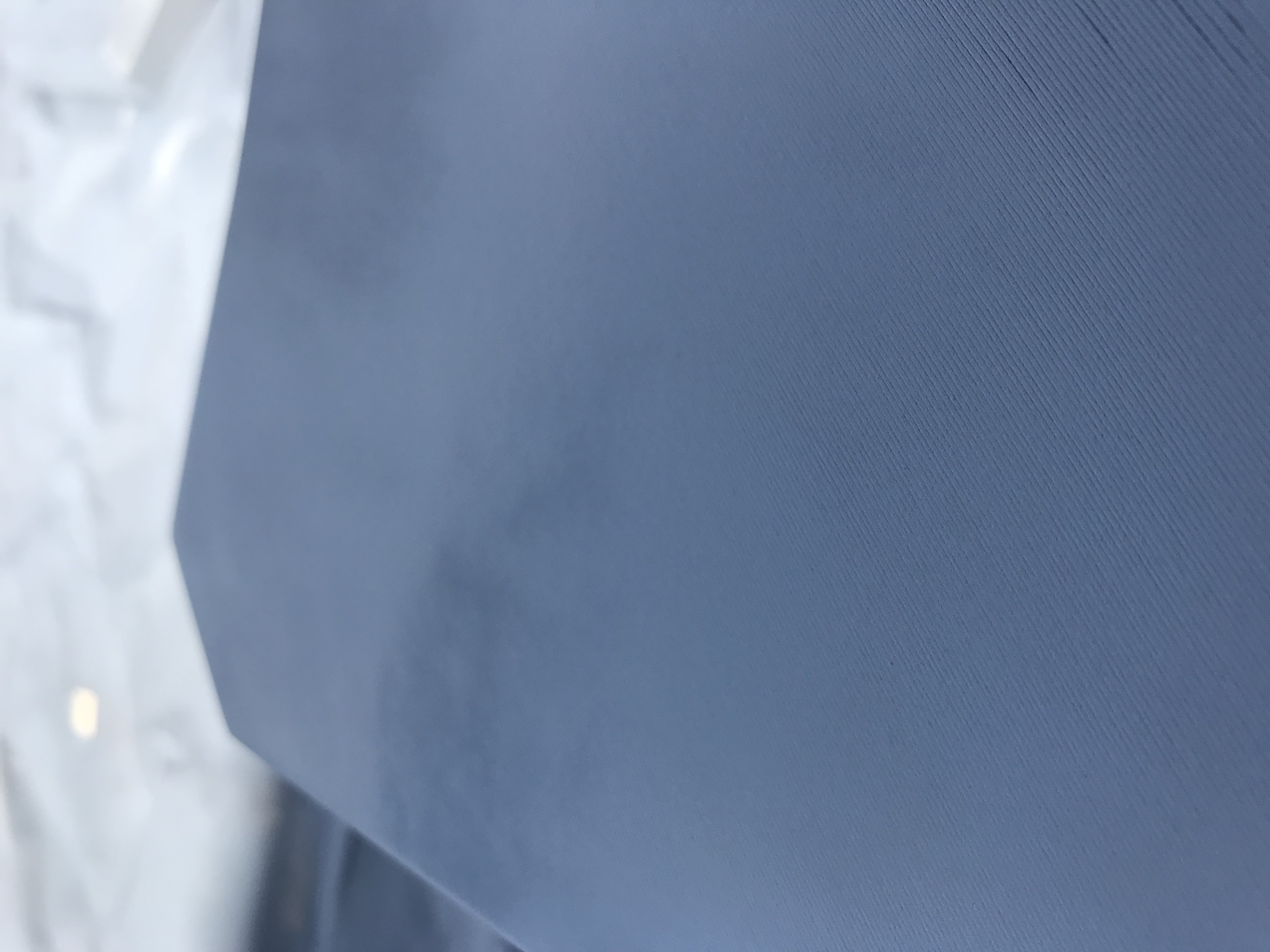

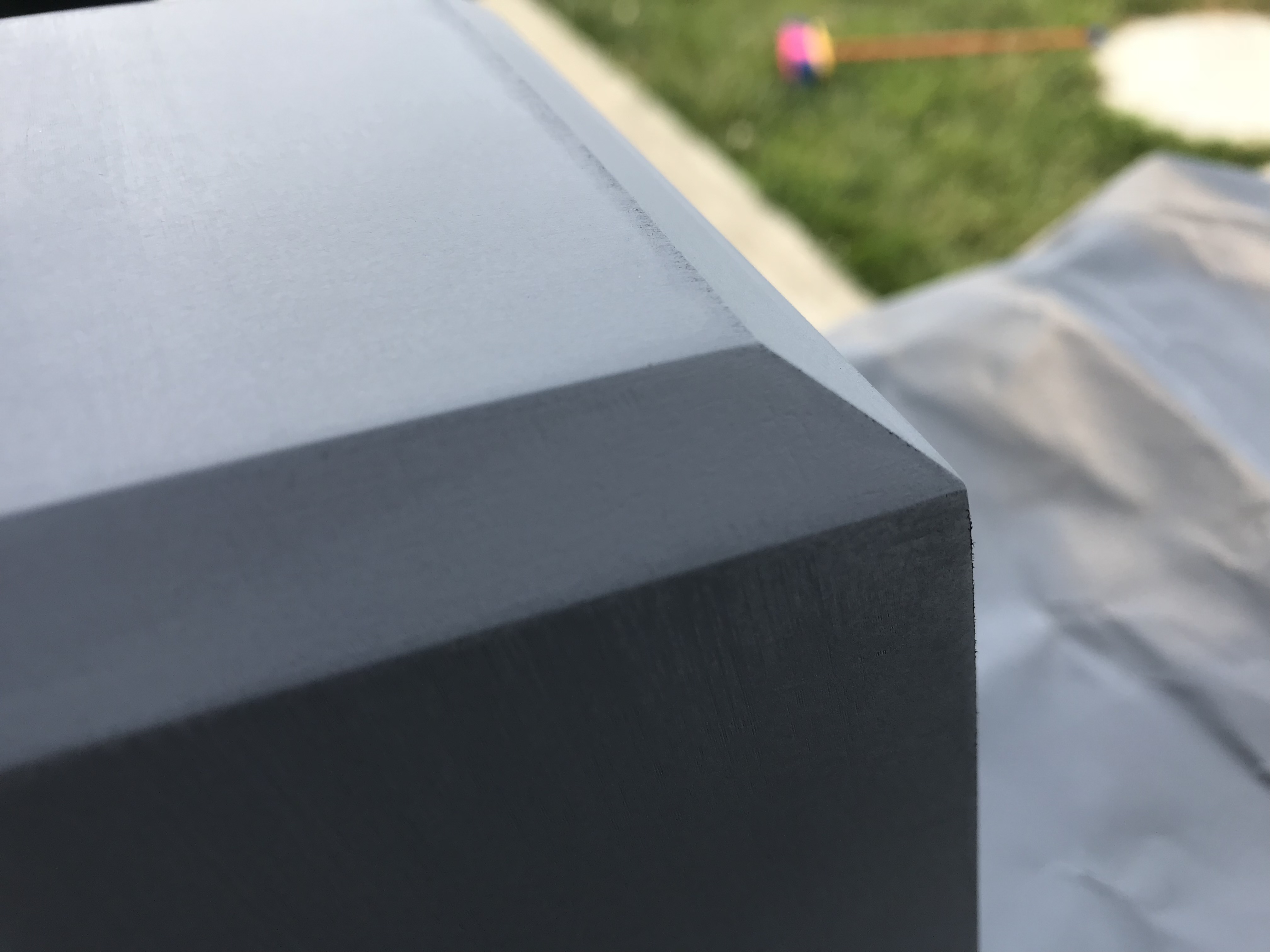

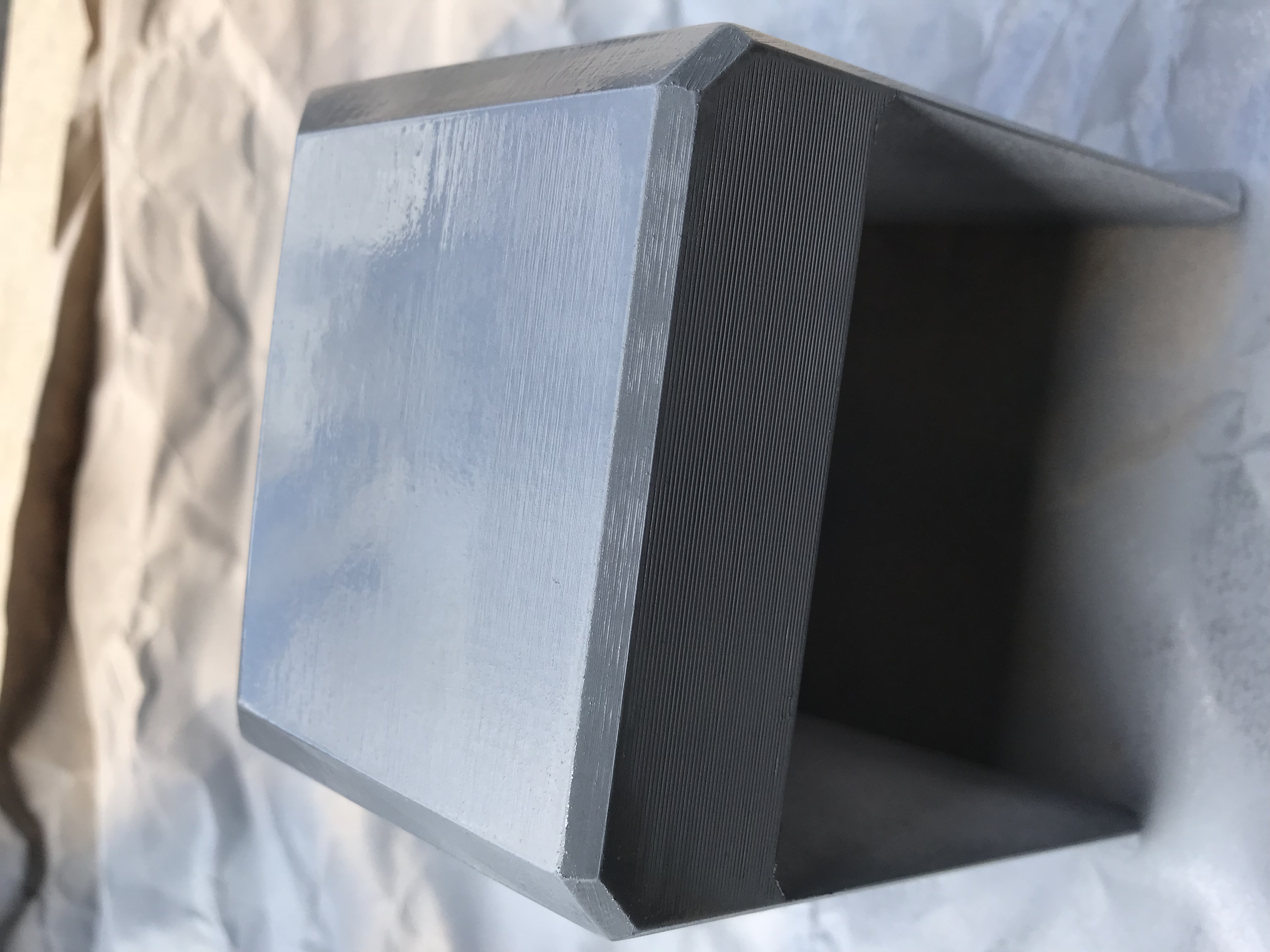

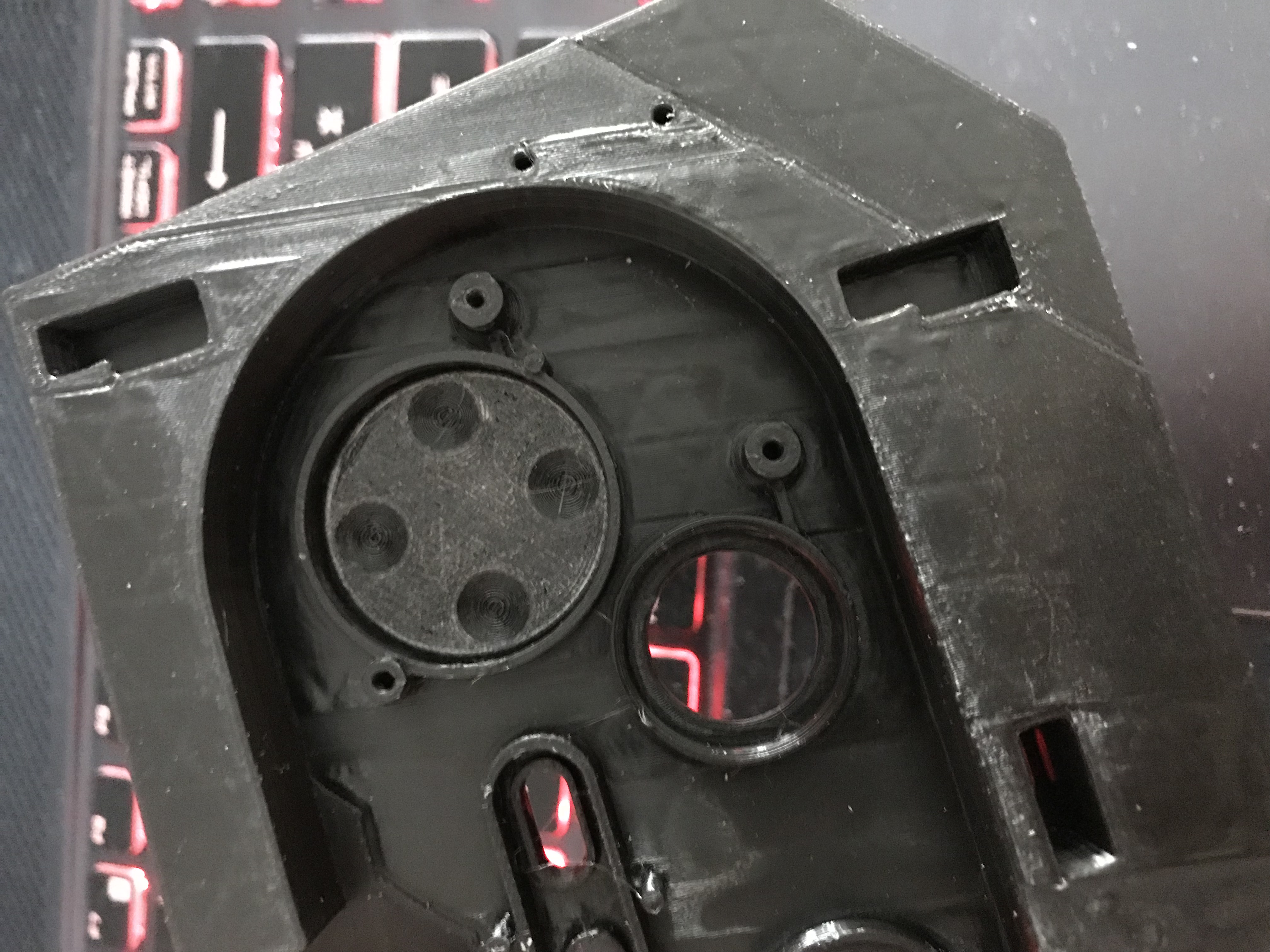

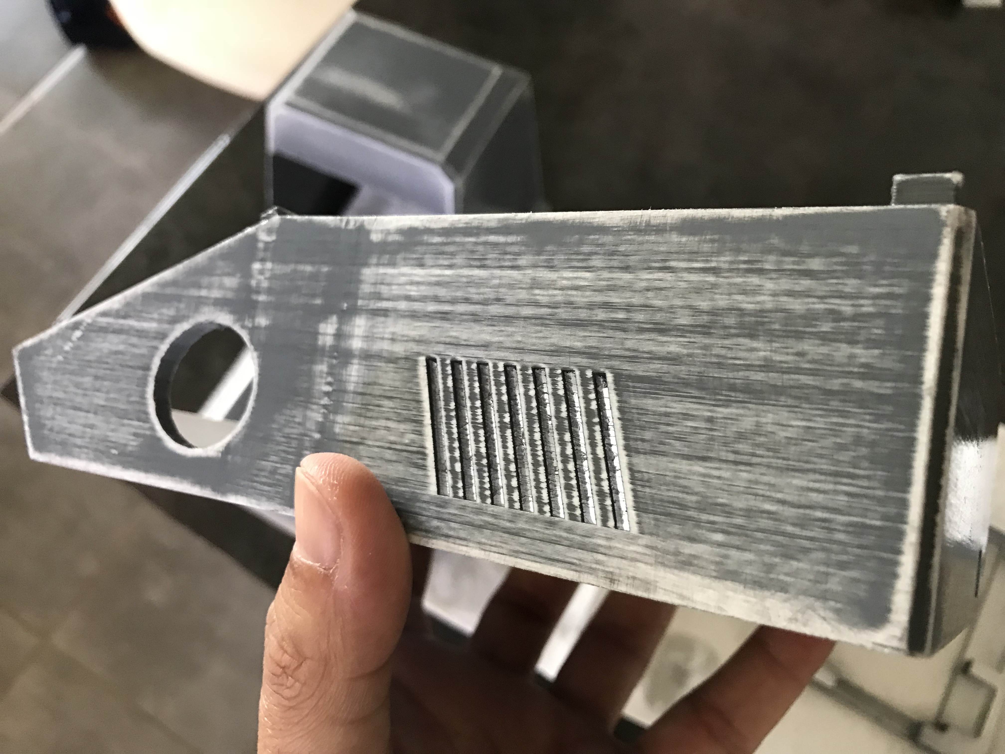

The case was sanded and primed/ filled 4 times with 200 grade sand paper and a professional automotive grade filler.
The result is awesome. The pictures are taken at diffrent stages of passes.
The thinner you’ll print, the less work you’ll have.

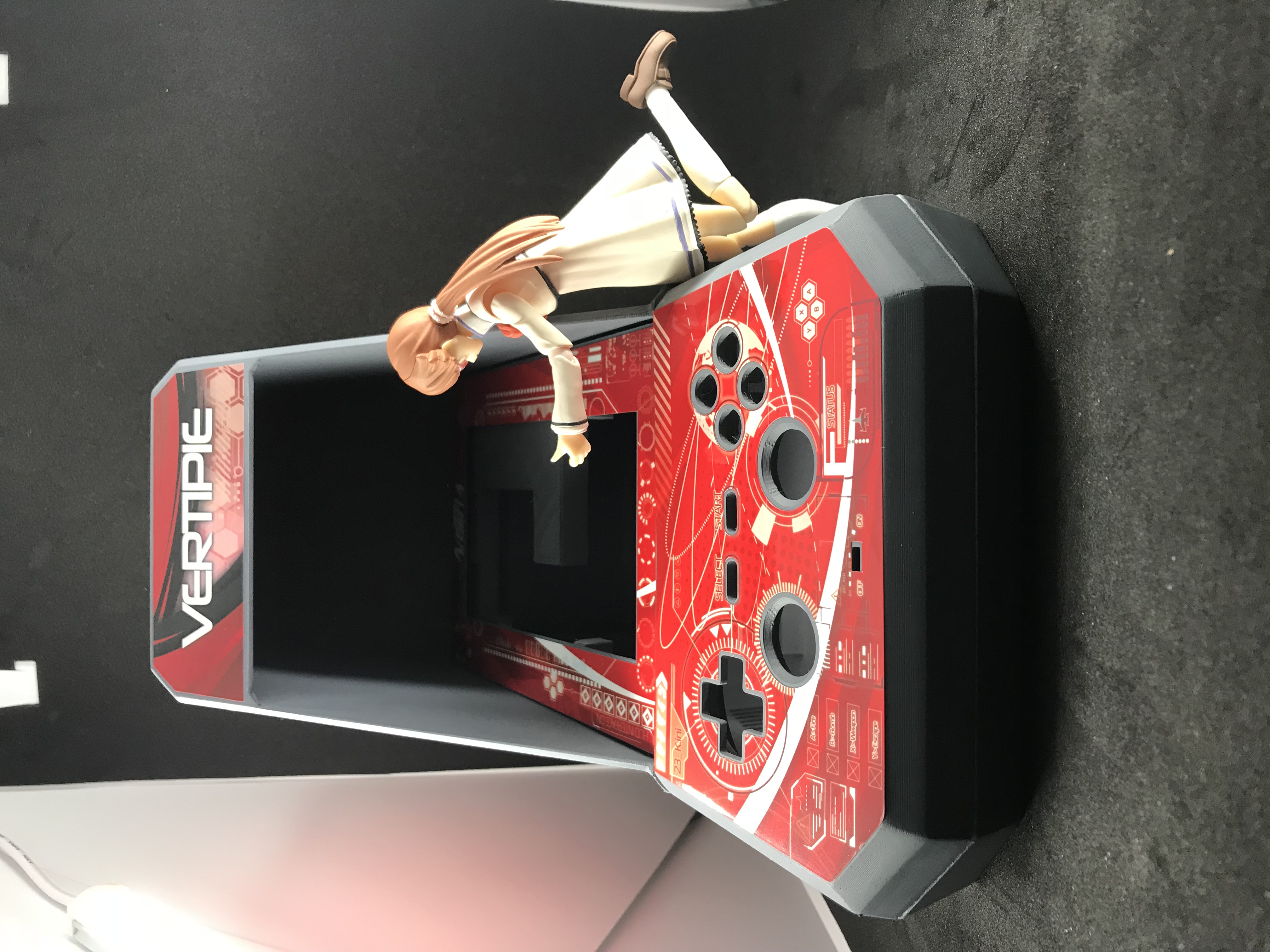

Initially, i should have painted the case after preparing it but i received the stickers while finishing the priming and as i had preordres on the stickers, i’ve quickly made a testing (see photos above) and as the result is perfect with that color combination, i left it as it :lol:

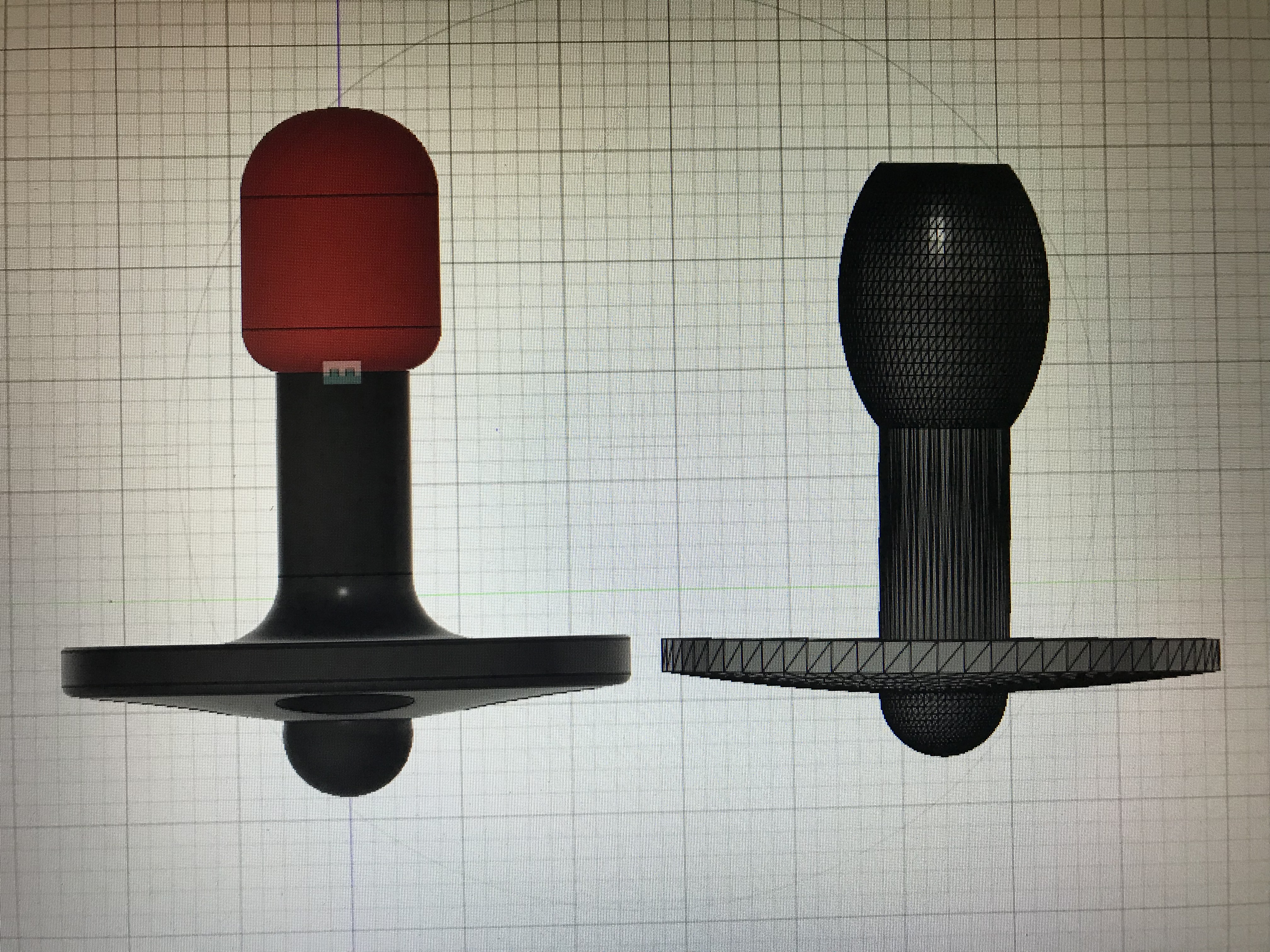

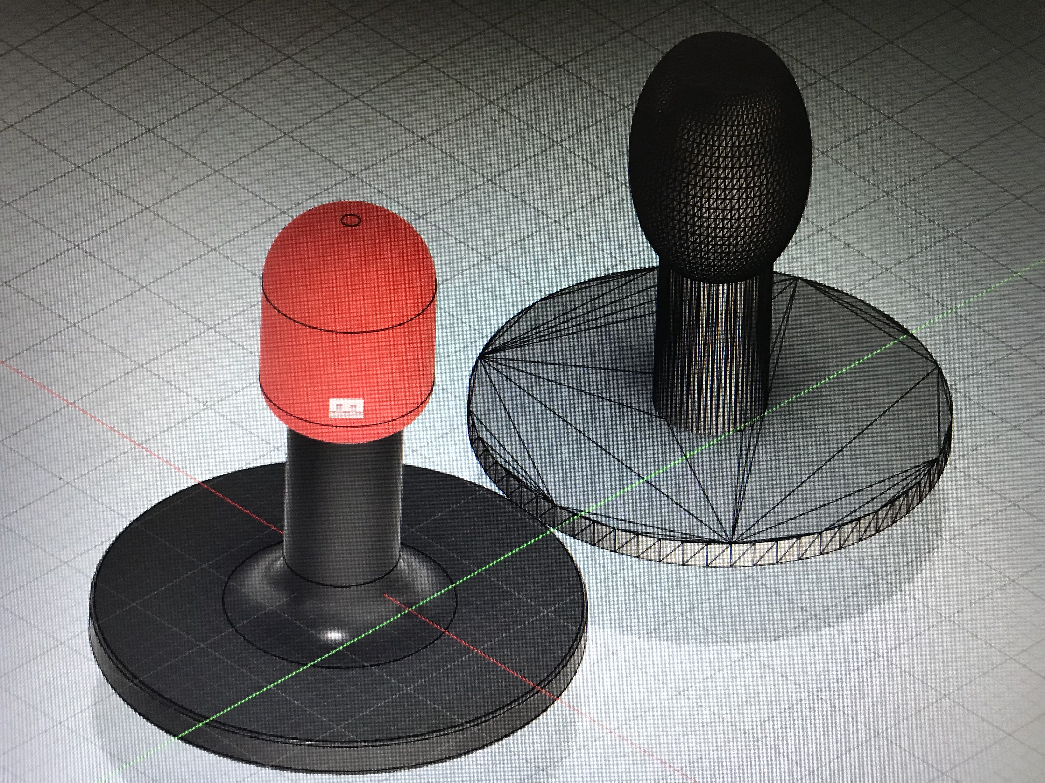

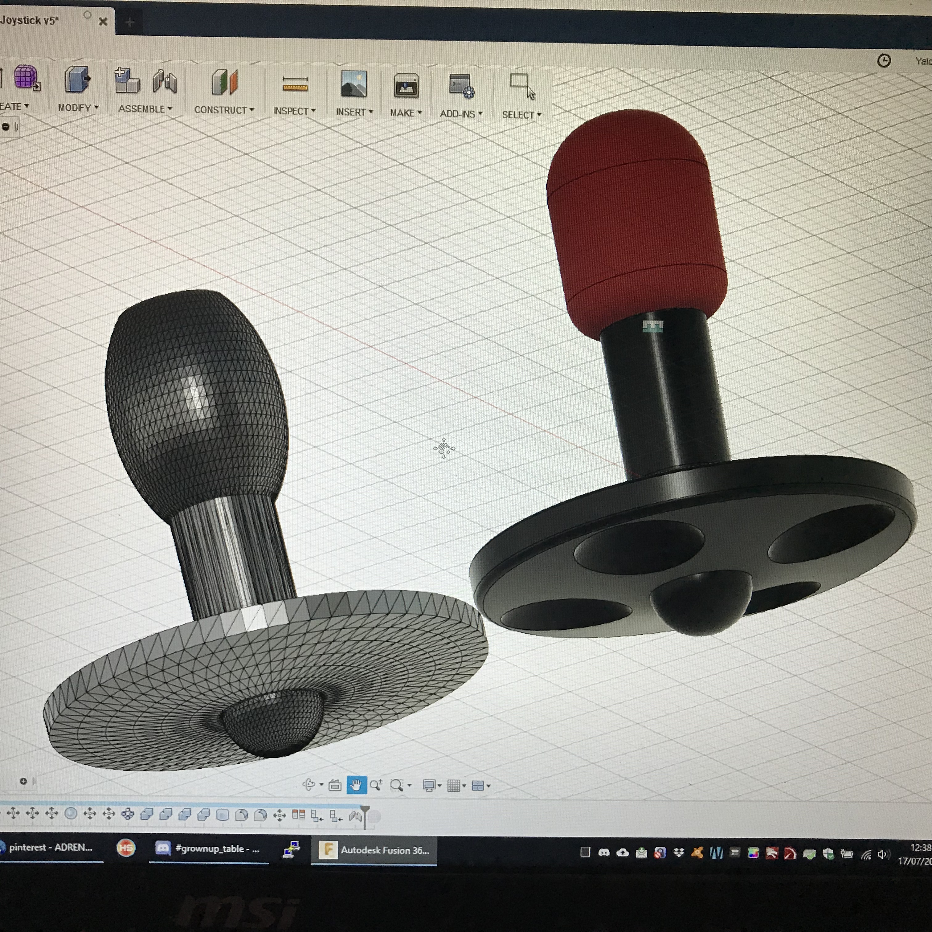

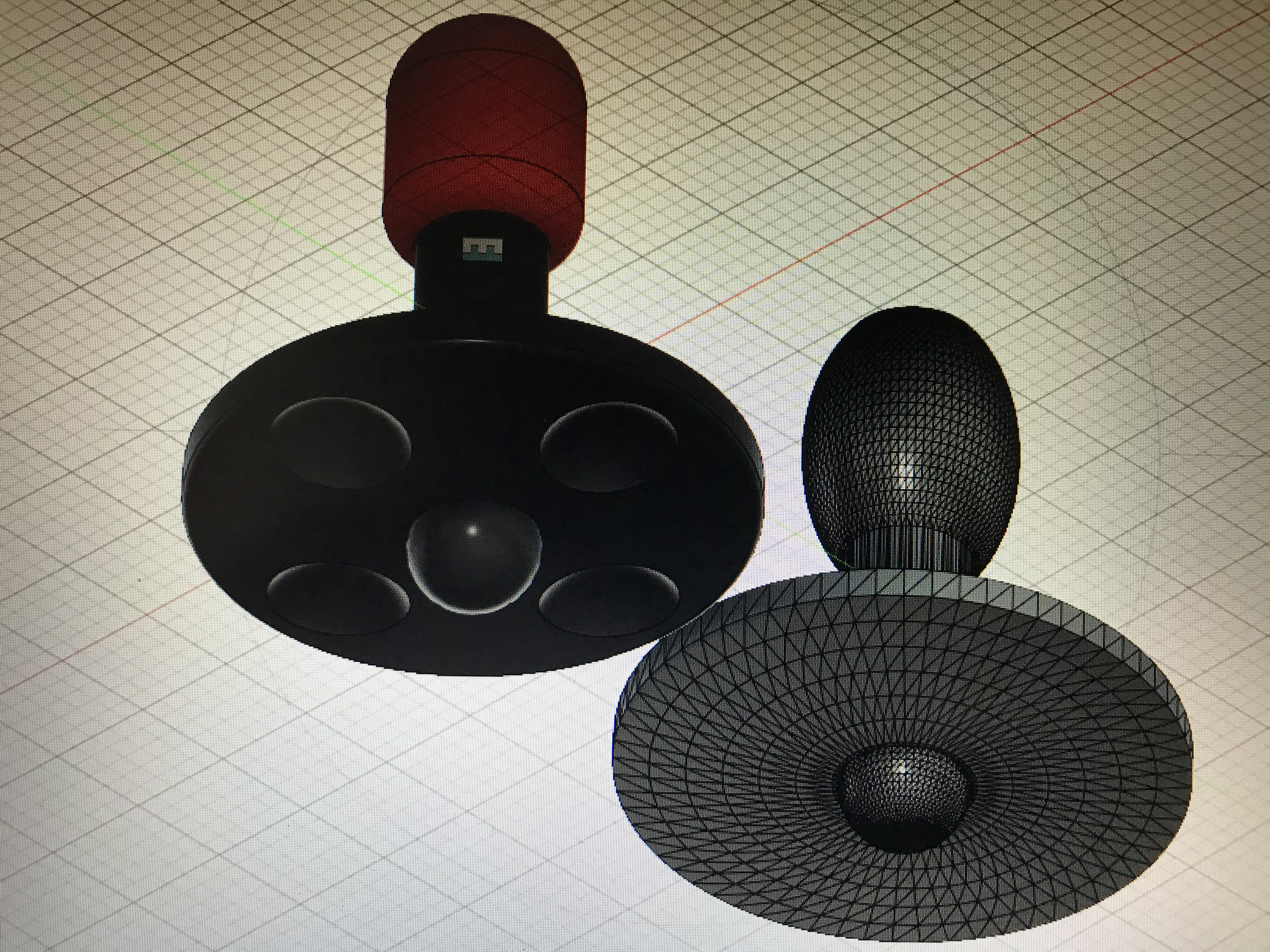

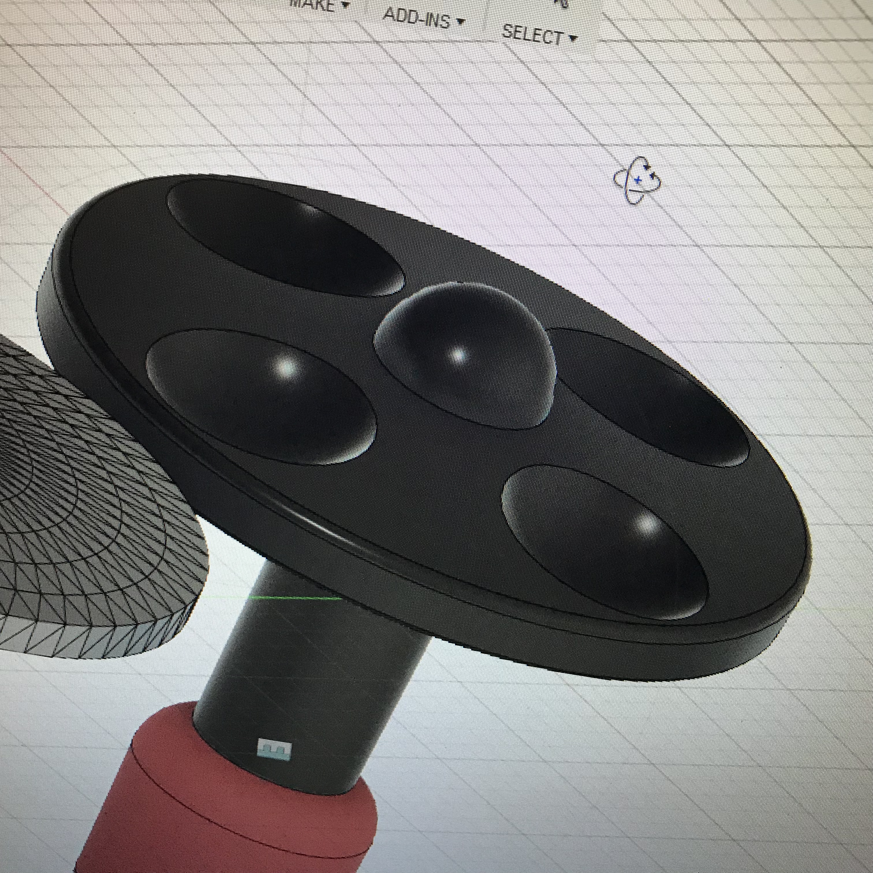

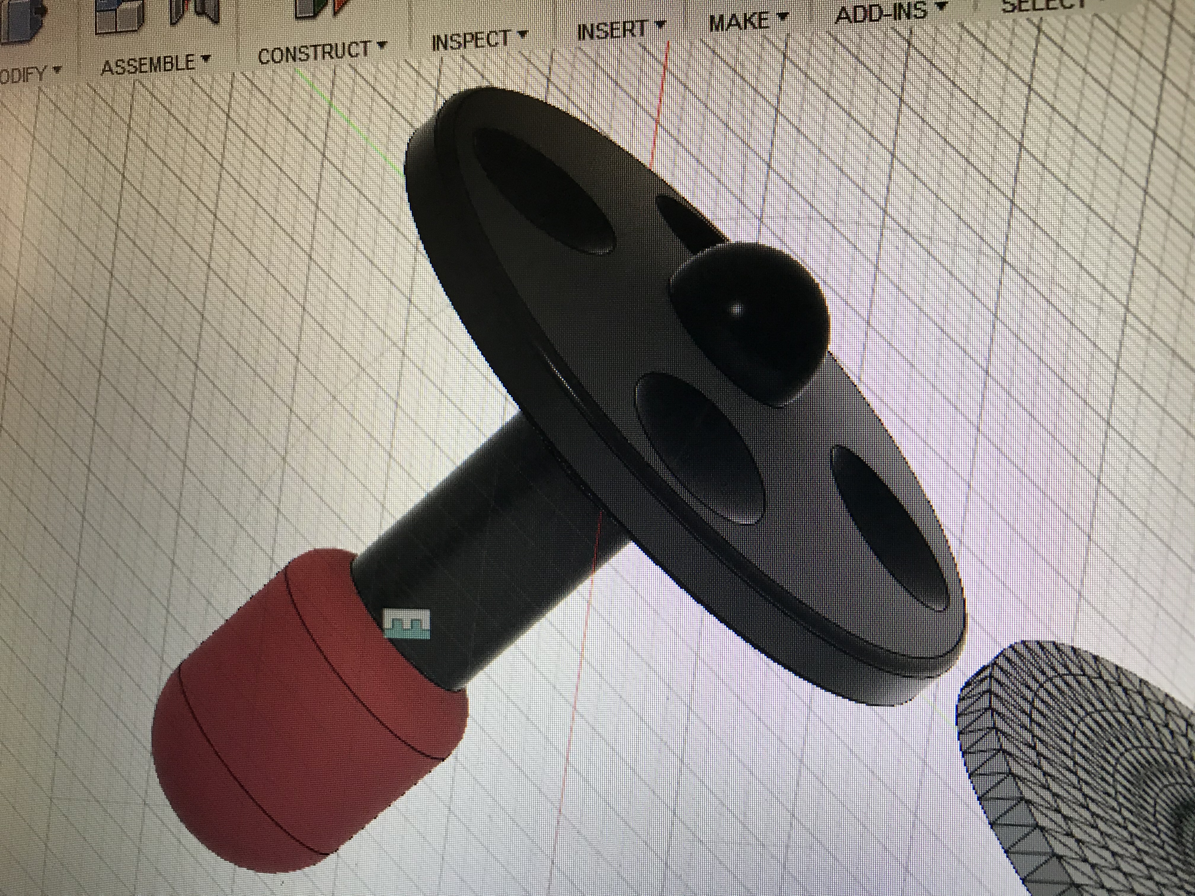

Now that the cosmetic parts are set up, i needed to go deeper in this cabinet so i’ve started from scratch the complete redesign of it under Fusion 360.
I have plenty of respect for the original creator’s work but their model is plenty of bug and doesn’t suits exactly my needs.
I had a small time of adaptation needed as it was my first time on that software, i’m an old school mesh guy :lol:

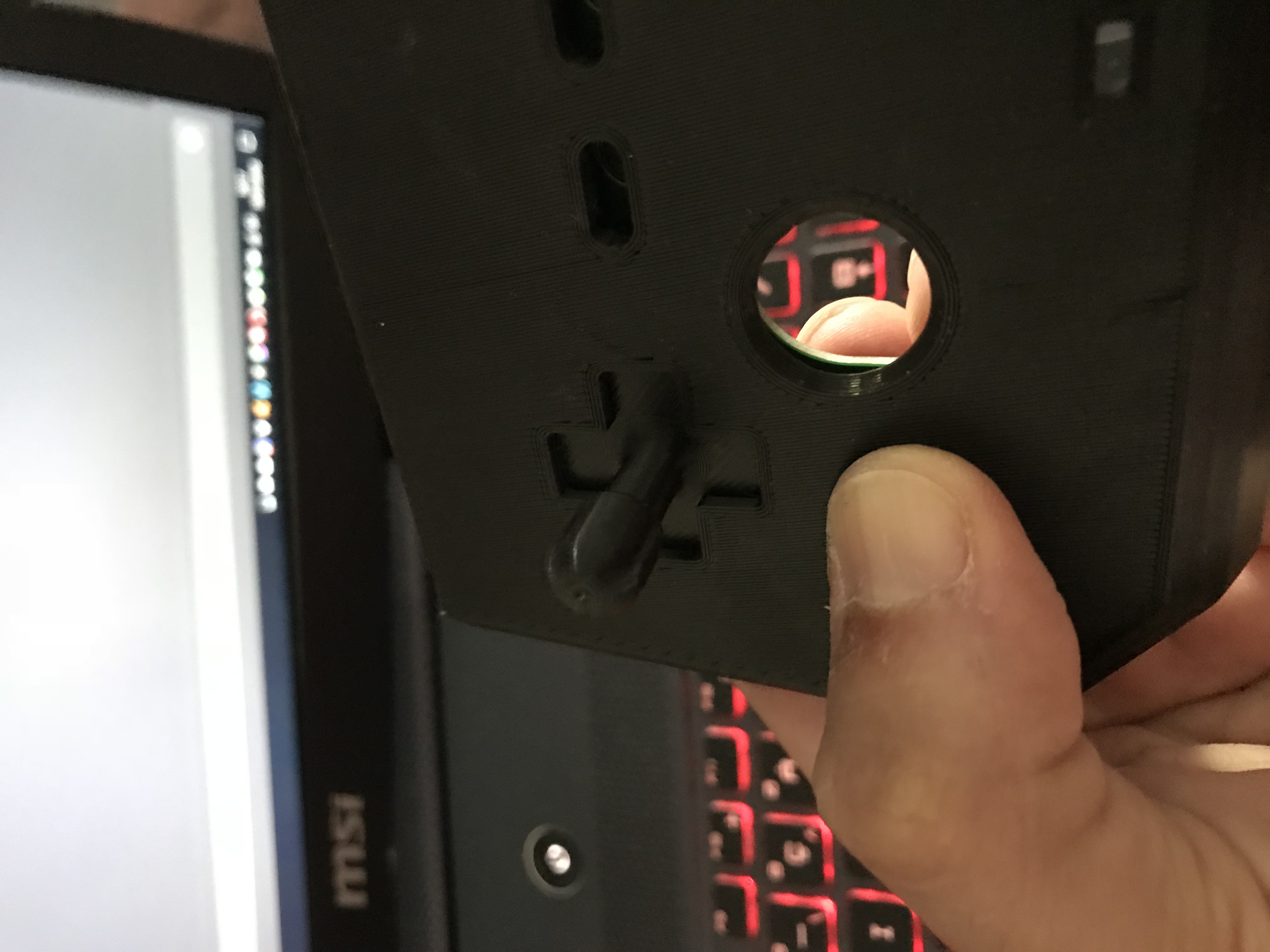

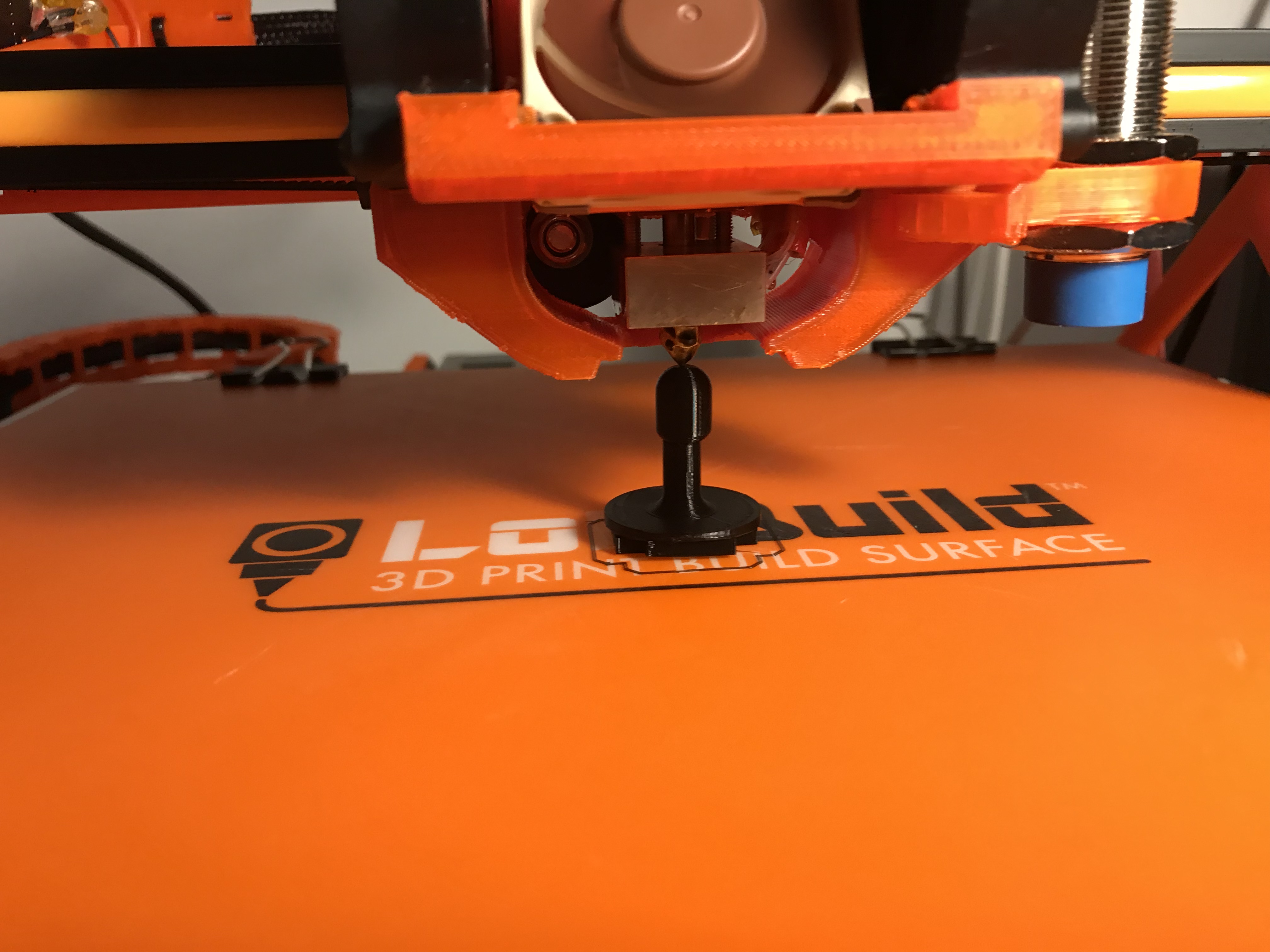

So first i’ve started by redesigning the joystick to give it a more sturdy look, and also be more responsive.
The dual colored joystick is the updated version.
After some testings, the result is just incredible. You can see it on action on Willbakespi’s video on instagram
