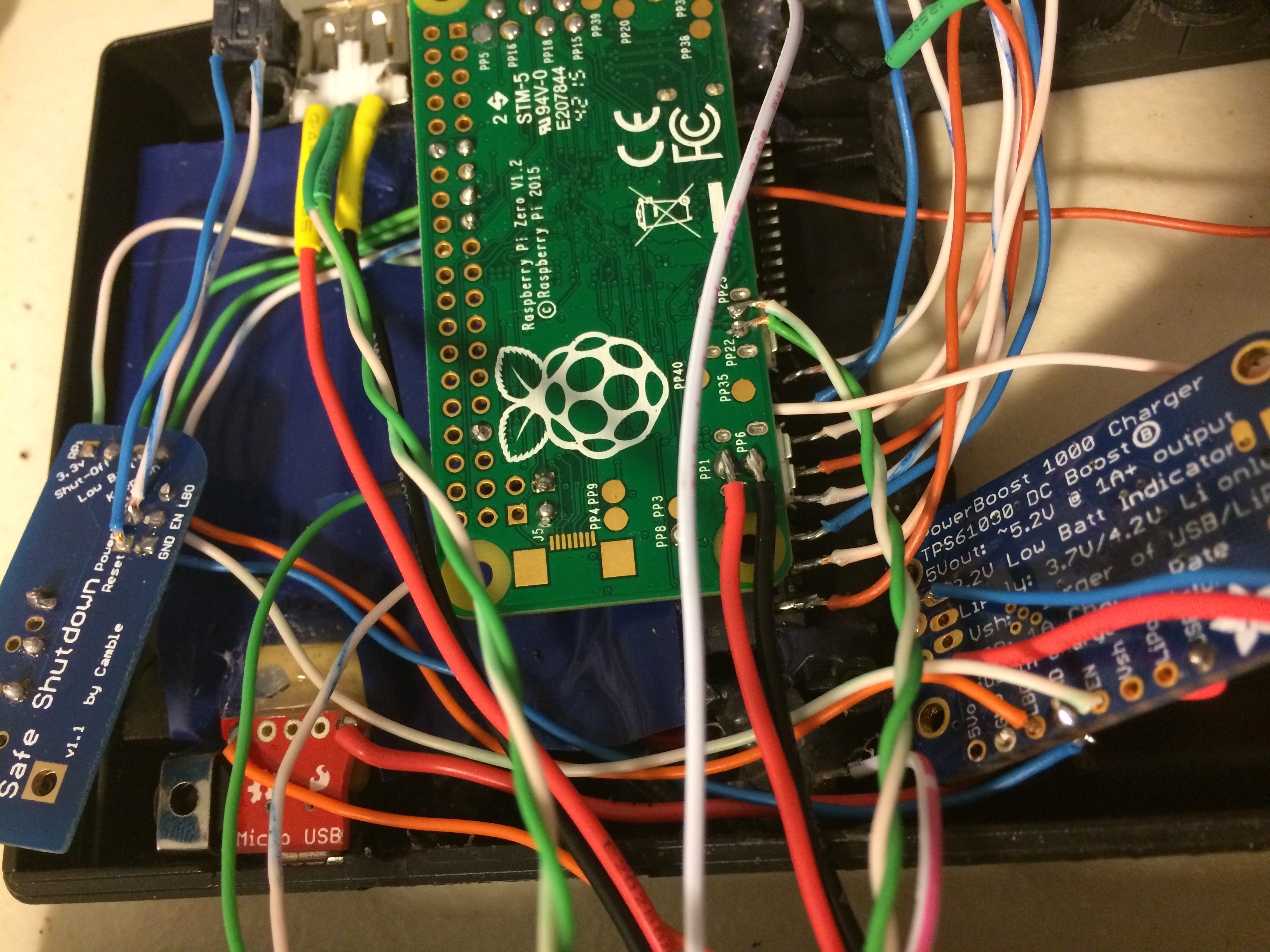

For anyone experiencing the kernel panic issue on shutdown, can you please try the following and report back if the same issue happens? I'm unable to replicate the problem, so your feedback would be appreciated.
This is the command the script runs:
sudo shutdown -h
This should do the same thing:
sudo init 0
This may actually work:
sudo shutdown -r
If this doesn't work, I don't know what will:
sudo poweroff
Here is a workaround which may temporarily resolve the issue. Adding the following line to /etc/sysctl.conf will force the Pi to restart after a kernel panic. At this point, the keep alive pin should go low and shut off the PowerBoost.
kernel.panic = 1
Lastly, please re-download the Power Monitor Script. I think I did a bad. :oops:

@Ganreizu Are you able to most and test the ground connection for me? Everyone who is having issues seem to have the GND pin wired to G (the one beside 5V on the PowerBoost). This should make no difference, but I always use the GND beside EN on the PowerBoost. If by some freak miracle, this fixes your issue, I'll let a3k4 know so he can update his diagram.

Camble wrote:@Ganreizu Are you able to most and test the ground connection for me? Everyone who is having issues seem to have the GND pin wired to G (the one beside 5V on the PowerBoost). This should make no difference, but I always use the GND beside EN on the PowerBoost. If by some freak miracle, this fixes your issue, I'll let a3k4 know so he can update his diagram.
Sure. I think it was there before and I moved it to the ground on the power strip like he has it and that probably made it worse where I don't get a shutdown for battery like I had before. I was meaning to make that change yesterday but didn't get home until 2 am. :cry: I'll make that change when I get home; maybe even finish the whole project today if it works!
Edit: Oh actually it was the micro usb ground that was there before, which is now on the power strip. The safe shutdown ground is on the bottom where the usb power/ground pins are. I'm sure if i move that it will work!
Edit2: @Camble: No difference. :/ The whole system just keeps completely shutting off no messages or anything.

@Ganreizu Have you tried disconnecting all components except the Pi?

Ganreizu wrote:Edit2: @Camble: No difference. :/ The whole system just keeps completely shutting off no messages or anything.
So, we have the same wiring and the same issue.

Camble wrote:@Ganreizu Have you tried disconnecting all components except the Pi?
As in disconnecting the power strip and micro usb from the powerboost?

@Ganreizu No, any peripherals. WiFi, LCD, USB hub etc...
