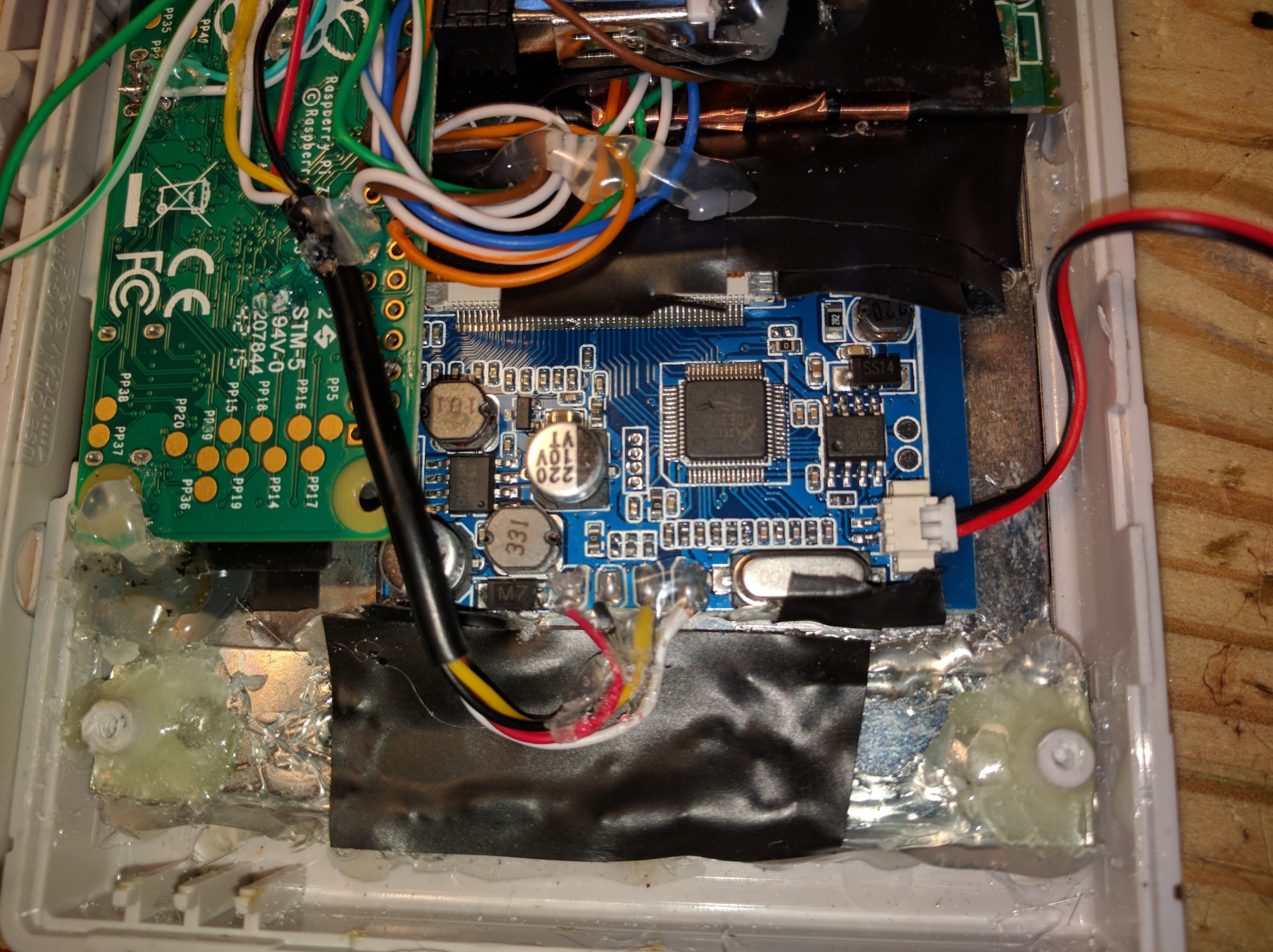

Welp... a little more on this BW composite screen from Nioceshopping.. Now that I have everything connected. the display is not as good. It seems like the color is distroted, the brightness is a little off, and there seems to be some small flickering going on. I am wondering if it is trying to pull 12v but only getting 5v. The other thing is if I connect the powerconnect to USB the screen improves a ton and goes back to normal.
Any thoughts?

This is my display off Niceshopping Amazon. http://www.amazon.com/BW-3-5-Inch-Monit ... detailpage

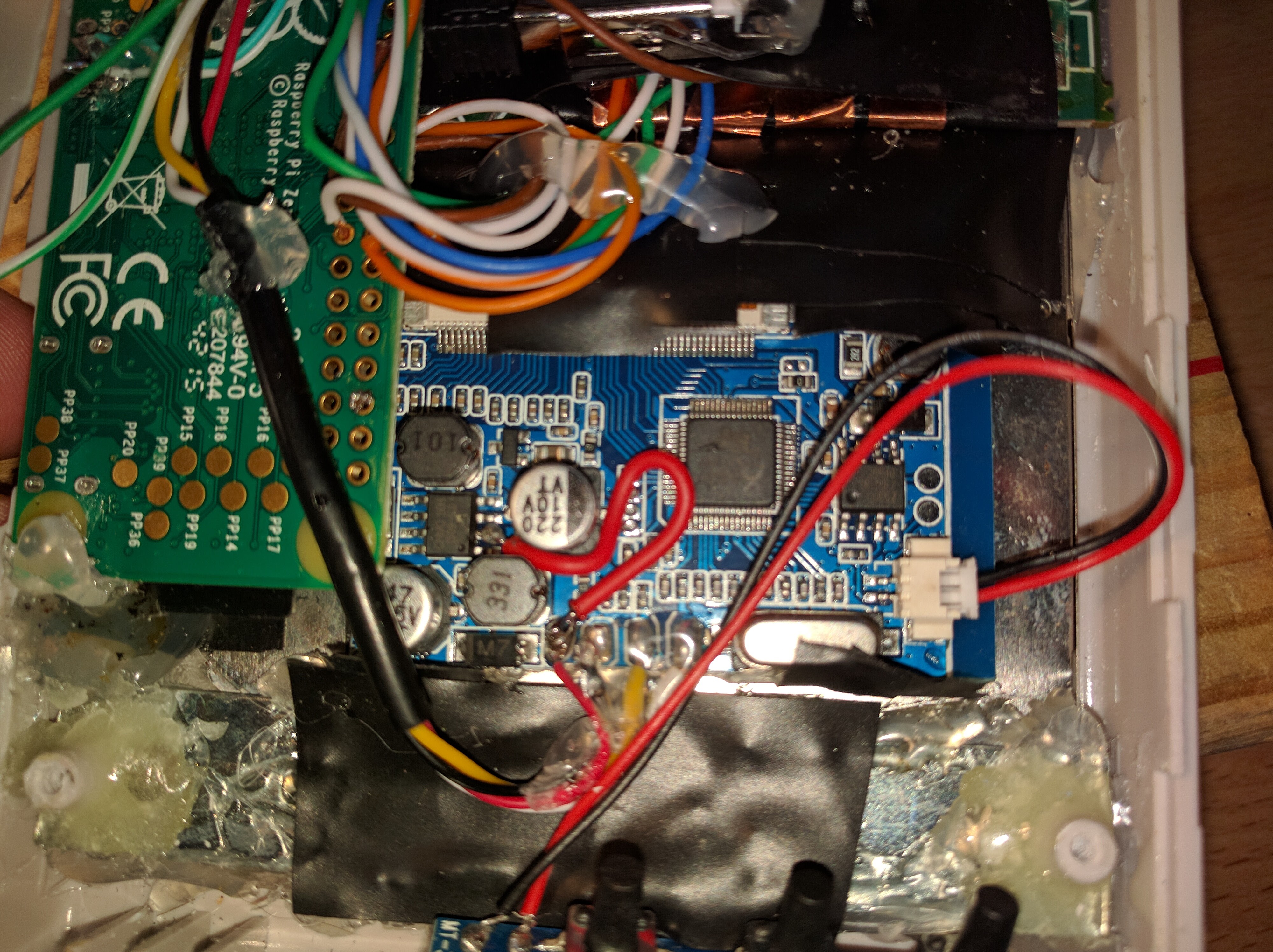

Before: Jumper cable mod: I placed the jumper and it does seem to improve the jitter in the screen, but, I still think it is being under powered. If i leave the screen on for a while, it does seem to get worse in quality.
Here is a video when retropie starts the blank screen saver. You should be able to see the jitter. https://goo.gl/photos/tNMSozsK2i2LsHS28
I will update my progress thread once I figure out if I need to further mod the display.

dirtybeagles wrote:This is my display off Niceshopping Amazon. http://www.amazon.com/BW-3-5-Inch-Monit ... detailpage
Before: IMG_20160530_100346.jpg
Jumper cable mod: IMG_20160530_110116.jpg

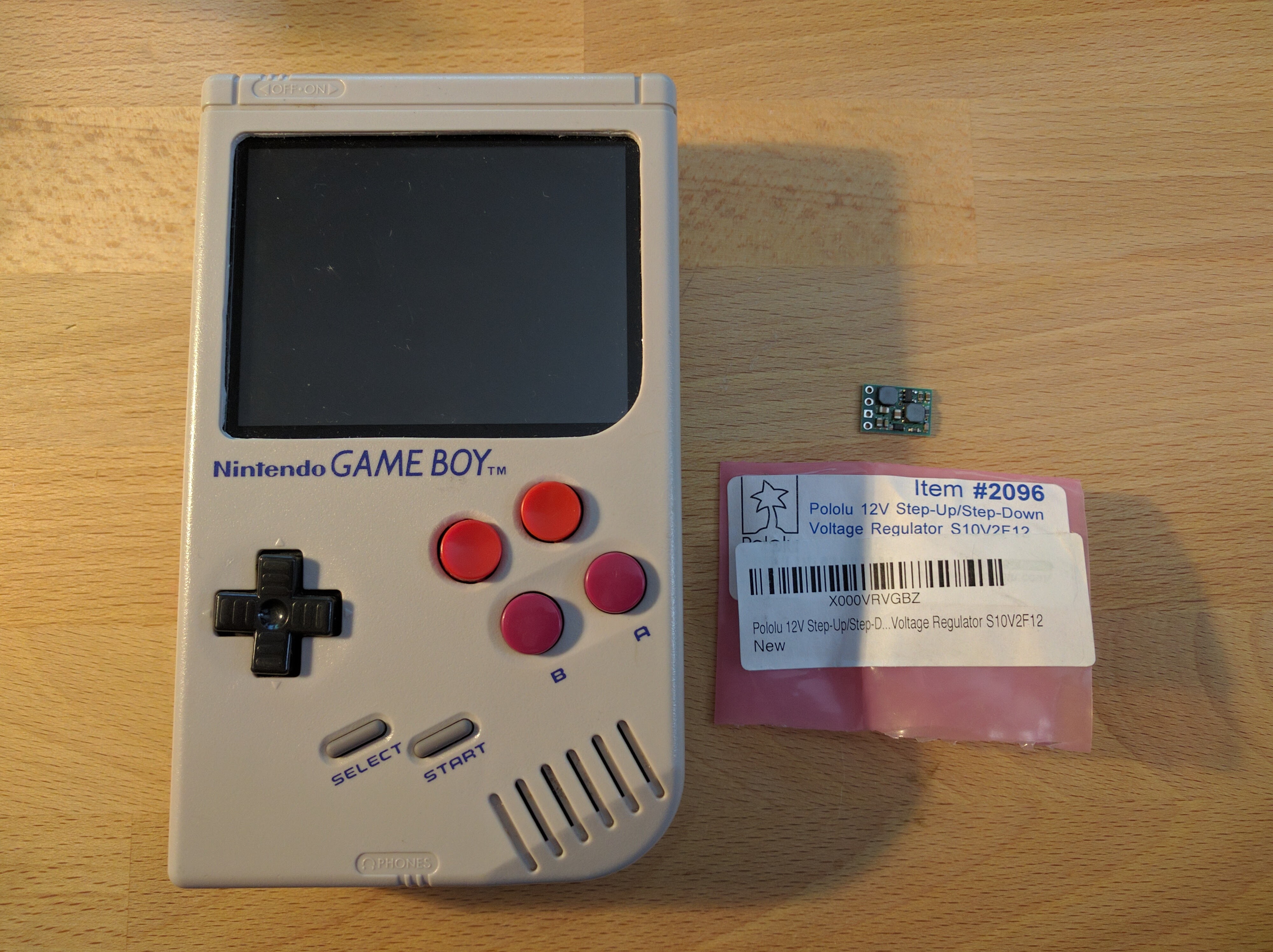

Yup, I bought the Pololu one after reading reviews: http://www.amazon.com/Pololu-Step-Up-St ... ge_o00_s00Fleder wrote:dirtybeagles wrote:I bought this one here, and now it works like a charm.

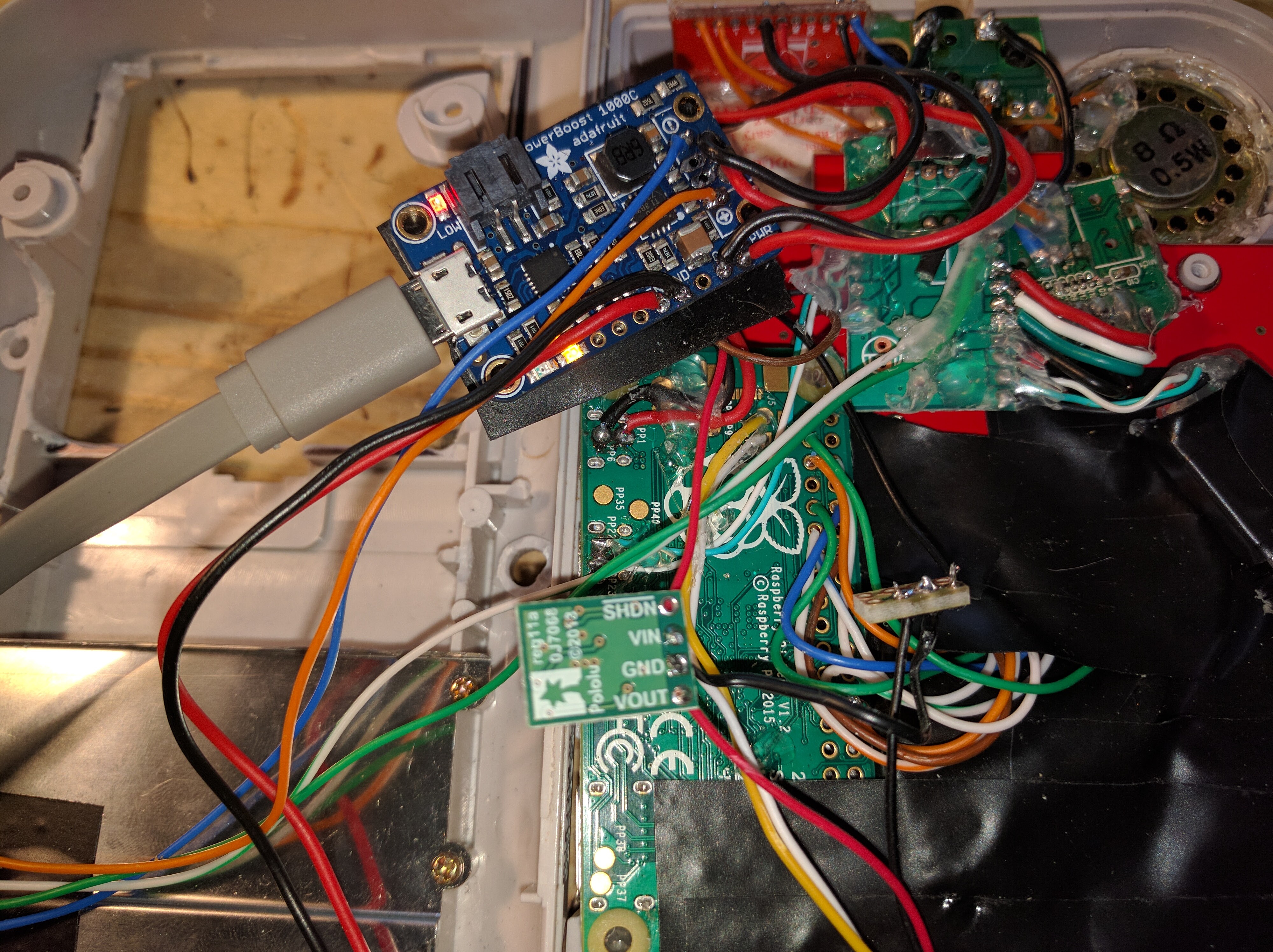

Well, I either did not set up my 12v jumper up properly, or I am hosed
Here is my 12v Jumper from Pololu: I cut both my red 5v wire and my ground going to my screen to my breakout board. I then solder the components like you see in the picture:
VOUT --> Red wire to screen
VIN --> Red wire to breakout board
Gound --> Black wire to GND solder point (the wires are solder together)
I get a LOW light on my PowerBoost and the screen never comes on. There is a SHDN connection on the 12v jumper but I do not know what that means.
Anyone got any input?

The SHDN pin is to cut voltage out if input voltage drops under 1.1v. Have you tuned the output voltage yet. There's a little trimmer you can tune with a screwdriver and a voltmeter. TUNE THAT TO 12Vdirtybeagles wrote:Well, I either did not set up my 12v jumper up properly, or I am hosed![]()
