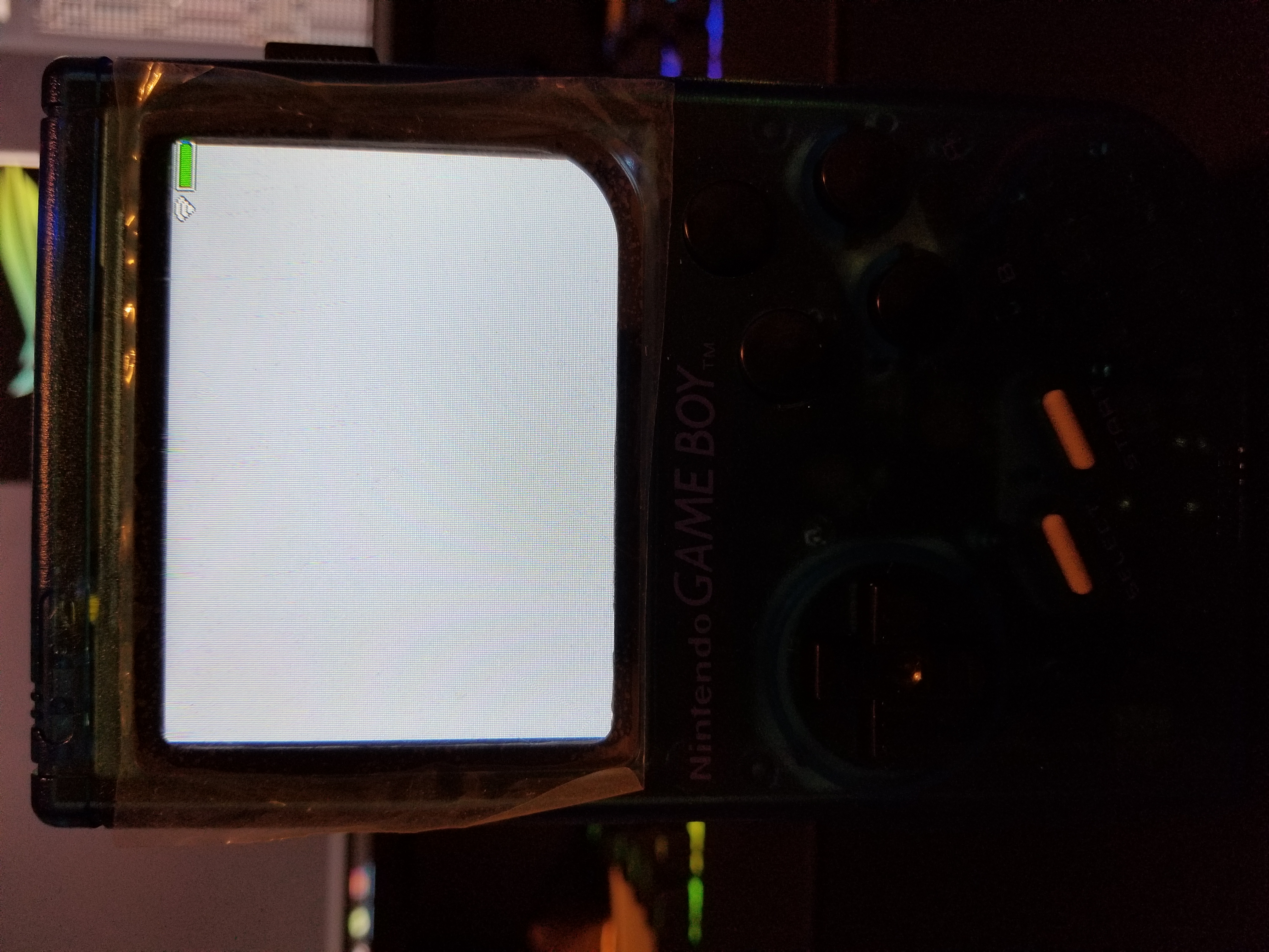

So that last screenshot doesn't mean anything, all CS's say that on the blank screens (it's an ES thing). There is probably more required and work needed i'm afraid! What might be best is to re-image to how it was before working with a gamepad, and then finding some guides online about how to get it to work on the pi3 or the pi zero w.. the steps should be the same (in theory) for the CS.. i've never tried nor do i have any BT headphones so it's a little hard to do :P hopefully someone that does know can take a look! The chap that did the script originally https://github.com/timemaster5 might have some more information. Next time I talk to him i'll mention it

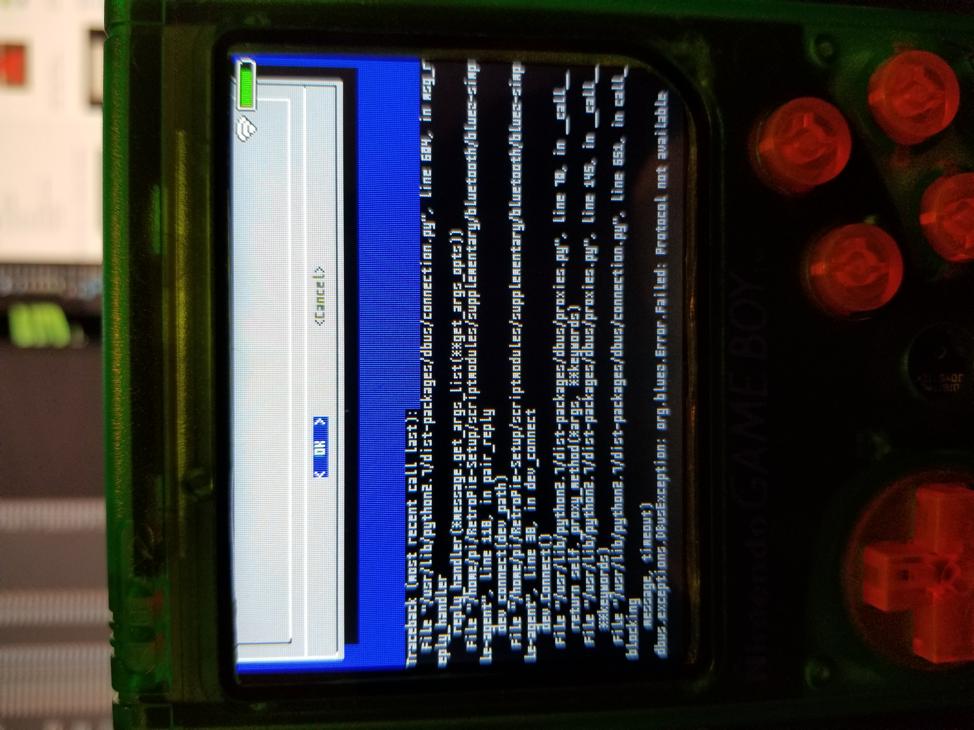

So I got the CS Lite put together to try the BT out on it and I get this message
I was curious if I needed to add this again:
cd Circuit-Sword/settings
chmod +x bluetooth-audio.sh
sudo ./bluetooth-audio.sh
Also is it still supposed to be F4 to go to the command line on the CS lite?

Okay after some research I realized the ext usb was not enabled and that's why the BT keyboard F4 didn't work. Once I turned in on it did work but I imagine the CD Circuit-Sword input that I did on the CS CM3 will be different on the lite. But right now I have both a CS CM3 and a CS Lite and if I could get BT audio to play that would be awesome!
On the CS I was able to get it to connect and work a couple of times but the way I had to do it was crazy with: connecting the BT headset, start game (it would freeze), turn off, turn on, connect again and then it would work... Sometimes lol
On the CS Lite nothing at all, it says protocol not available.
In the mean time I can go get a 3.5mm jack to BT receiver and try that, but would be awesome if I didn't have to use that!
The CS lite won't require any of the changes we had to do for the CS, this is because the Lite uses the Pi Zero W which has its own BT module, nothing to do with the one I had to add for the CS, so any instructions/help that work on the Pi3 or Zero W are what you need to find.. in theory that should mean it is easier to find information! For example, this person seems to have success: https://retropie.org.uk/forum/topic/203 ... -3-model-b

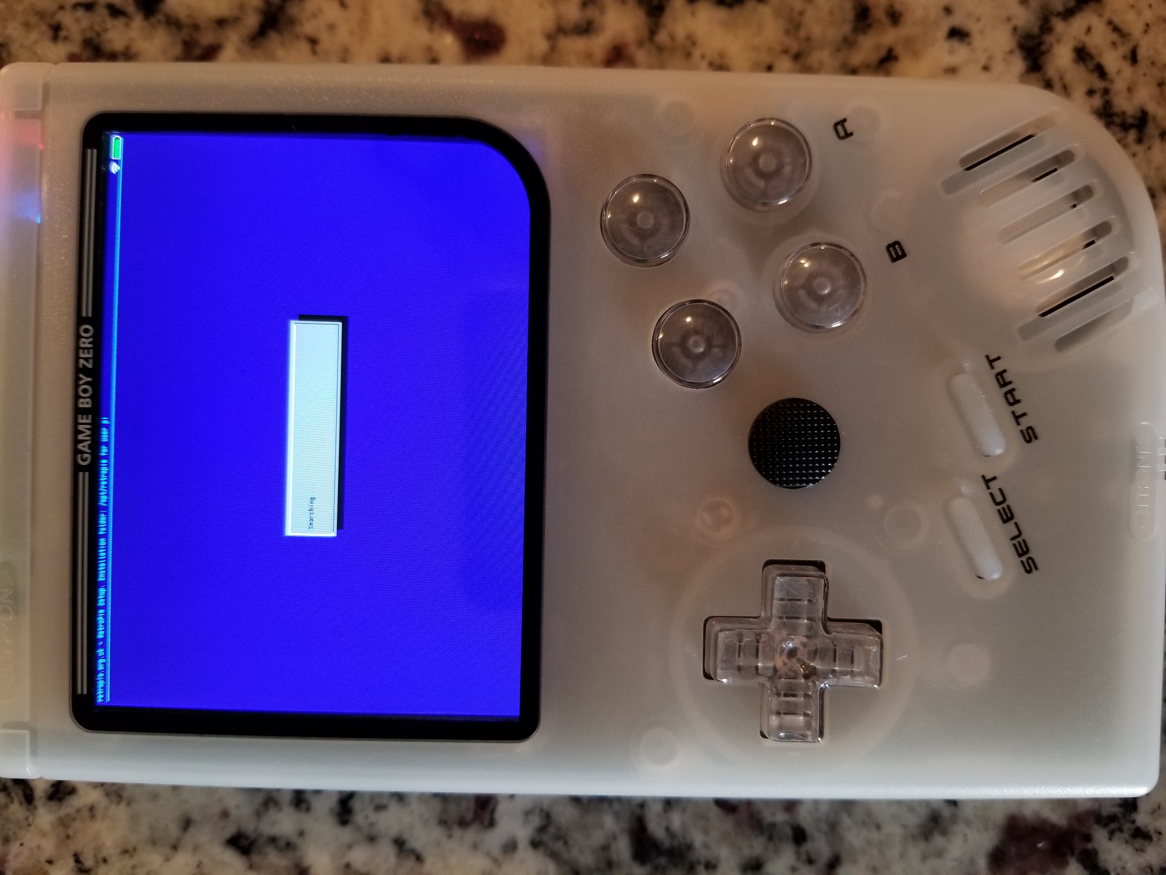

Post by Crainium17 » Thu Jan 02, 2020 1:09 pm
Okay so I have got some BT transmitters for the BT audio but now that I have the newest CS put together and try to connect my 8bitdo controller my screen freezes on searching and doesn't go any further. Any suggestions on fixing this?

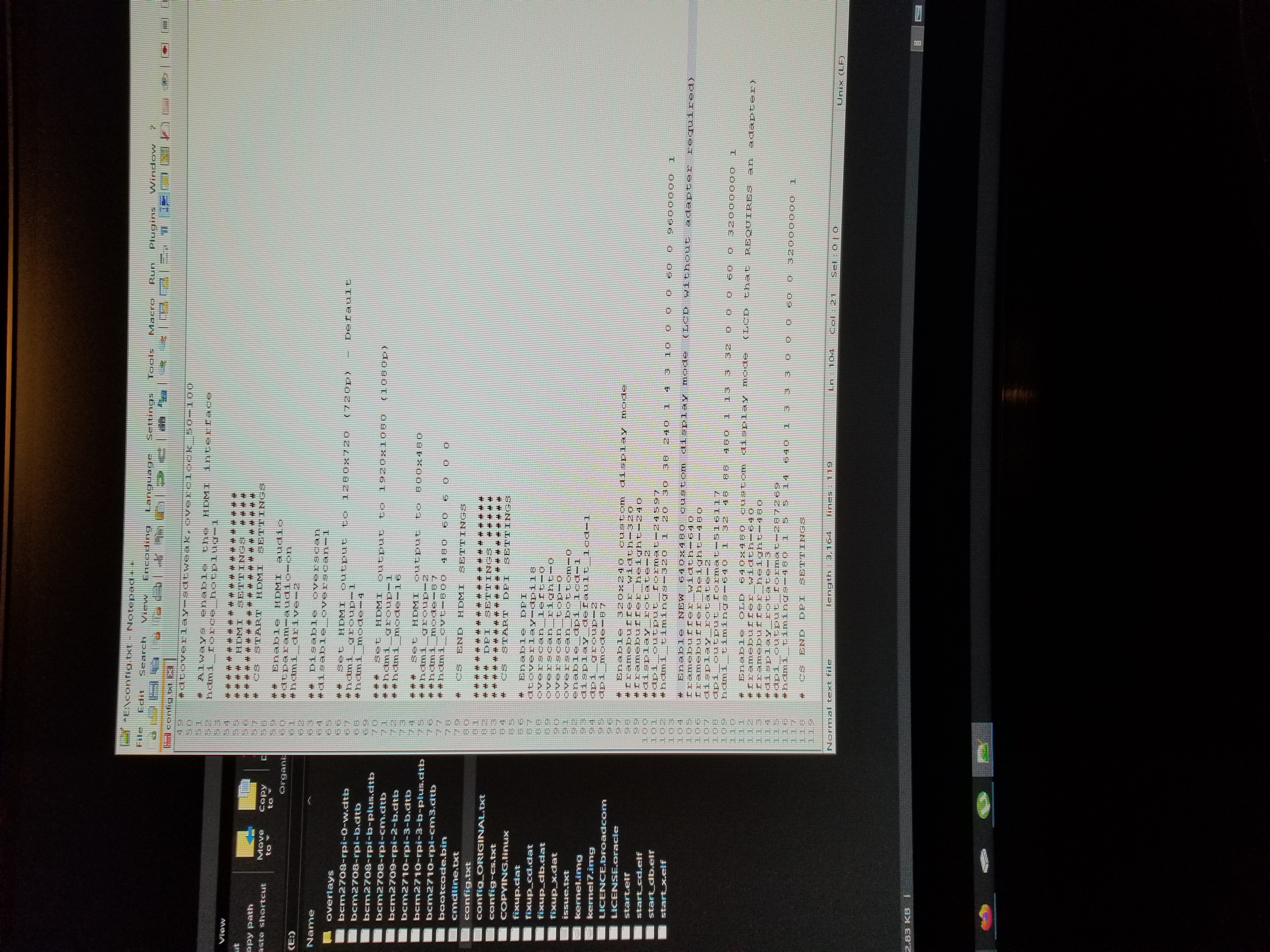

*note I am running the latest CS image because I have the new 640x480 screen and the one that had the BT working didn't have the option to turn on the new 640x480 screen only the old.

Post by Crainium17 » Sun Jan 05, 2020 12:12 am
Got it worked out and working like a charm now! I had to copy:
# Enable NEW 640x480 custom display mode (LCD without adapter required)
framebuffer_width=640
framebuffer_height=480
display_rotate=2
dpi_output_format=516117
hdmi_timings=640 1 32 48 88 480 1 13 3 32 0 0 0 60 0 32000000 1
To the old software version config.txt from 10-13-2019 since bluetooth is working good on this version.

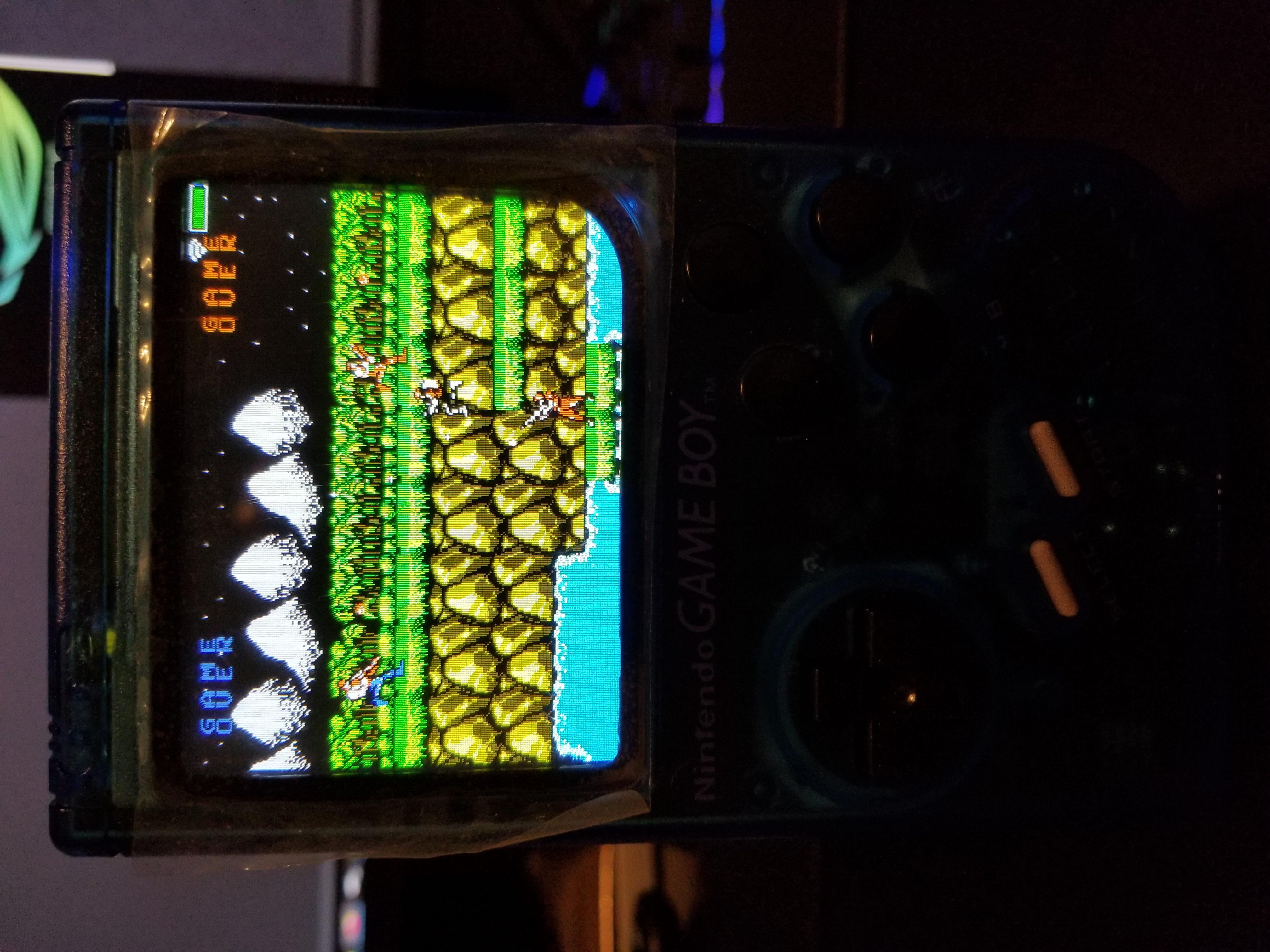

After that I am able to use the new 640x480 screen and play the Gameboy as a handheld and then plug it into the TV and wall charger, reboot to hdmi, connect my Bluetooth controller, and use it as a console!
