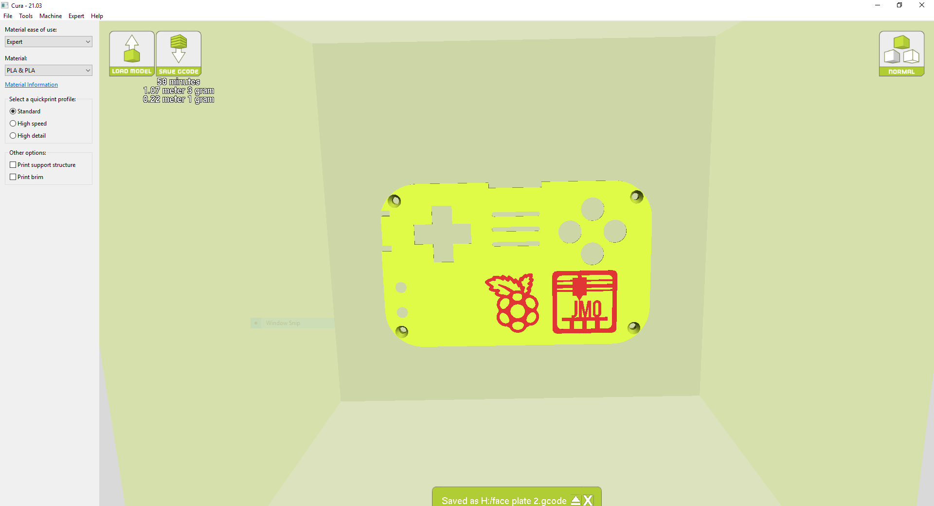

peeweejedi
Posts: 26
Joined: Wed Aug 09, 2017 5:00 am
Re: Dual colored faceplate for mintyPi
Post by peeweejedi » Wed Aug 09, 2017 3:00 pm
well, I made my own still printing I put my entail in the corner to personalize it.
printing on a Taz 5
peeweejedi
Posts: 26
Post by peeweejedi » Thu Aug 10, 2017 5:23 am
Finally, I got it printed I did use an Exacto knife to trim some edges (that's why dome edges are uneven).
Do not know why the photo is upside down.
