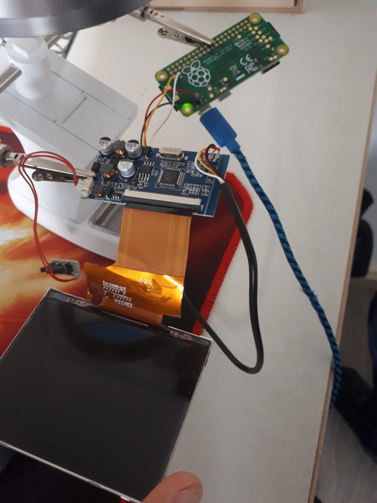

WhatsApp Image 2018-11-07 at 23.12.54.jpeg (118.94 KiB) Viewed 6203 times
Hello,
I have been using the various Youtube videos from Wermy to create a Gameboy Zero. Its my first attempt at modding anything really so I went ahead and ordered the required materials and tools needed for this project.
Now I managed to get all the way up until the point where I solder the screen-board wires to the raspberry pi (0).
(I am using this video as the guide btw: https://www.youtube.com/watch?v=sbLAoOCit5k&t=17s)
According to the Sudomod wiki, I have a v7 type board on my screen. Which doesn't require any sort of modification to run off 5volt.
(http://www.sudomod.com/wiki/index.php/B ... te_Display)
However, when I power on the RBP0, the screen goes on-and-off, kind of like flickering. I will sometimes catch a glimpse of the screen saying: "AV2".
Is this something you guys recognize? Like maybe the soldering went wrong? Maybe its a known error with this type of screen?

Post by VeteranGamer » Fri Nov 09, 2018 12:35 am
If you search variant 7 in the forum...
You should find that a modification may be required
(Not sure why this isn’t made clear in the wiki)

Re: Gameboy Zero screen flickering
Post by Helder » Fri Nov 09, 2018 5:14 pm
I'm almost positive that they are following Wermy's original tutorial video's which require the use of a backup camera.
