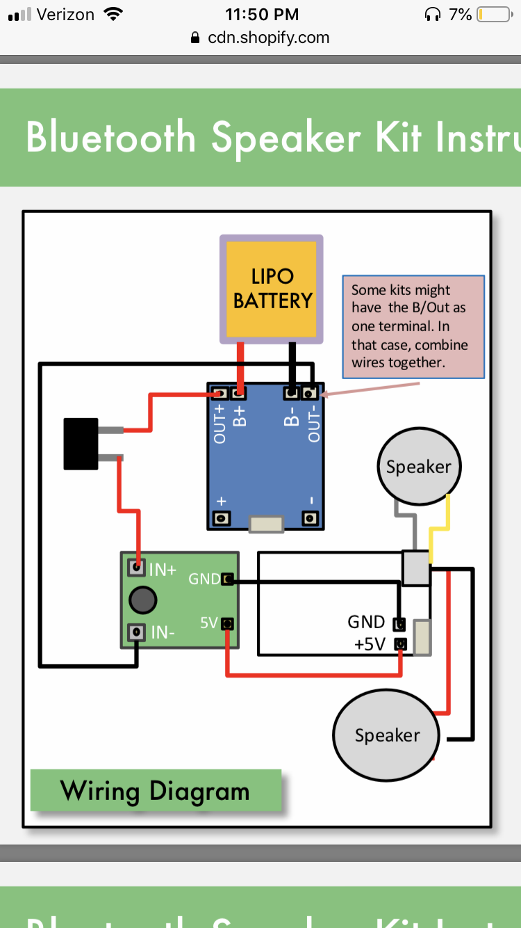

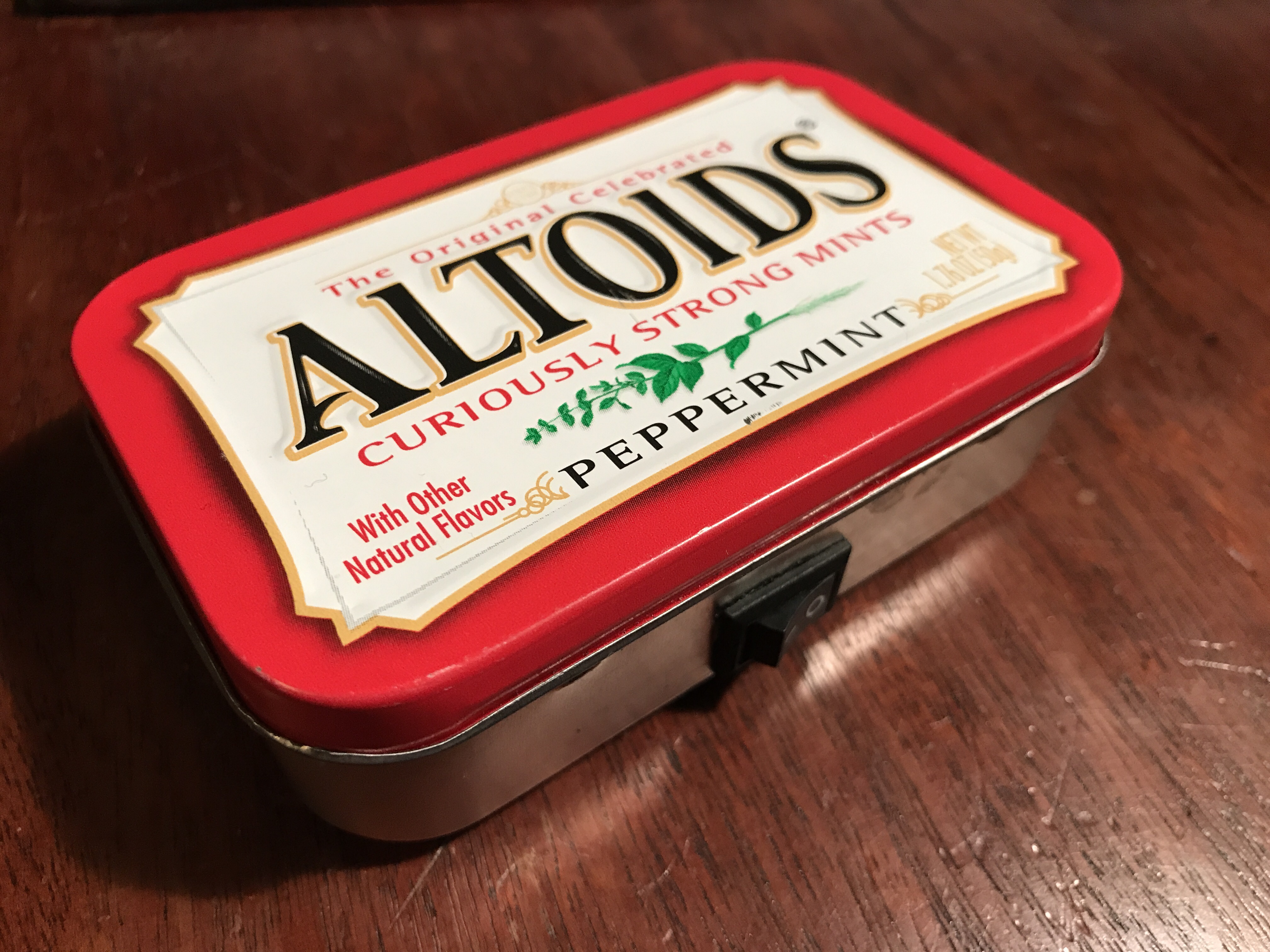

To get ready to build a mintypi, I made this altoids tin speaker to get comforatable with electronics and filing the tin.
Here is the PARTS list:
Two 3 W speakers
Usb charging module
5v dc to dc converter
Bluetooth module
1000 mah lipo battery
Switch

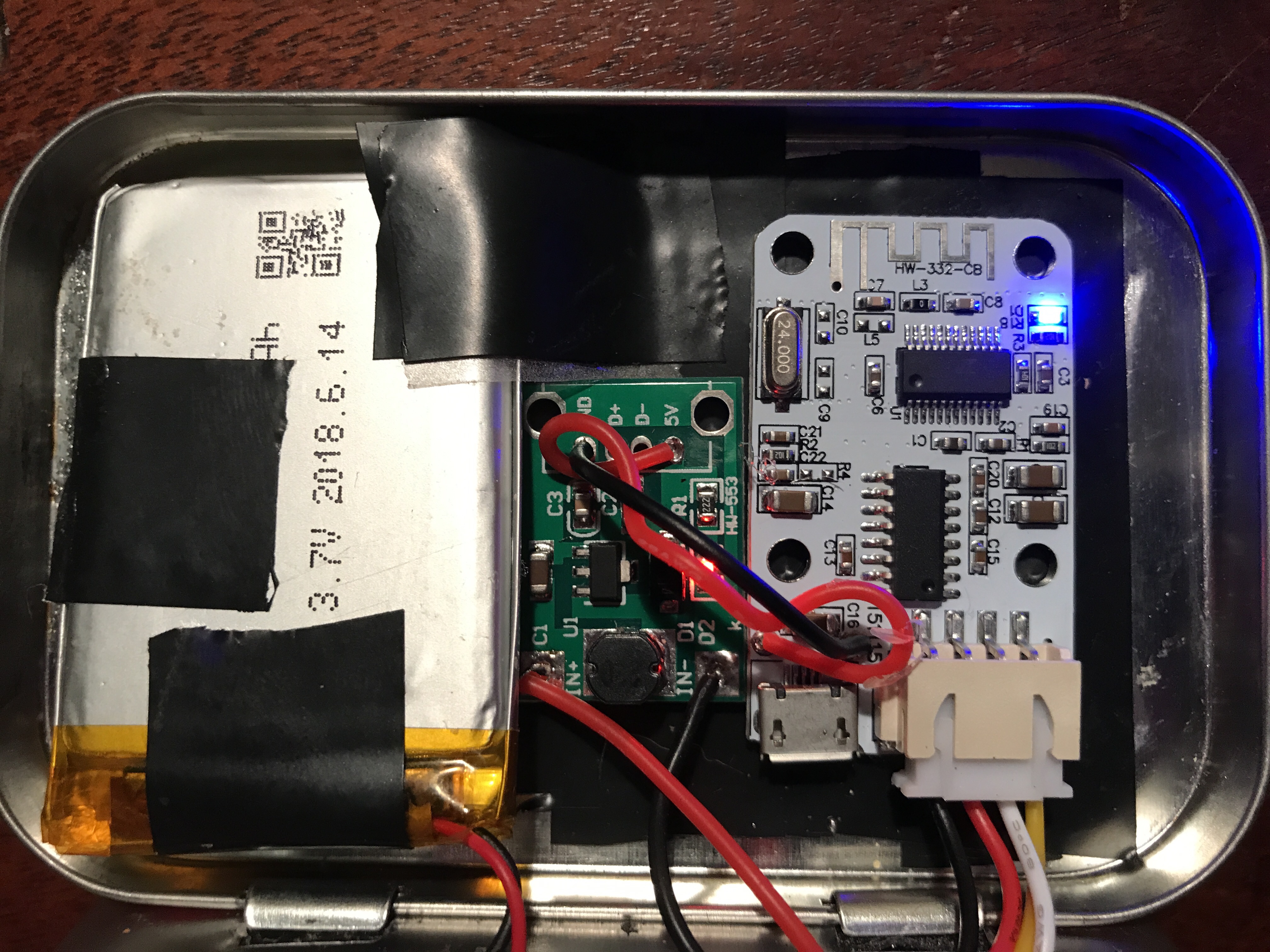

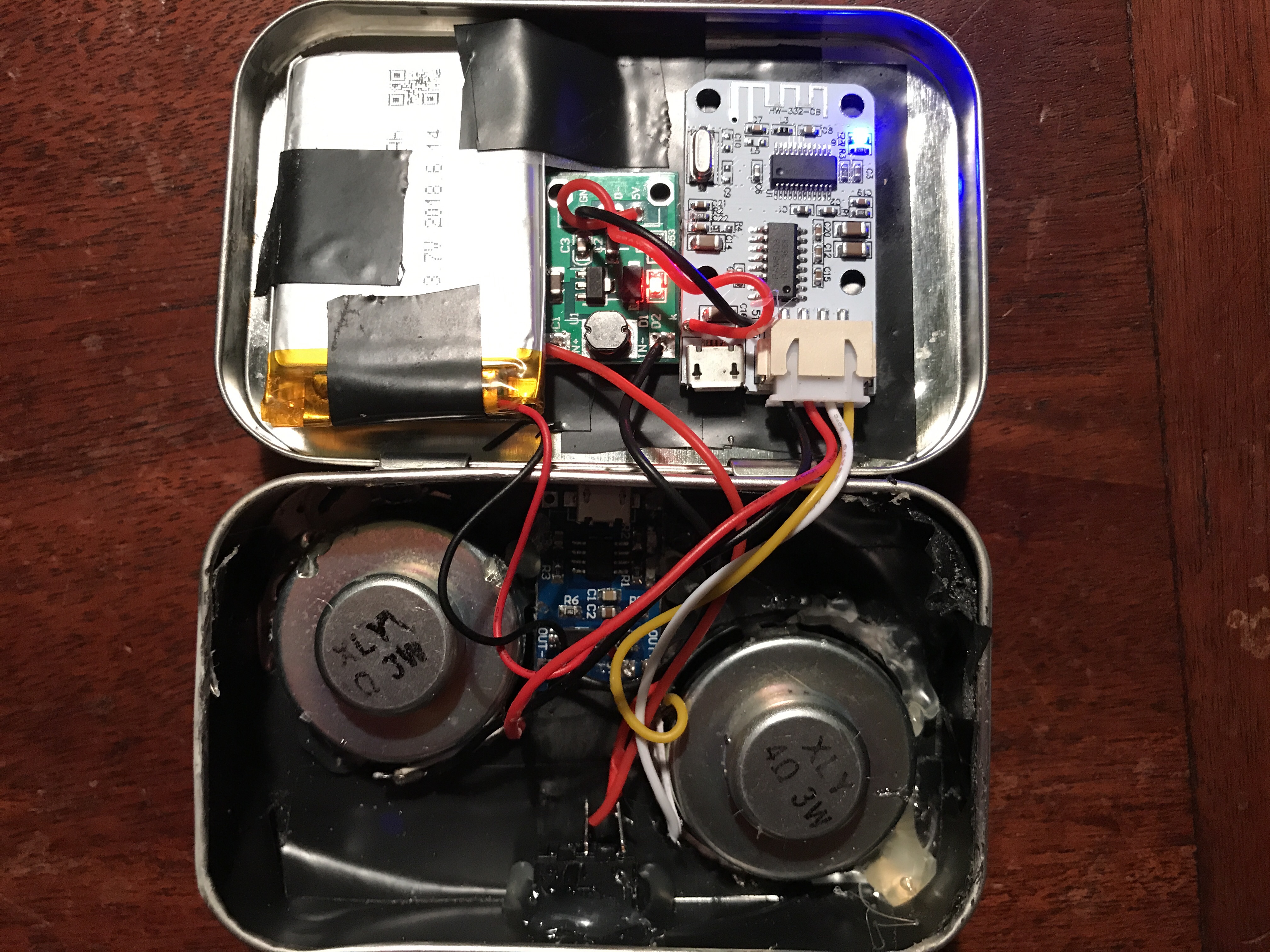

Here are some pictures:
Before you go make this, you should know that the speakers aren’t very loud. My phone is louder by far, but it’s cool have and it’s fun to freak people out with it.
I’ll make a build guide (video) of a cleaner one with better speakers if you guys are interested.

That looks super cool! How well does the blue tooth module work in the tin?
_____________________________________________
Favorite tank is the Super Pershing.
Gizard
Posts: 78
Been thanked: 8 times
Re: Easy Mint Tin Project to Practice for MintyPi
Post by Gizard » Sat Jan 19, 2019 7:13 pm
CatCannon9 wrote:
Sat Jan 19, 2019 10:11 am
Not perfect :lol:
You have to (barely) keep the tin cracked to keep a steady signal.
But I bet I could fix that if I drilled a nice hole next to the module
Edit: I did that and it works perfectly when closed!
