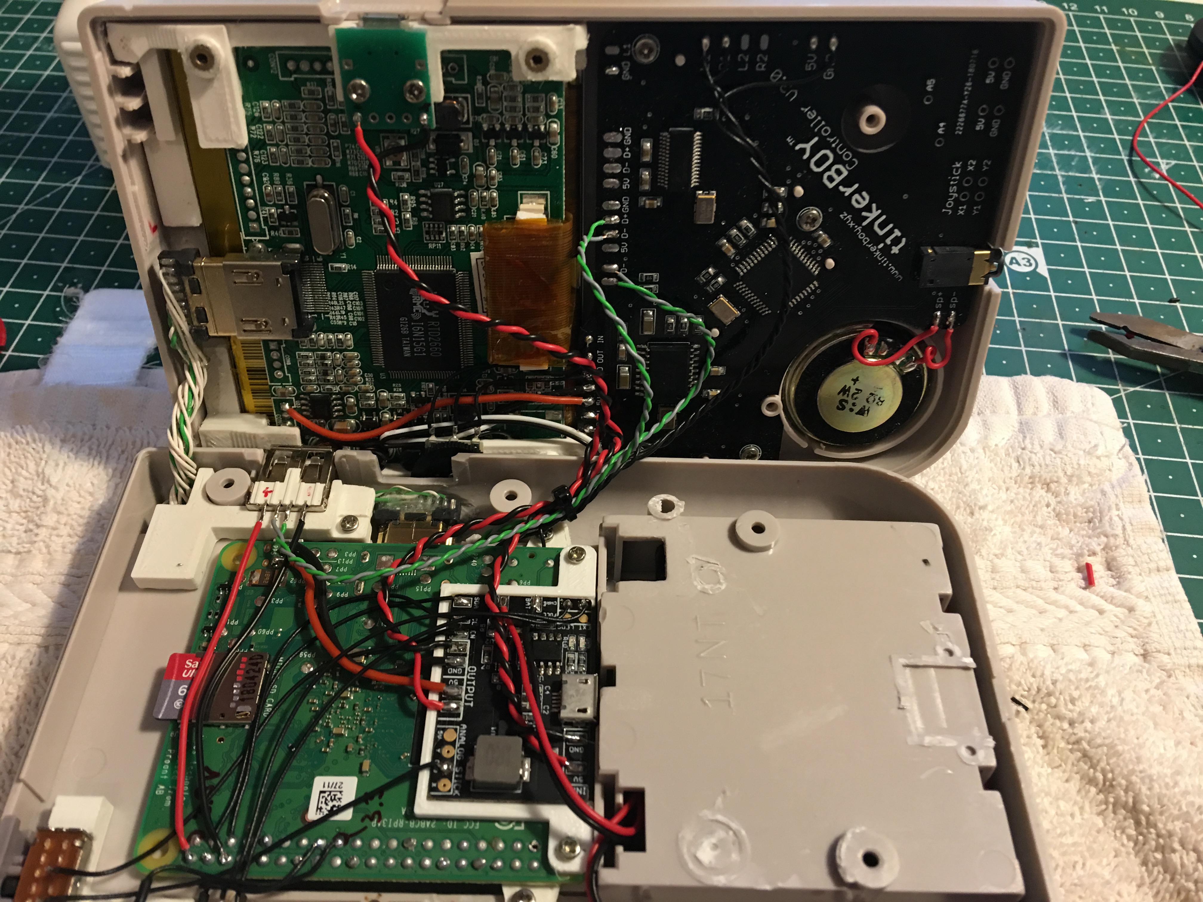

Hello Friends,

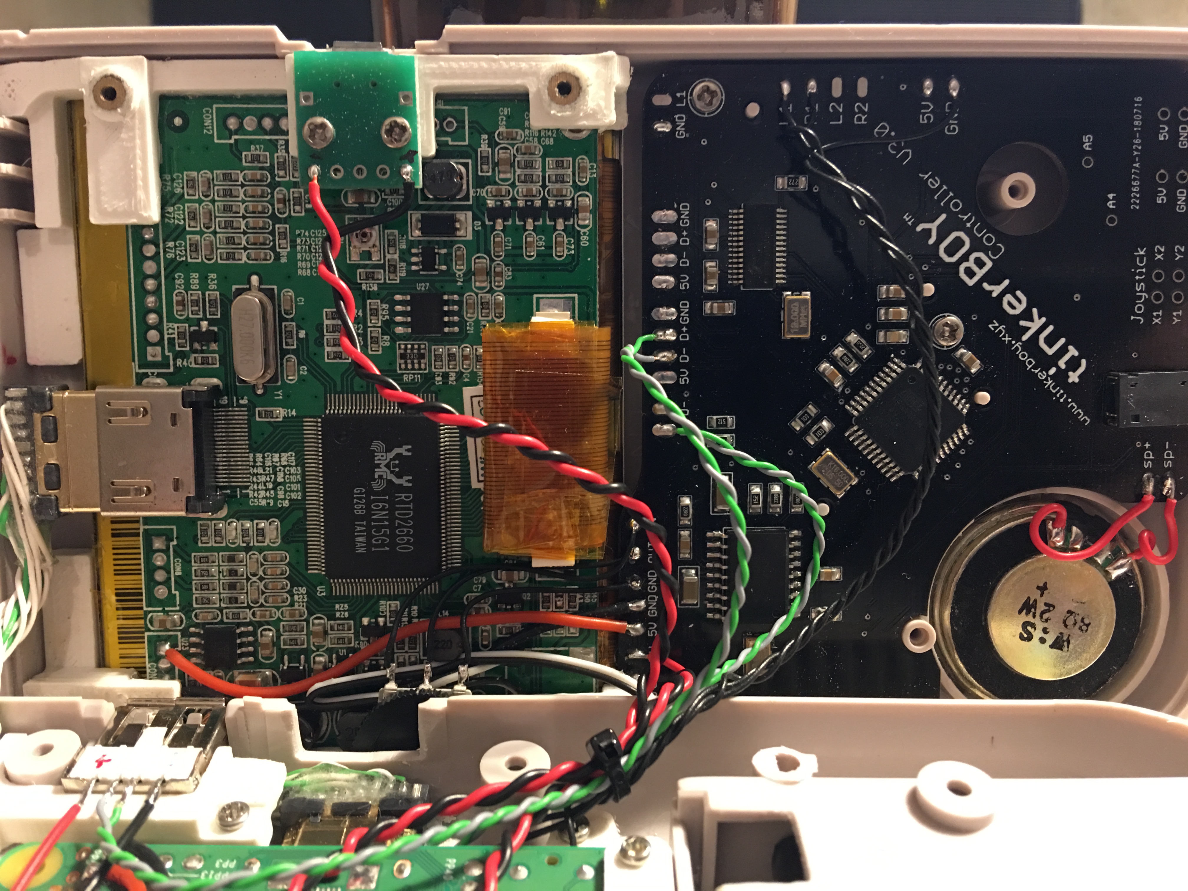

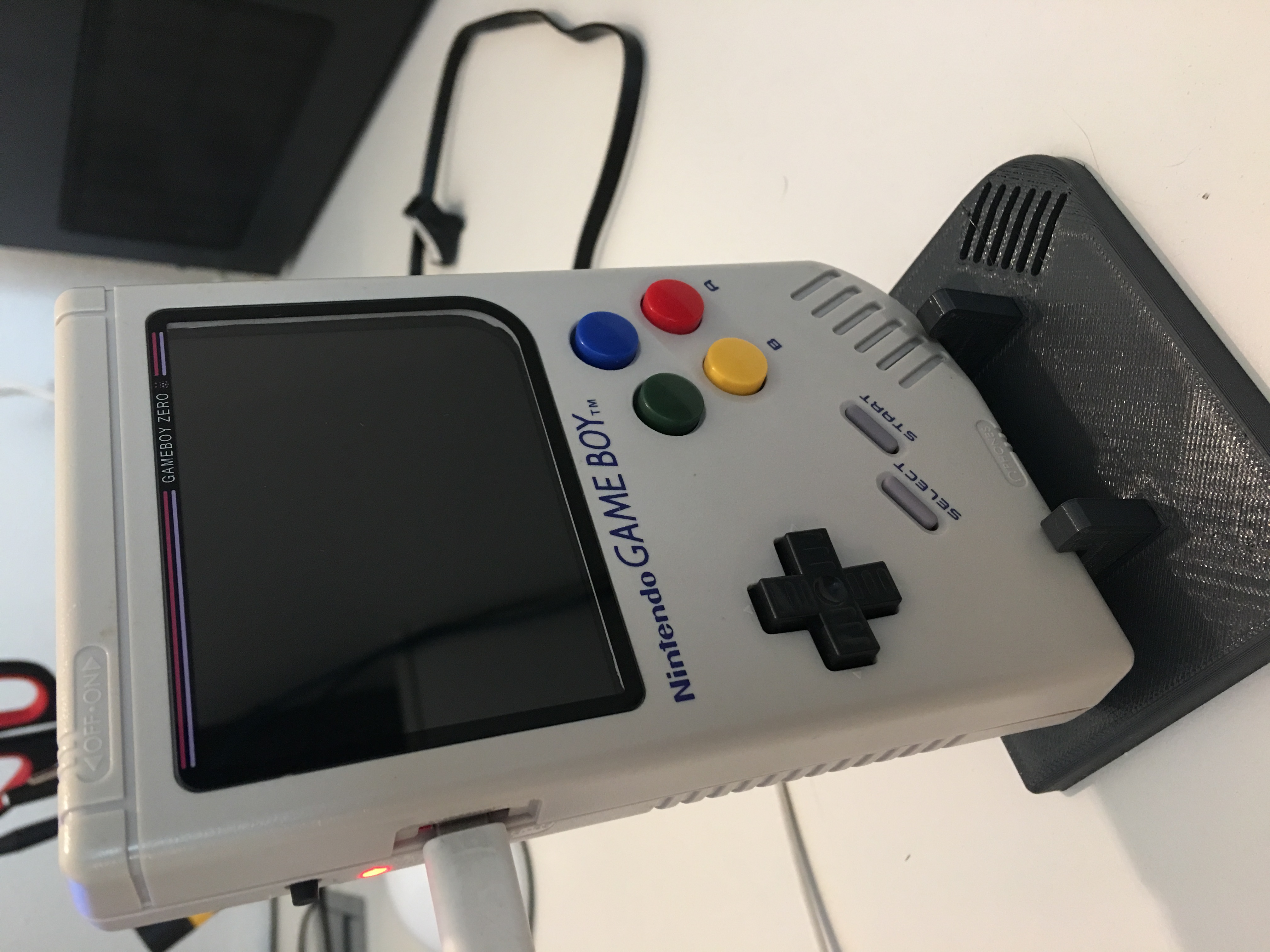

I´ve made an new GBZ with an 800x600 HDMI Display....

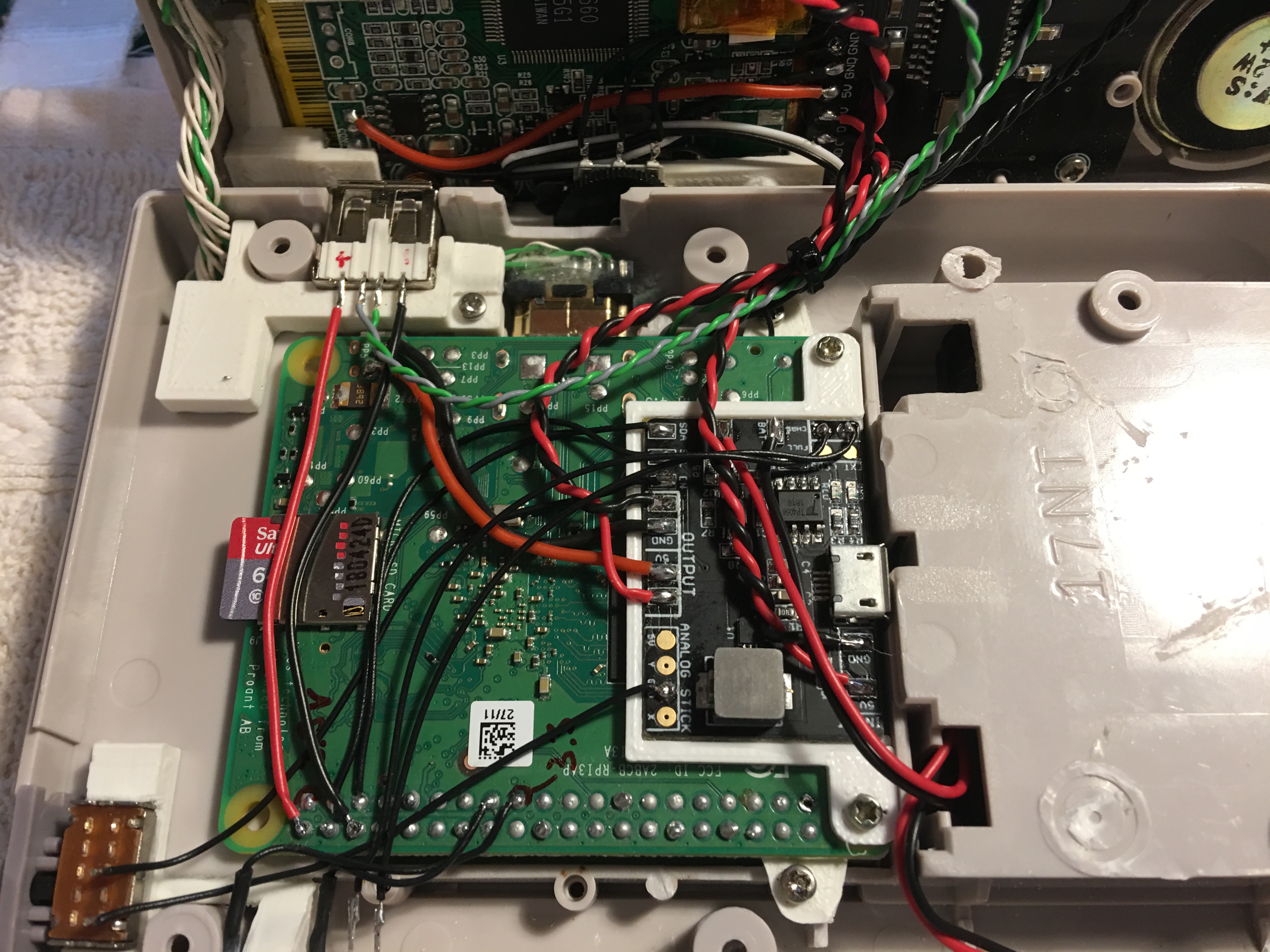

Powered by Helders Retro PSU and Tinkerboard 3.0.

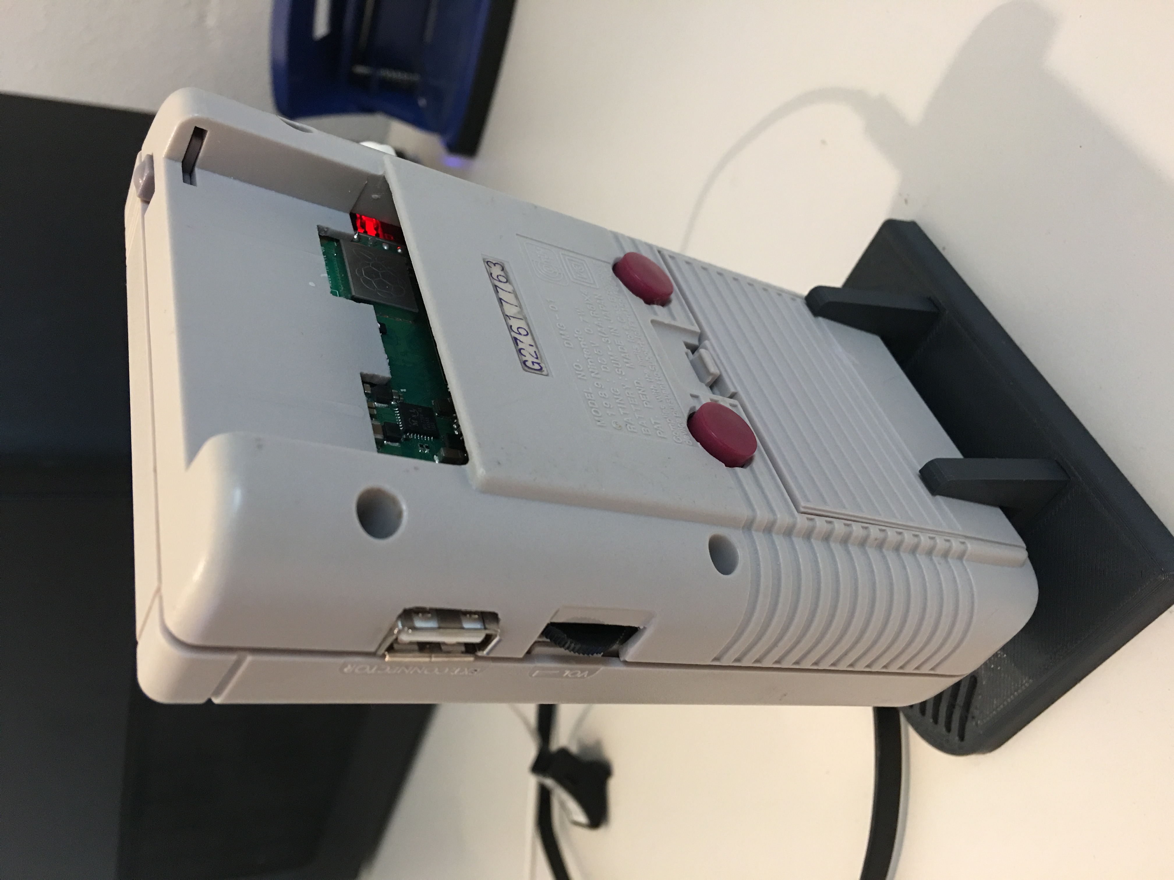

This time I used a original GB case from a broken unit.

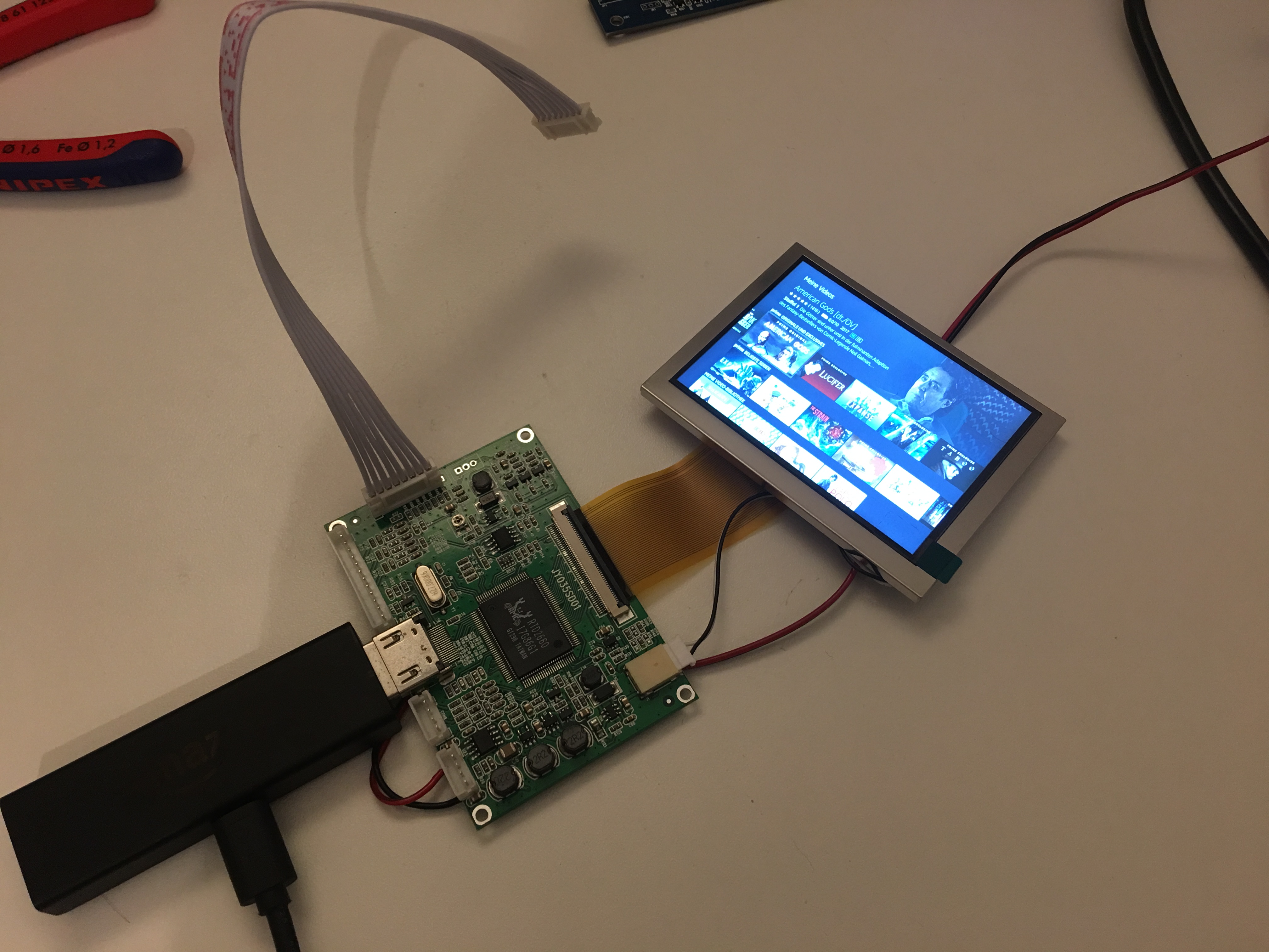

Display can be found here:
https://de.aliexpress.com/item/3-5-zoll ... 2d7bd9aa0d

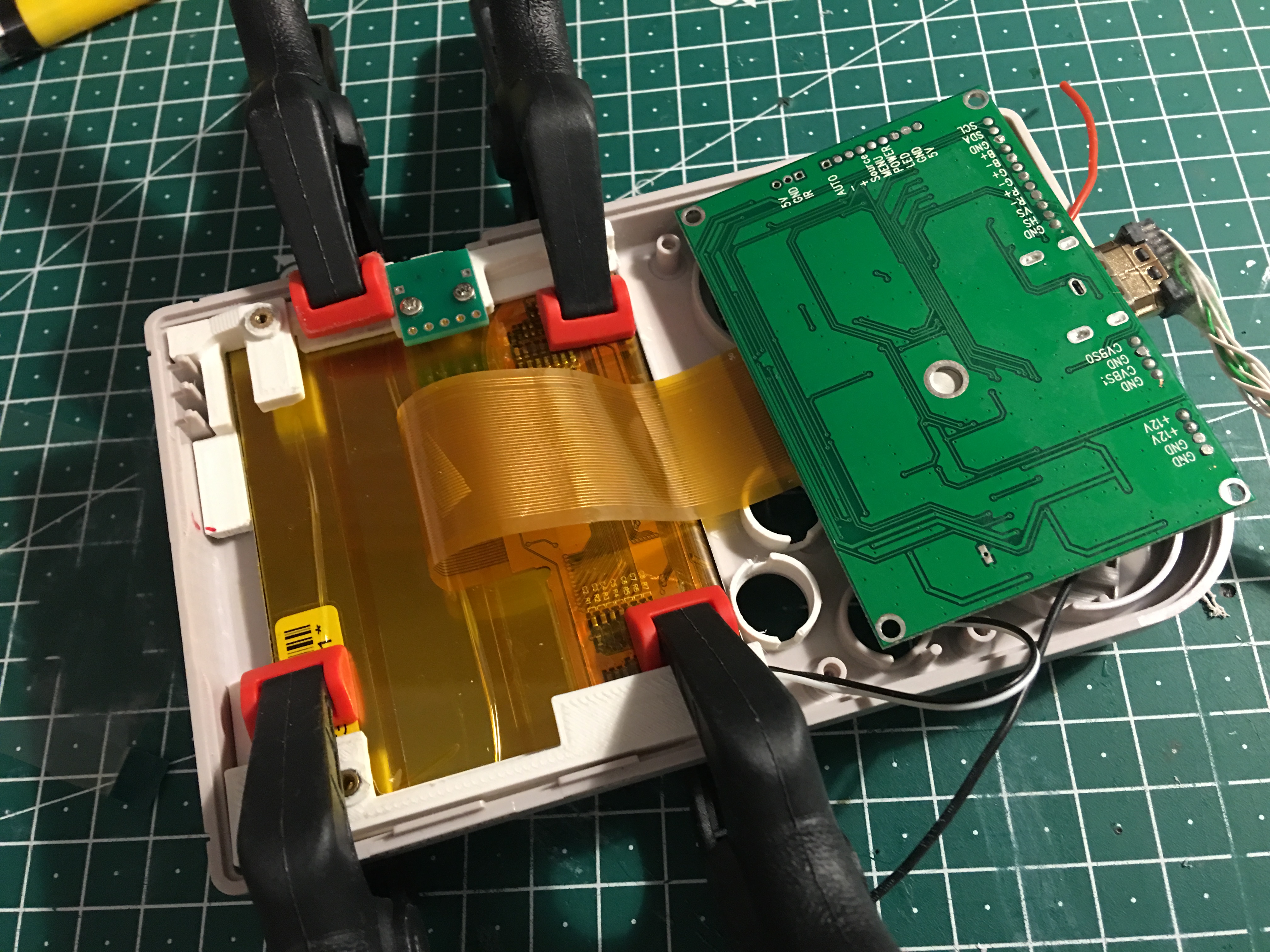

The rest ist a classic setup with an AIO Board by Tinkerboy. All Helpers are designed by myself.
The HDMI cable is also soldered by myself. The screen has to be setup for the first time to achive a permanent "HDMI In" function. I reduced the screen brightness to 35% because it´s to bright. :-)
Desoldering all the connections pins from the driverboard must be done. It runs OOTB by 5V, so no voltage tweak is needed.
Sound can be taken direct from the L+R analoge pins of the pi3a if you use a common ground button pcb and GPIO setup.

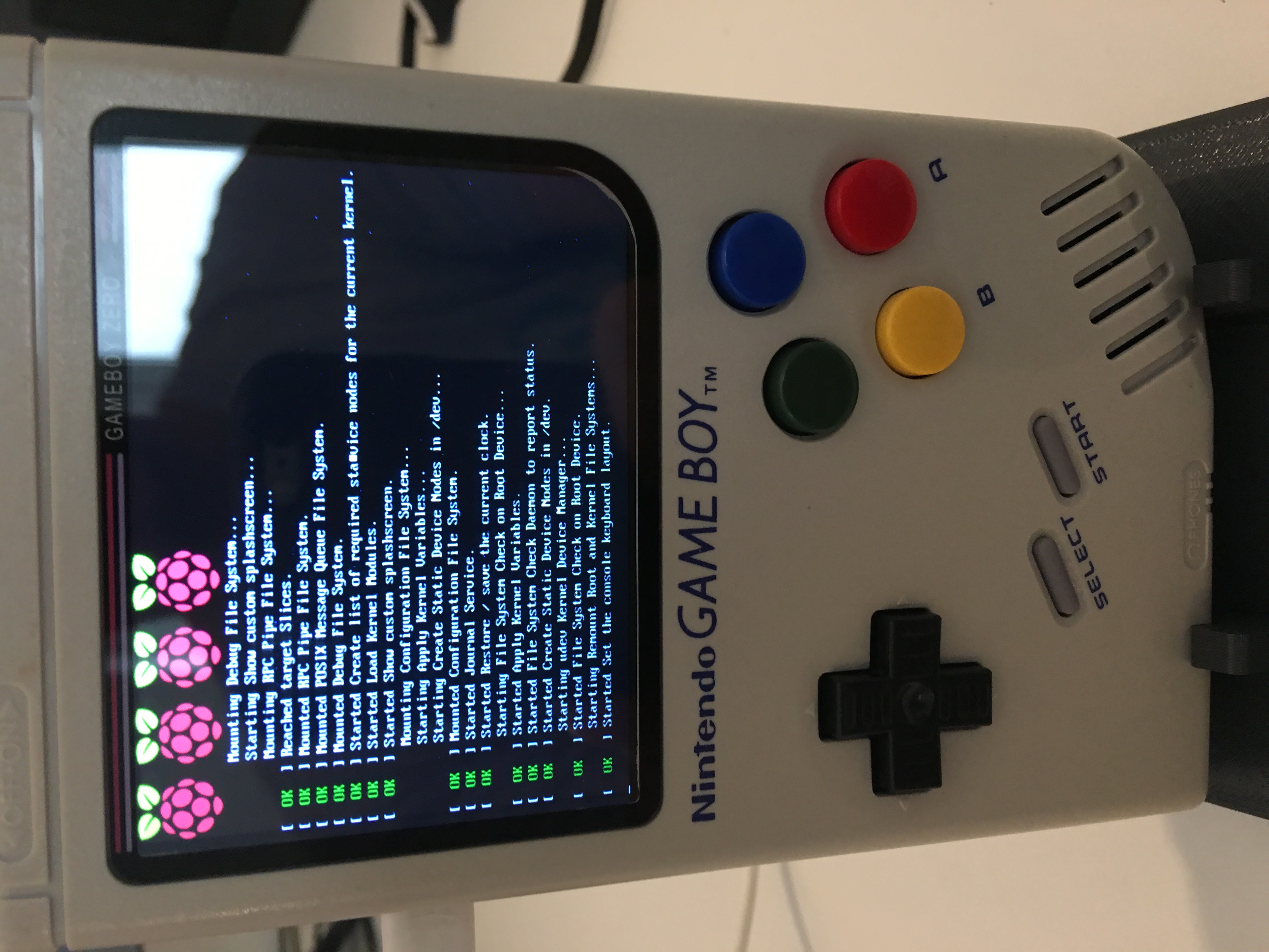

Hello Tinkerboy...
the Screen performance is amazing. Fully 60fps, no tearing and extreme brightness....
RxBrad
Posts: 278
Has thanked: 125 times
Been thanked: 160 times
Re: Gameboy Zero Pi3a - 800x600 Hdmi Screen
Post by RxBrad » Wed Jul 31, 2019 10:17 am
That screen seems extremely impressive for the price; and seems to be relatively low-effort to get working. I might need to do a 3A+ build of my own with one of these.
With some investigation, one would think it'd be possible to hack in some external brightness controls somehow. I've kind of spoiled myself being able to crank the brightness WAAAY down when I'm indoors, and WAAAY up when I'm outdoors.
Post by lightpixel » Fri Aug 02, 2019 8:25 am
power consumption is about 400-450 mah... Yes, it´s much. But with pi3a and a 4000 mah battery I got 2 1/2 h playtime.
The input control for the screen menu are simple common ground buttons...you need 4: Menu, +,-,back button.
Yes, you have to desolder all connectors from mainboard... but it´s much easier than desoldering a Pi3a. For this build I used a original GB case, no modifications on the case are needed. It fit perfect. With other third party cases you have to shave the case for 0,5 mm on left and right side.
