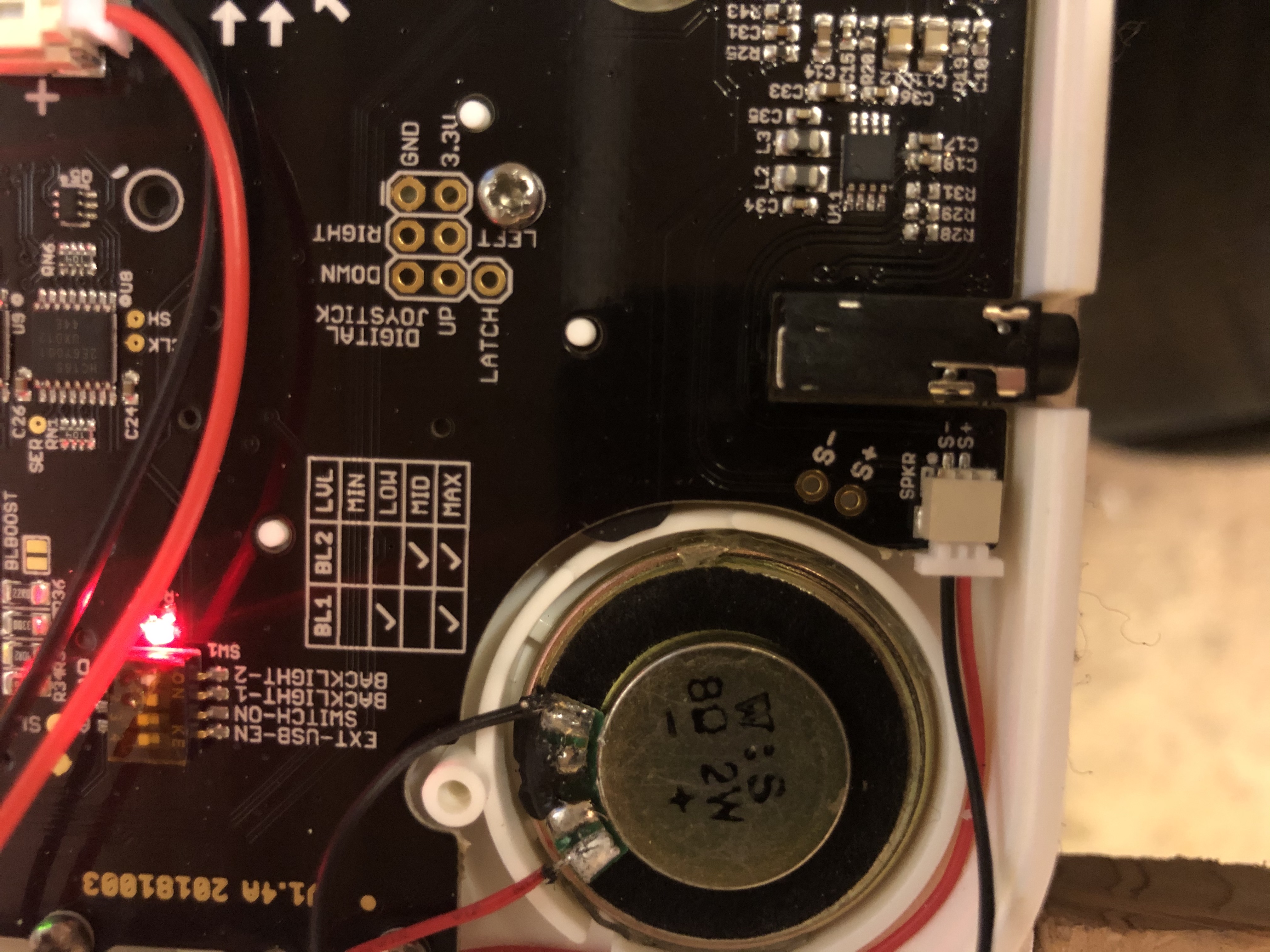

Hi, I have a circuit sword lite build that I’m not getting any sound from the speaker on. I’ve attached a photo in case anybody can see anything obvious.
Edit:
I hooked up the speaker from another lite I’ve built and know works - still no sound. I’m using the same Tetris rom on my working build and this one. I never use USB and the switch for USB is still off.

When run in tester mode, does the USB AUDIO test pass?
Ah no, it says 'fail' on usb audio :/

Check the USB wire soldering (the 3pin JST wire) and check for shorted between the soldered contacts, post pictures of that area if you'd like my feedback on it
You sir are a legend. A small strand of wire had bridged ground and live over the usb solders and was stuck to the inside of the kapton tape. Fresh tape and all is well!
